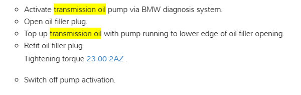

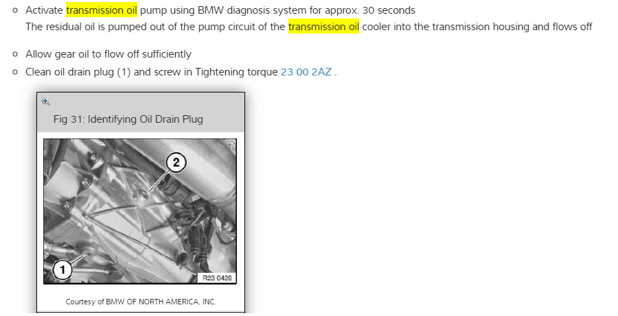

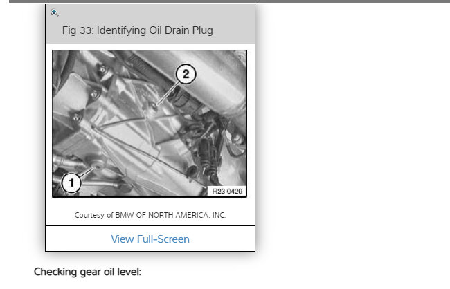

This vehicle requires a scan tool that can actuate the transmission oil pump. It isn't a traditional transmission service.

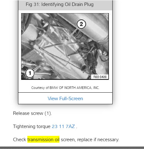

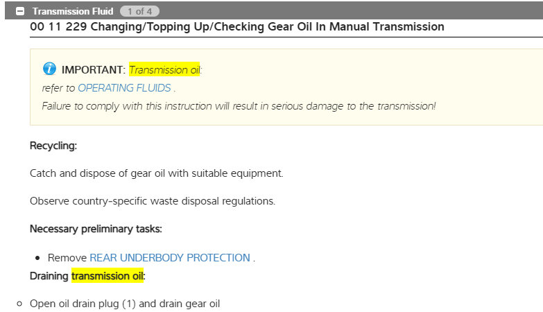

Regardless, I attached the directions below for the service. Take a look through it and let me know if you have questions or if I can help.

This is for manual transmission, i have an automatic.

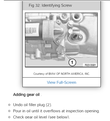

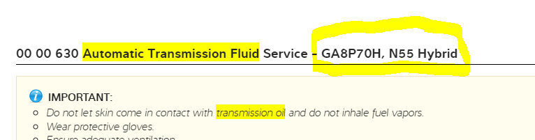

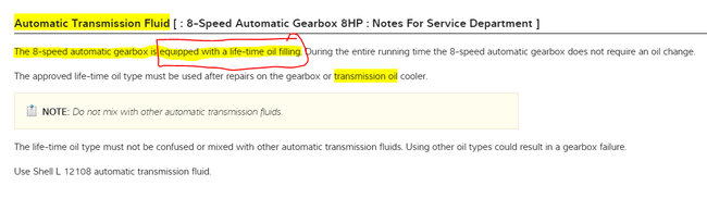

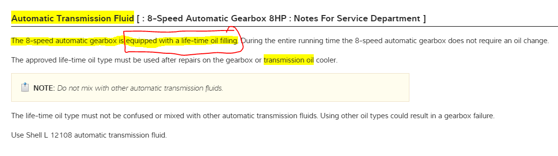

I am so sorry. Ugh!!! As far as the automatic, I have the steps if it is a hybrid vehicle. See pic 1. If it is an 8-speed automatic non-hybrid, they don't supply directions because the transmission fluid is supposed to be lifetime. See pic 2.
As far as a lifetime ATF, like anything else it gets dirty. The idea it will never need to be changed is a bit hard to believe. I have an Audi that says the same. At 100K, it looked like mud when I drained it to replace the filter and fluid.
On the other hand, if you have a hybrid, let me know that and I can get it for you.
Let me know if I can help in any way.

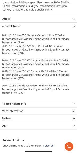

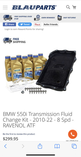

The first thing I suggest is to determine if there is a kit available for the trans. For example, are you able to get a filter and gasket? If it is, from that point I would feel the mechanical portion of the service would be straight forward.
I did a quick check and see filter kits, but they indicate an X drive. There should be one for a 2wd vehicle as well.

Yes, there are a bunch if these kits from reputable companies.
Apr 4, 2023 at 10:01 PM
  • 110,244 POSTS
Yep, that's what you need and evidence that it can be done. LOL That actually looks like a really good kit. I like the idea that they provide even the pump and pan bolts. It's a bit expensive, but based on what I read, it is correct.

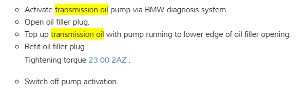

Just remember when you top it off, I believe the transmission should be between 35C and 45C. If you get it to 100 degrees F, you should be fine.
