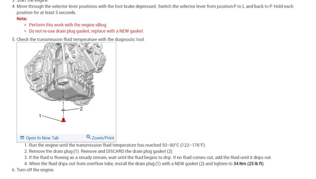

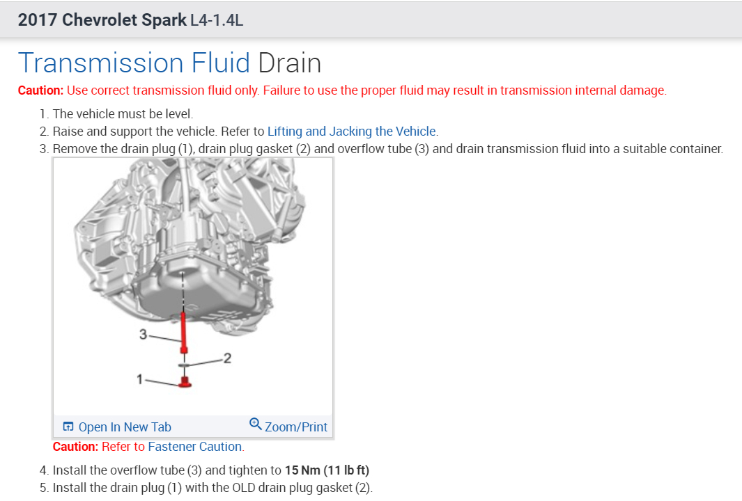

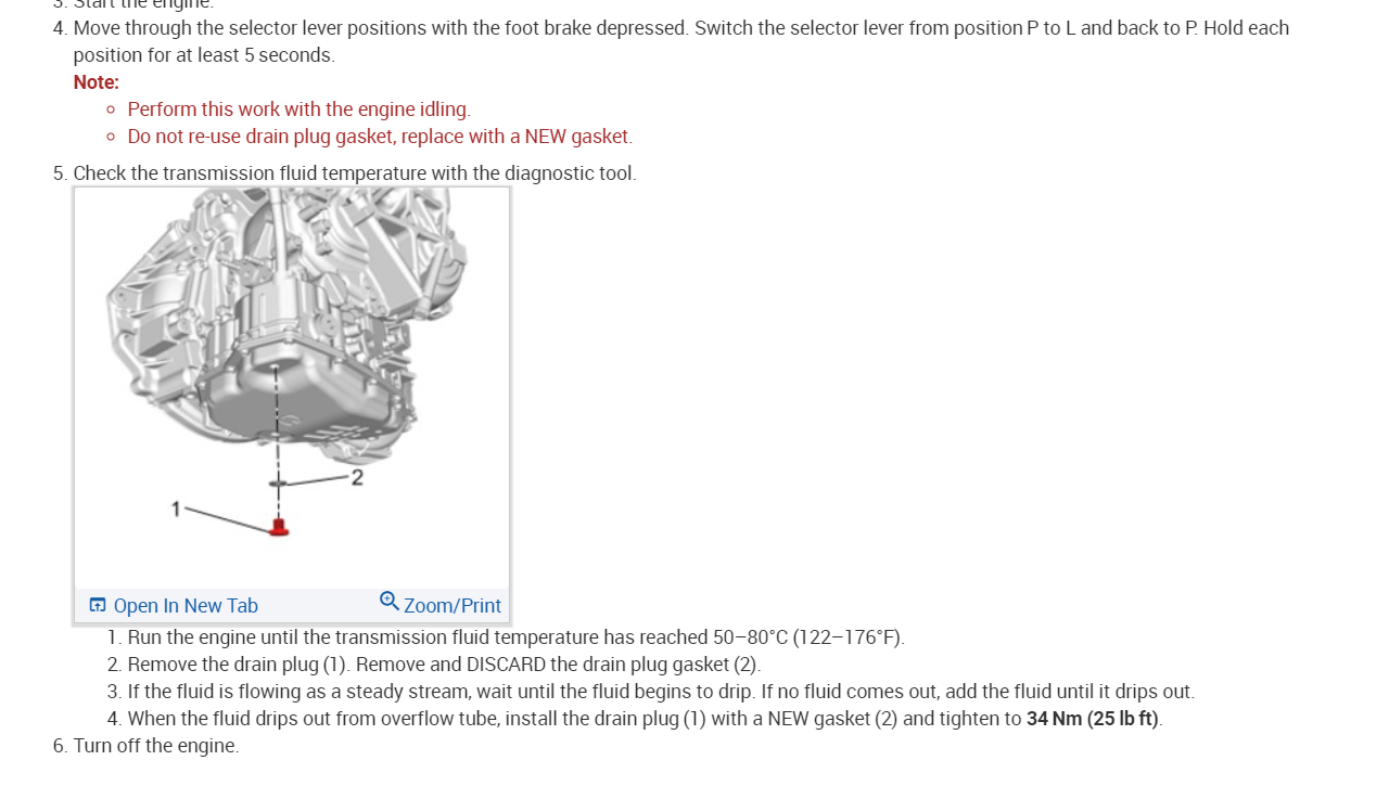

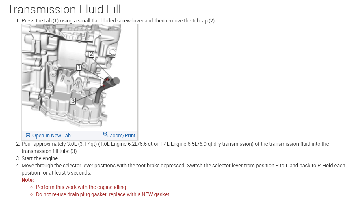

Where is the fill bolt on these?
Jan 12, 2023 at 10:25 PM
  • 55,412 POSTS
These are drained through the bottom plug and then it runs out and when it stops it is ready to be refilled. Please check out this guide to help you understand what to do with the images below:
https://www.2carpros.com/articles/how-to-check-and-add-transmission-fluid
Transmission - Automatic
ACDelco CVT Fluid (Part No. 19260800, in Canada 19299096).
You must use this fluid, or the transmission will not work correctly.
Check out the images (below). Please let us know if you need anything else to get the problem fixed.
