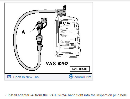

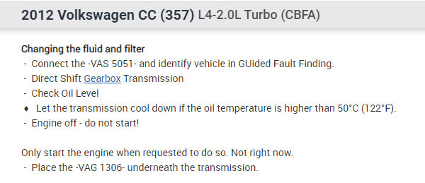

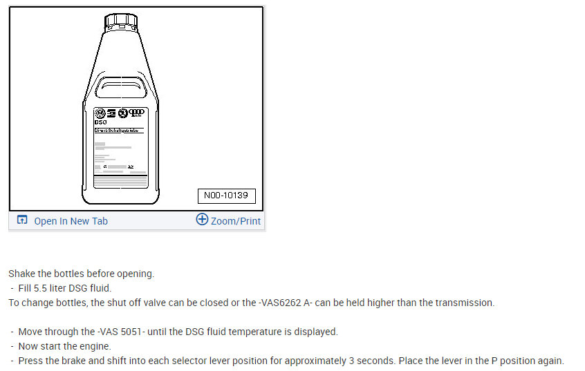

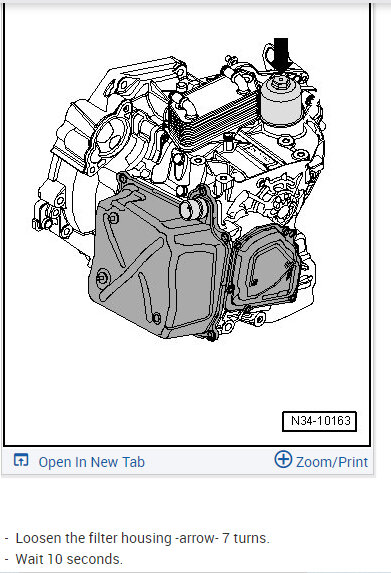

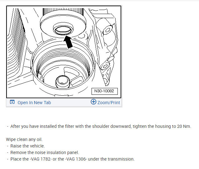

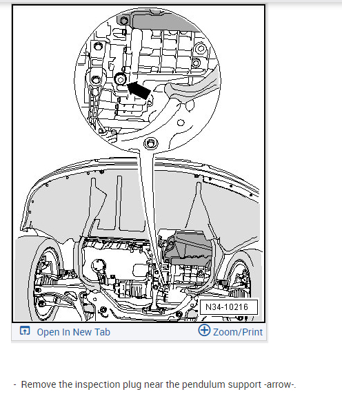

This one has the DSG transmission so there is no horizontal pan that i can drain but rather a plug in the transmission. There is a pan that is vertical but i doubt i need to remove that to refill. Can you share instructions on how to fill once drained? This os the r-line trim.
Jan 5, 2024 at 10:40 PM
  • 110,244 POSTS
Based on the production date, this could have one plug only, or it may have two plugs. I assume it is one plug.

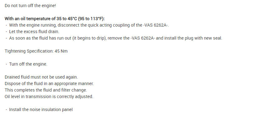

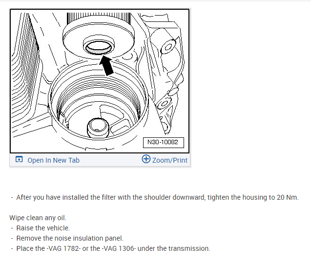

I attached the directions for servicing the fluid and filter below. Take a look through them and let me know if you have questions.
