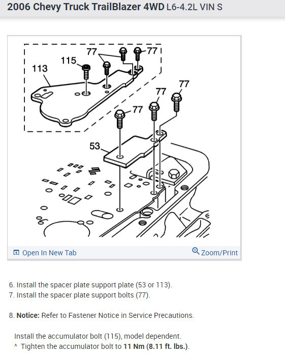

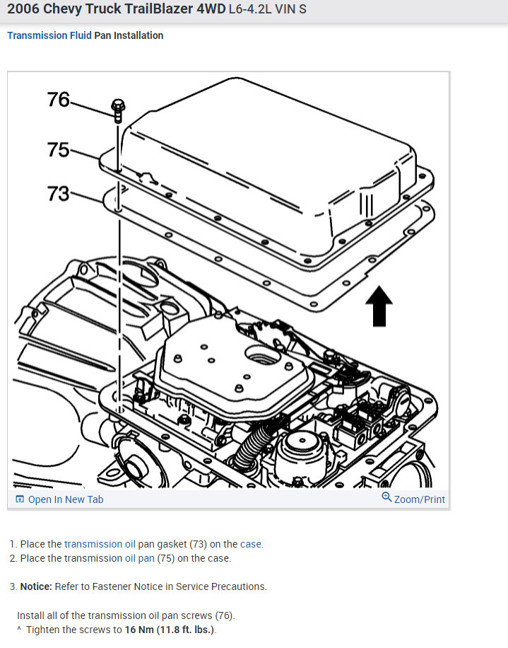

Question 2. I need ("the exact torque") for the 3 accumulator bolts and all of the oil pan bolts (in ft pounds please) my wrench starts at 10 lbs standard...
Question 3. The pan and all the mating surfaces are nearly pristine, and the pan and gasket came right off with almost zero scraping. I'm generally opposed to using sealant glues if it's not absolutely necessary. I wonder if I should use some or not.

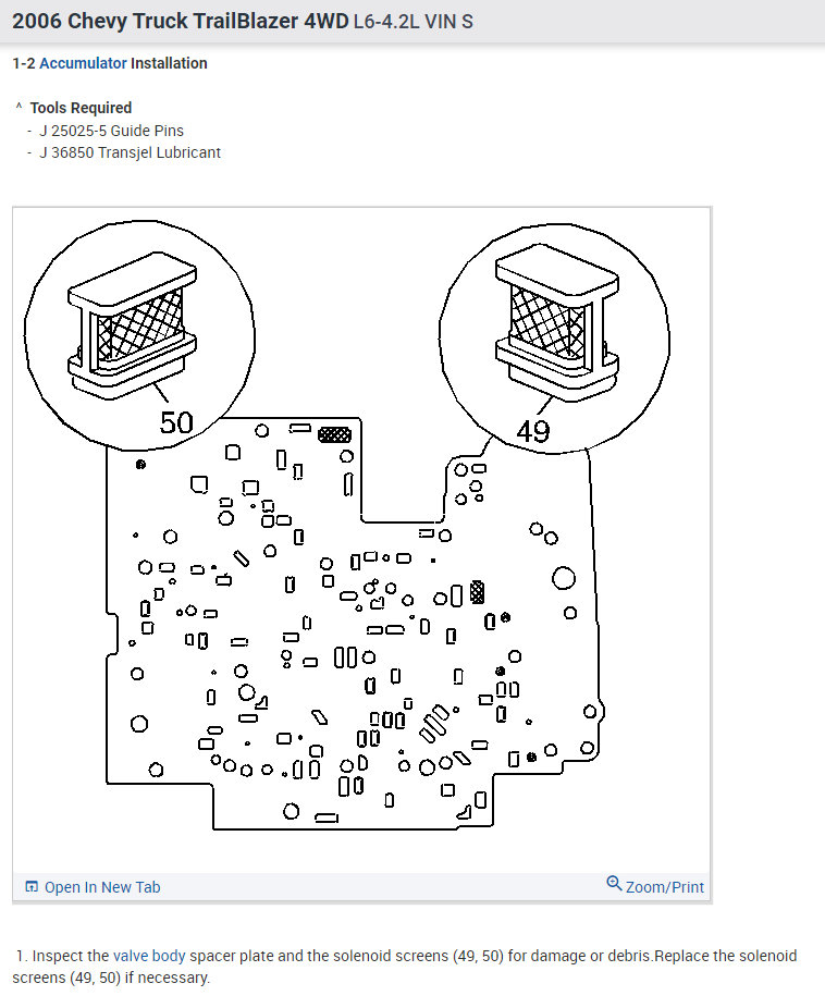

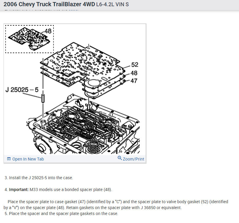

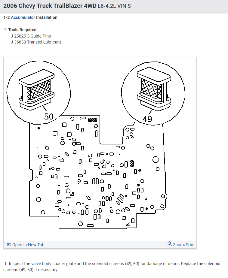

If you use a heat gun on the old seal, just be care full not to allow the metal to overheat. It should make the seal easier to remove (it will likely deform it).
The transmission pan bolt torque: 11.8 ft. lbs (16Nm)

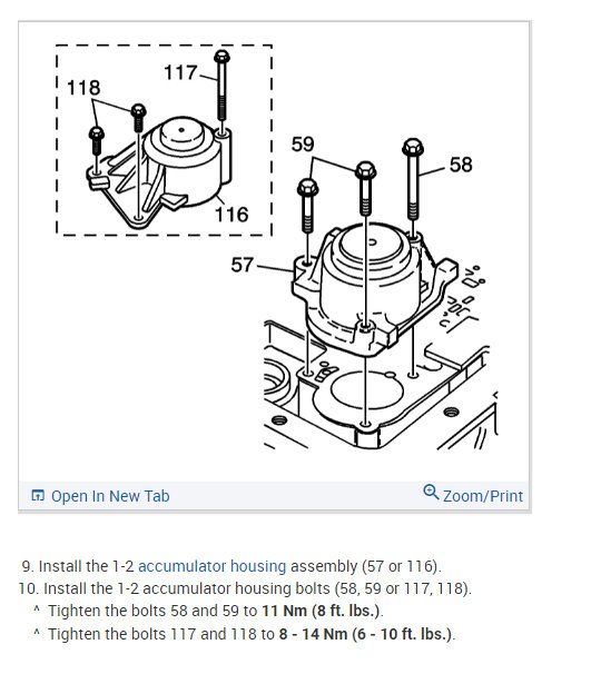

The accumulator bolt torque: 8.11 ft. lbs (11Nm)
It is a good idea to use sealant on the replacement gasket. The metal on the pan or the mating surface on the transmission housing can have deformities that are not visible. If you use a sealant then you won't have to worry about that.

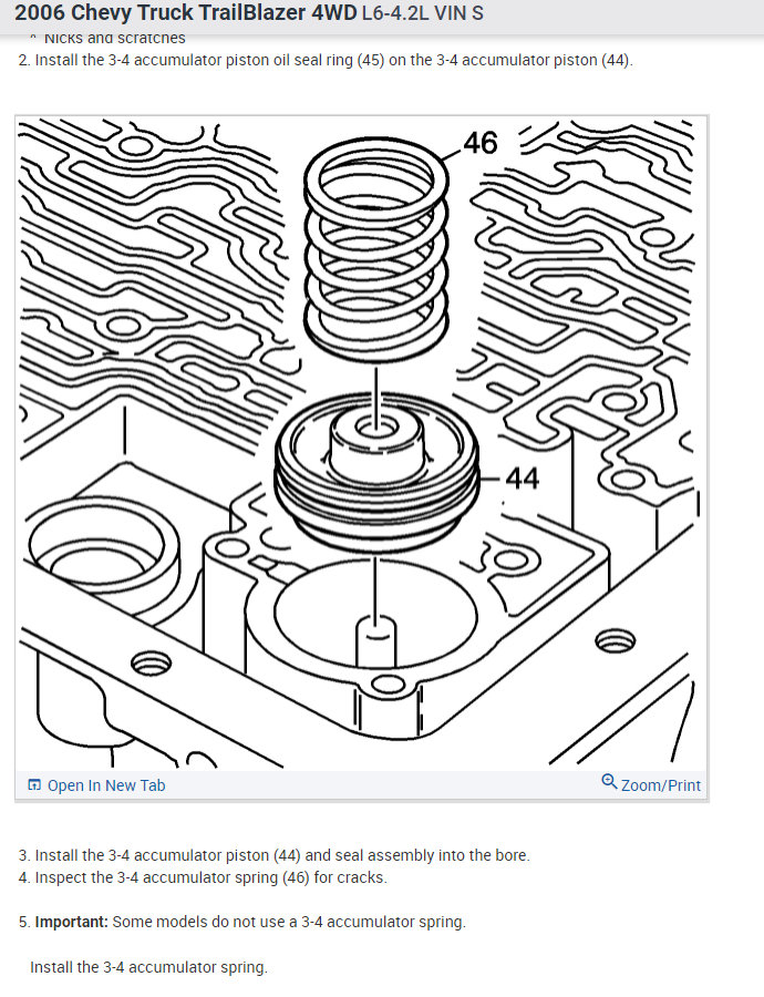

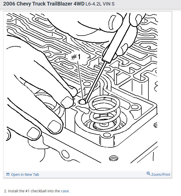

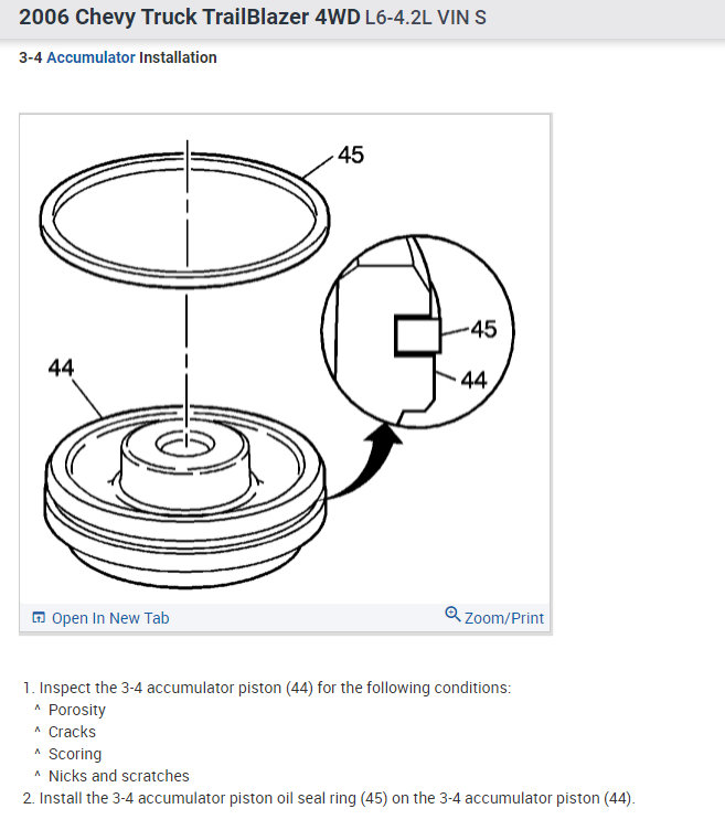

I have attached the diagrams for your reference.
Please let me know of you need any other information.

I am having an issue with getting an inexpensive volunteer to finish the solenoid replacement. I looked at the accumulator and only see two bolts holding it in, but my replacement part has THREE bolt holes.
I managed to get the pan and filter removed and now is where I need help because of that accumulator and replacing all the solenoids with my 66-year-old crippled back and hands.
