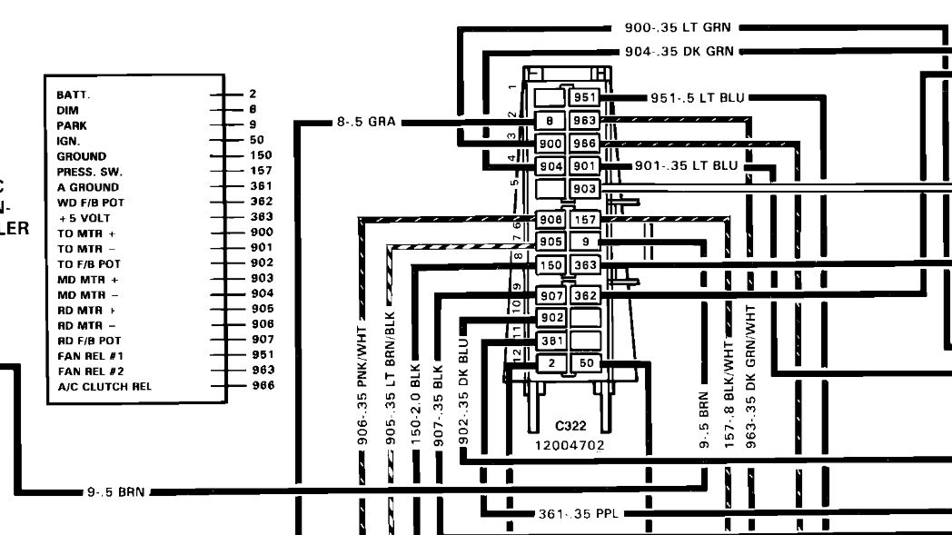

I have had to change the climate control panel in my truck. The previous owner played with it before and messed up all the wires that plug into the blower speed switch. I need help figuring out what wire goes where to get it to work properly.

I attached a wiring diagram for you to view. It shows the connector as well as the connector with all the wire colors.

I have a non digital climate control panel. Sorry I forgot to mention that.
Sep 24, 2018 at 8:39 AM
That was the only one listed.
