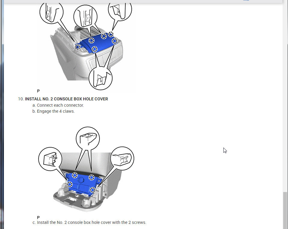

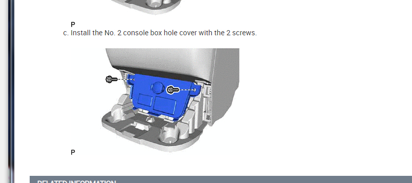

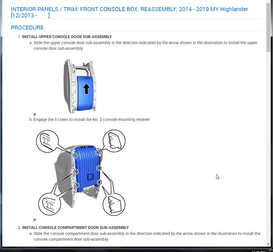

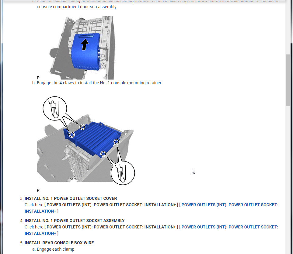

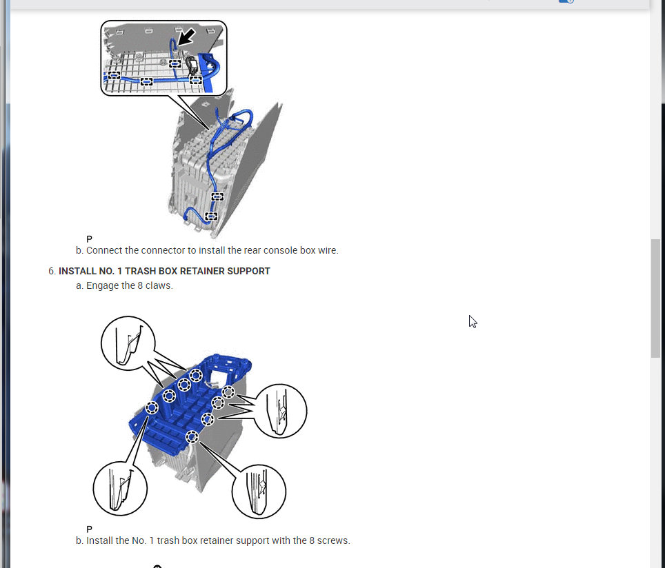

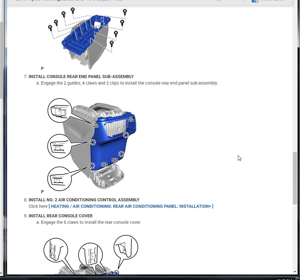

I am attaching the entire process below on this console. Please review this material and let us know if there are questions. Check out the diagrams (below). Please let us know if you need anything else to get the problem fixed.
Thanks
