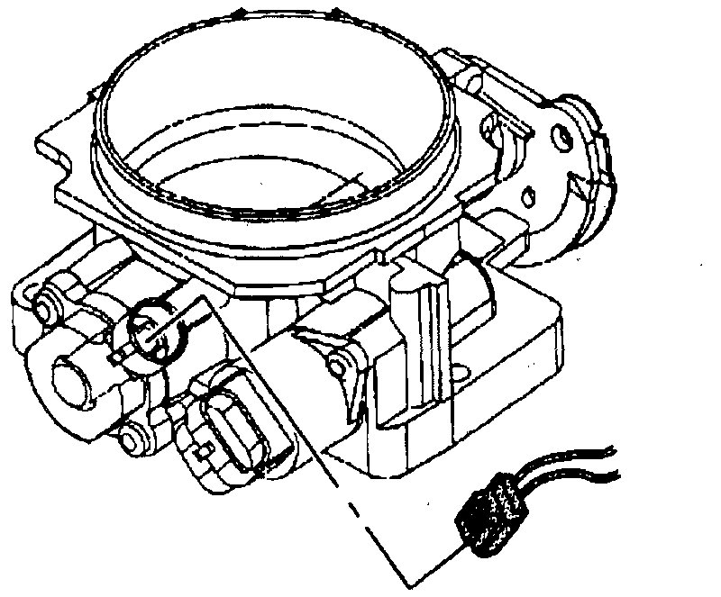

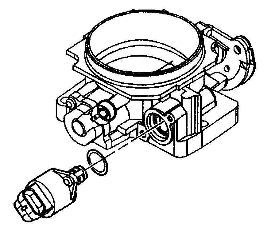

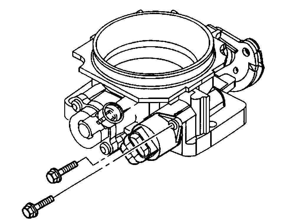

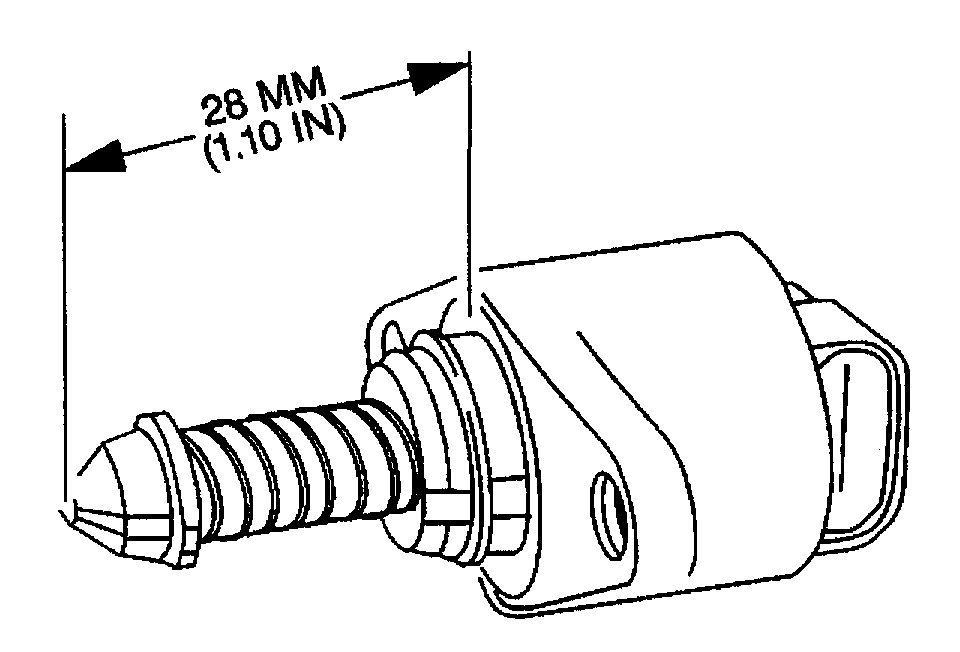

Do me a favor. Here are the directions for the IAC replacement. Take a look through them. At the end, it explains what to do for the relearn. The attached pics correlate with the directions.

IDLE AIR CONTROL (IAC) VALVE REPLACEMENT
Throttle Position Sensor Electrical Connector
pic 1
pic 2
pic 3
pic 4
REMOVAL PROCEDURE
1. Remove the electrical connector from the Idle Air Control (IAC) valve
2. Remove the IAC valve attaching screws.
CAUTION: If the IAC valve has been in service: DO NOT push or pull on the IAC valve pintle. The force required to move the pintle may damage the threads on the worm drive. Also, DO NOT soak the IAC valve in any liquid cleaner or solvent, as damage may result.
3. Remove the IAC valve assembly.
4. Remove the O-ring.

3. Measure the distance A between tip of IAC valve pintle and mounting flange. If greater than 28 mm, use finger pressure in order to slowly retract the pintle. The force required to retract the pintle of a new valve will not cause damage to the valve.
MEASUREMENT PROCEDURE
NOTE: If installing a new IAC valve, replace with an identical part. The AC valve pintle shape and diameter are designed for the specific application.
INSTALLATION PROCEDURE
2. Lubricate the IAC valve O-ring with clean engine oil.
2. Install the IAC valve assembly.
3. Install the attaching screws.
Tighten
^ Tighten the IAC valve attaching screws to 3.0 Nm (26 lb. in.).
4. Install the electrical connector.
