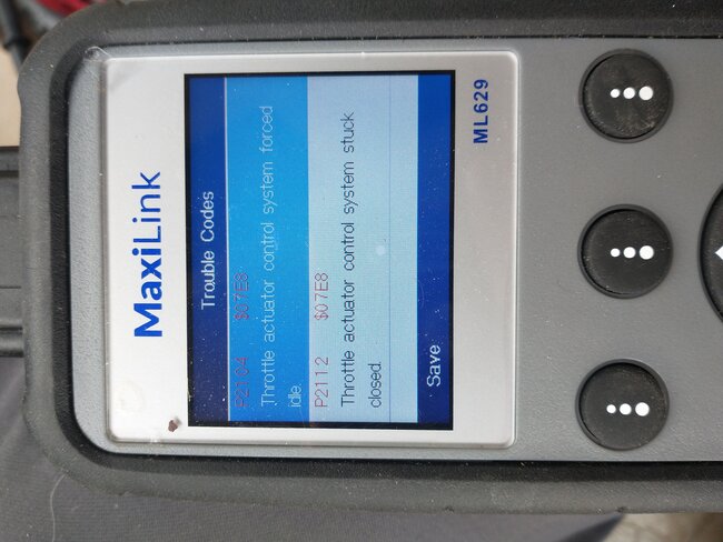

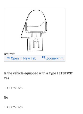

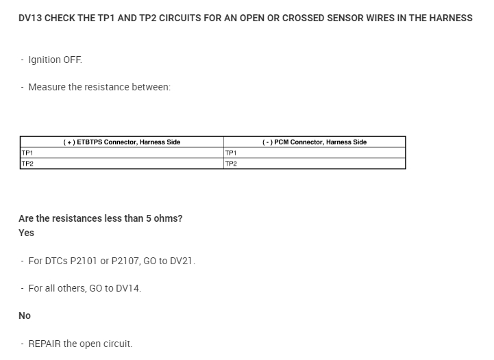

Can you help me with these codes?
P2104
P2112
See image!
Thanks!

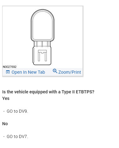

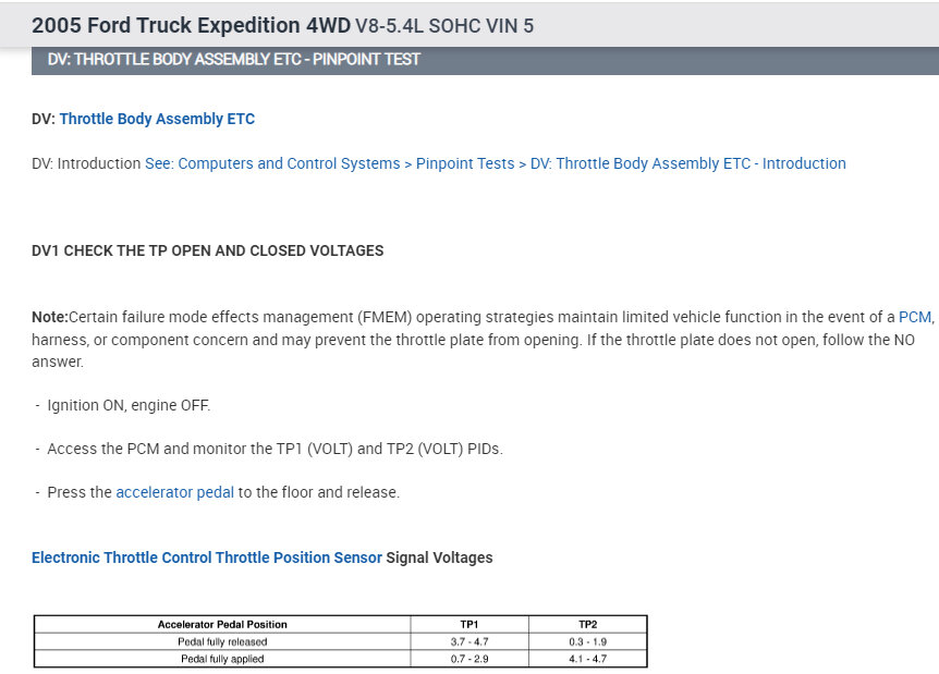

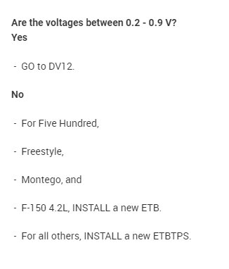

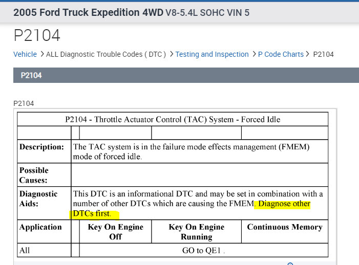

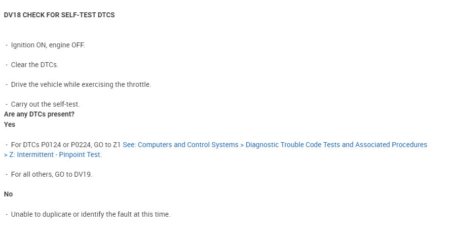

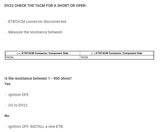

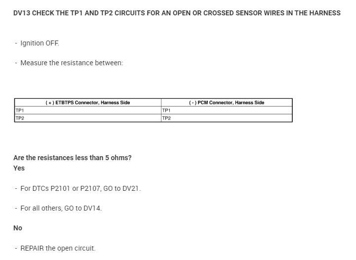

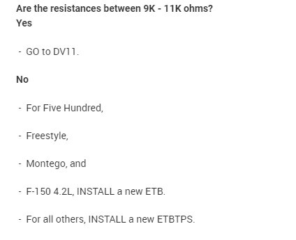

Code P2104 is an informational code indicating a forced idle. When this code shows up, the manual indicates to diagnose other codes before focusing on it. See pic 1 below.

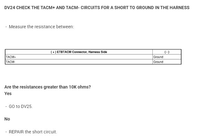

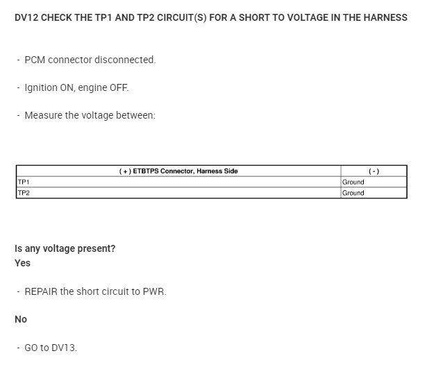

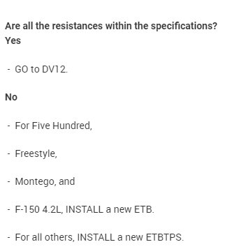

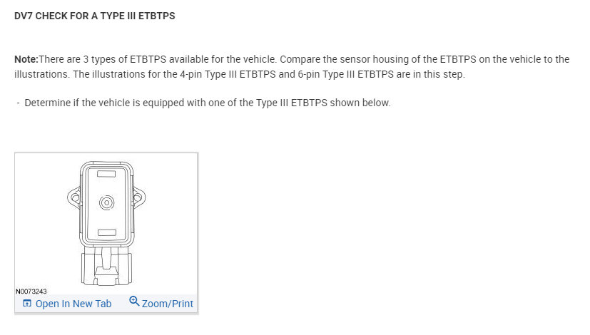

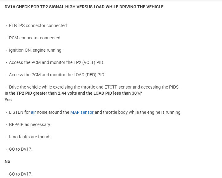

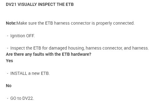

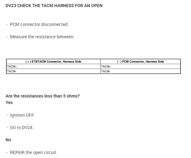

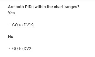

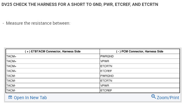

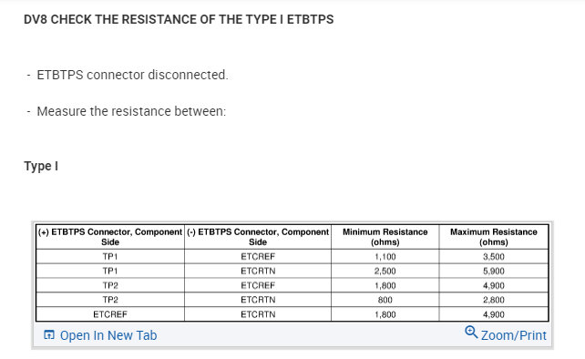

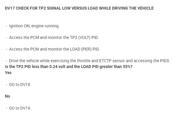

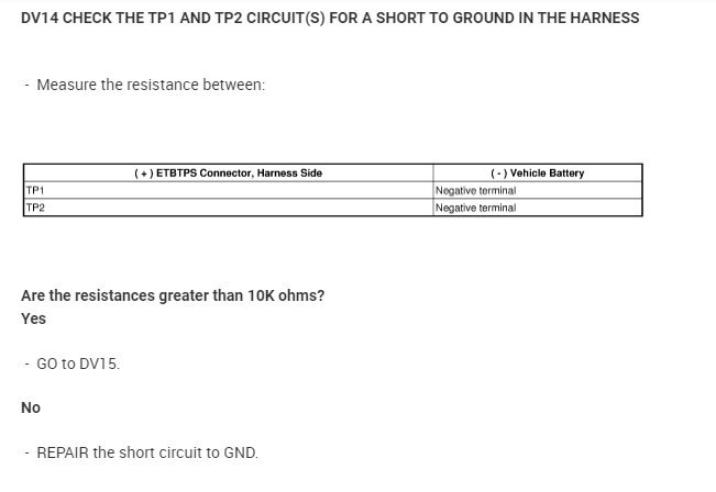

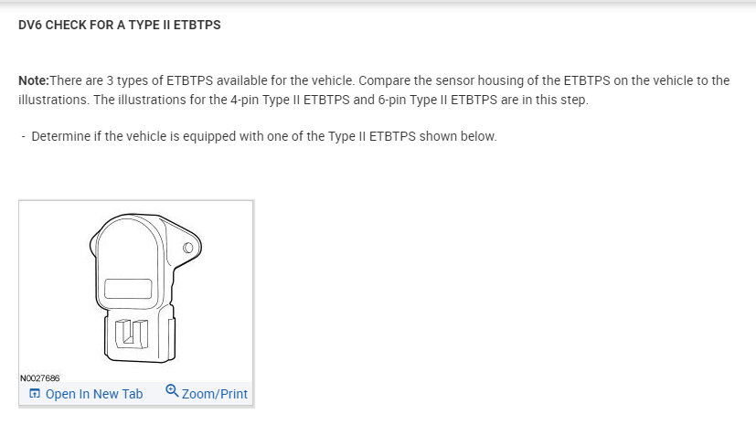

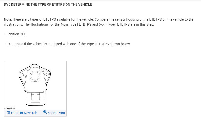

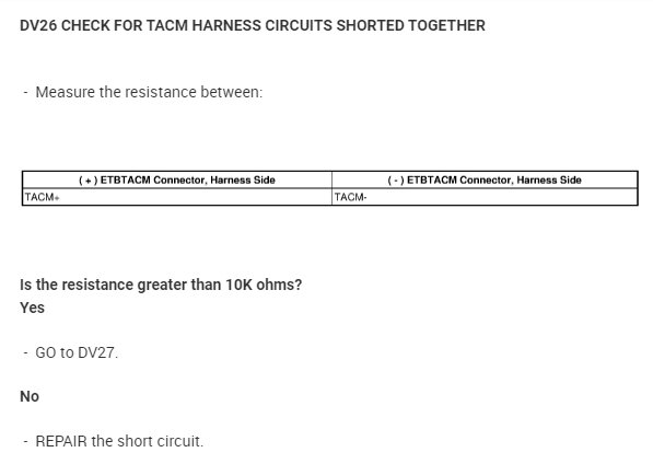

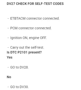

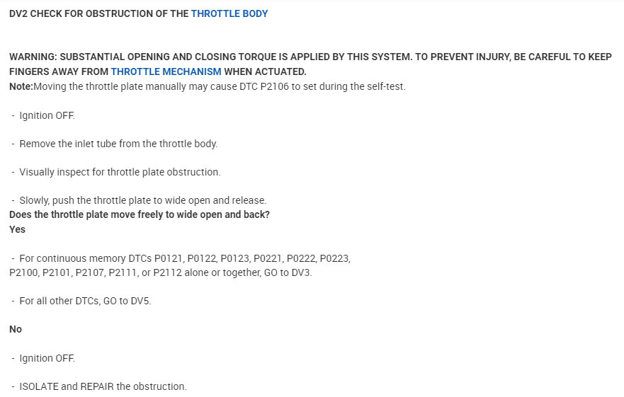

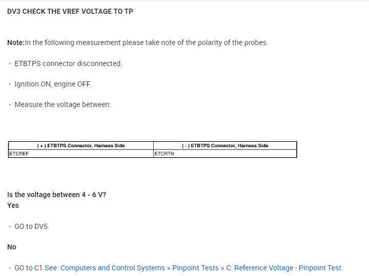

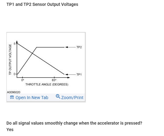

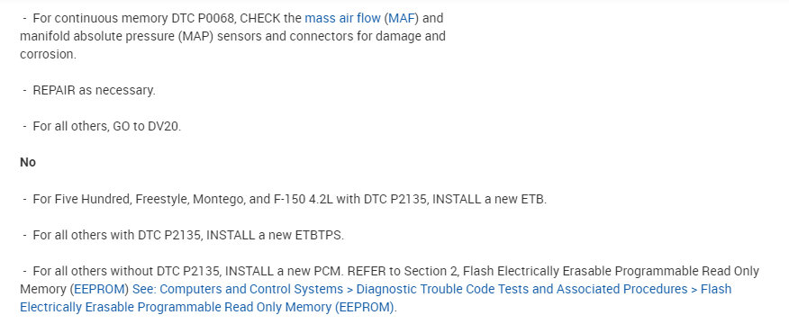

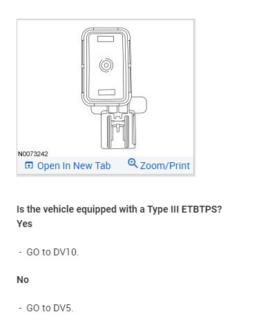

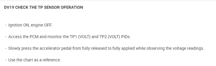

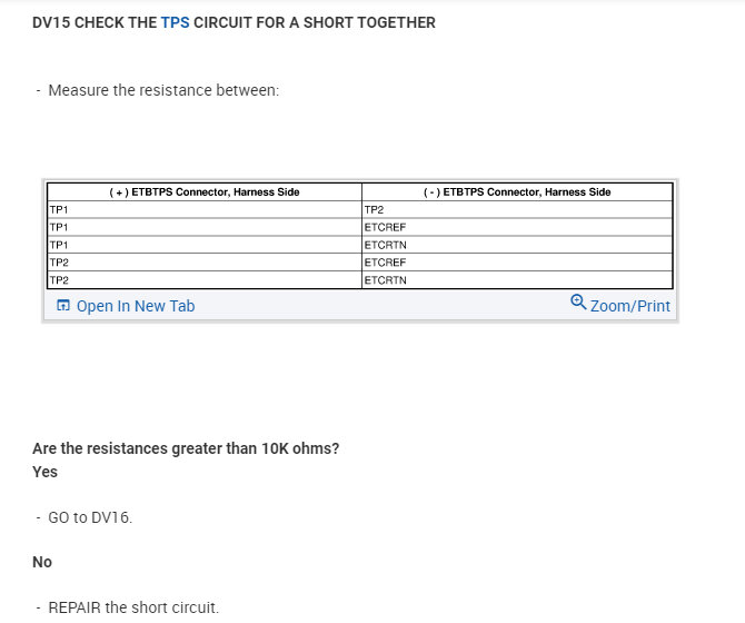

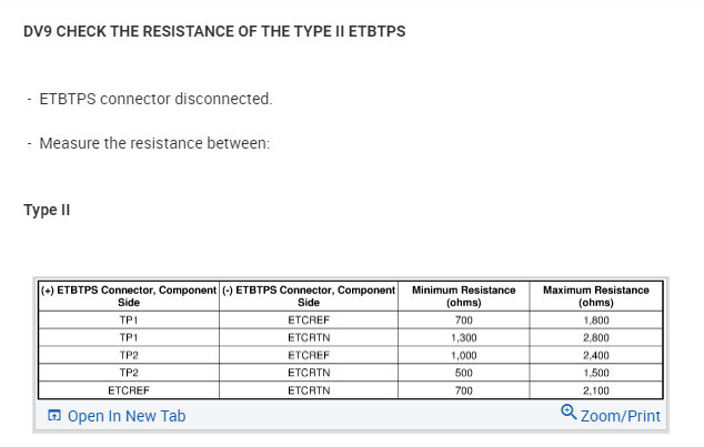

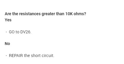

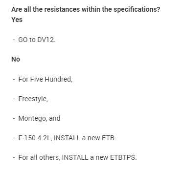

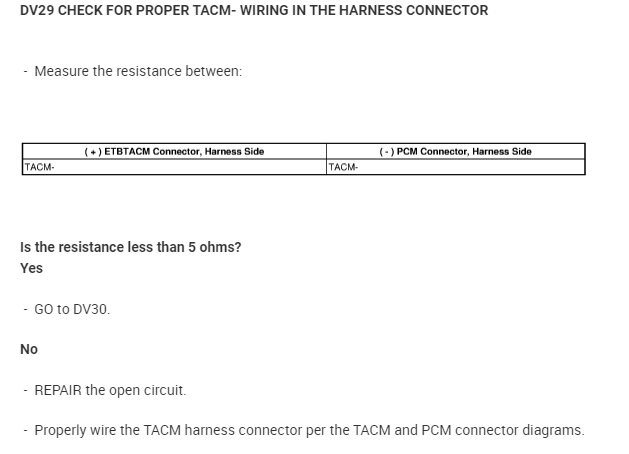

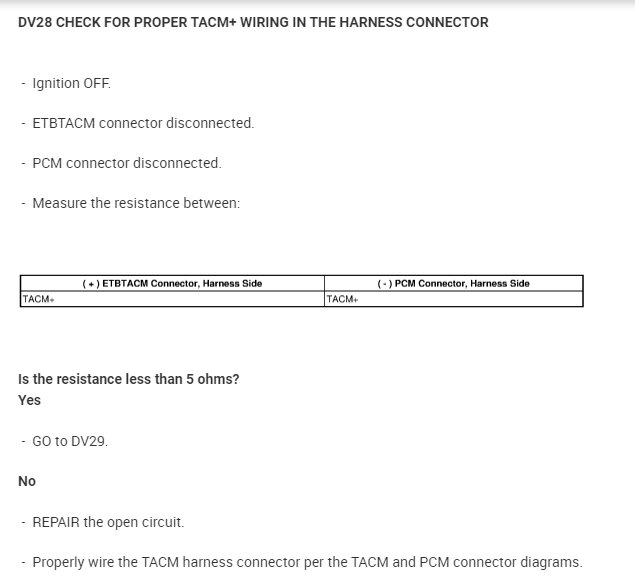

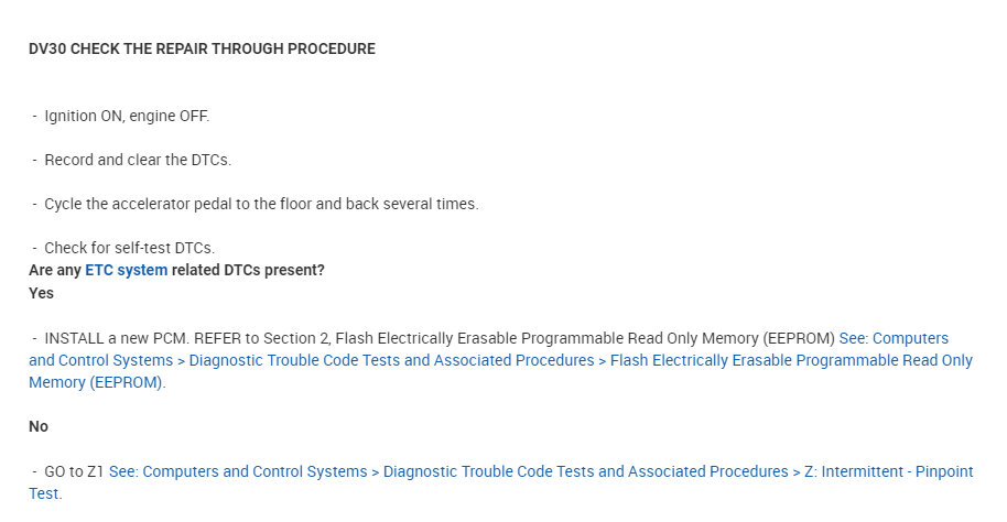

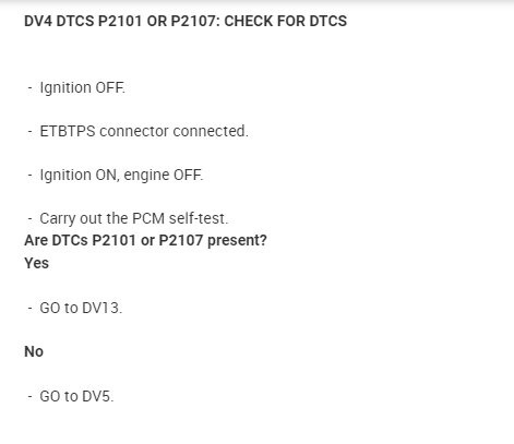

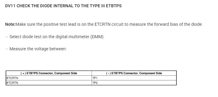

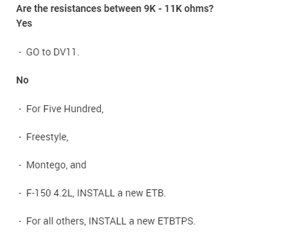

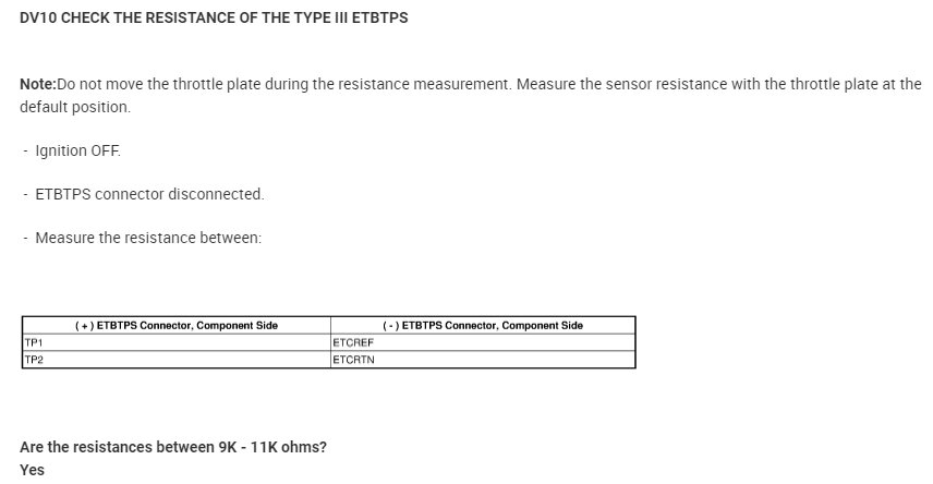

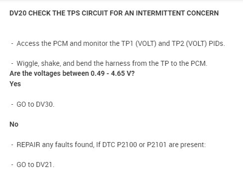

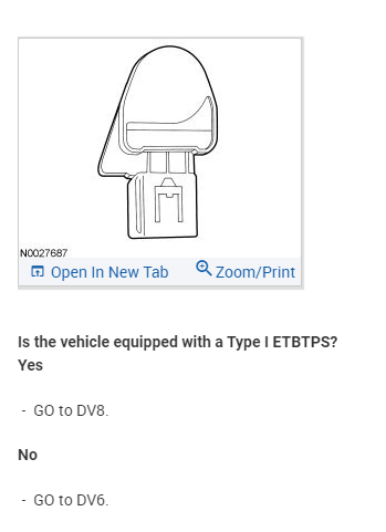

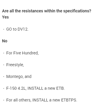

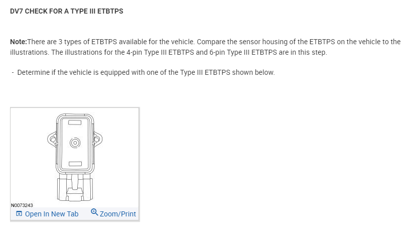

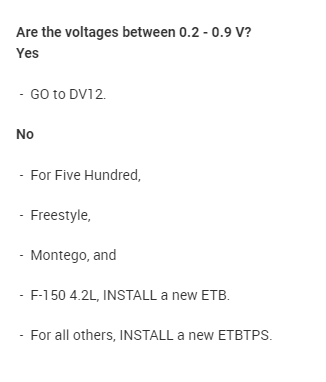

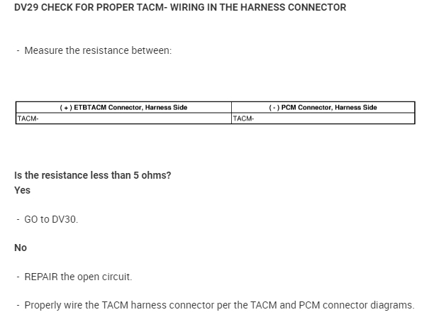

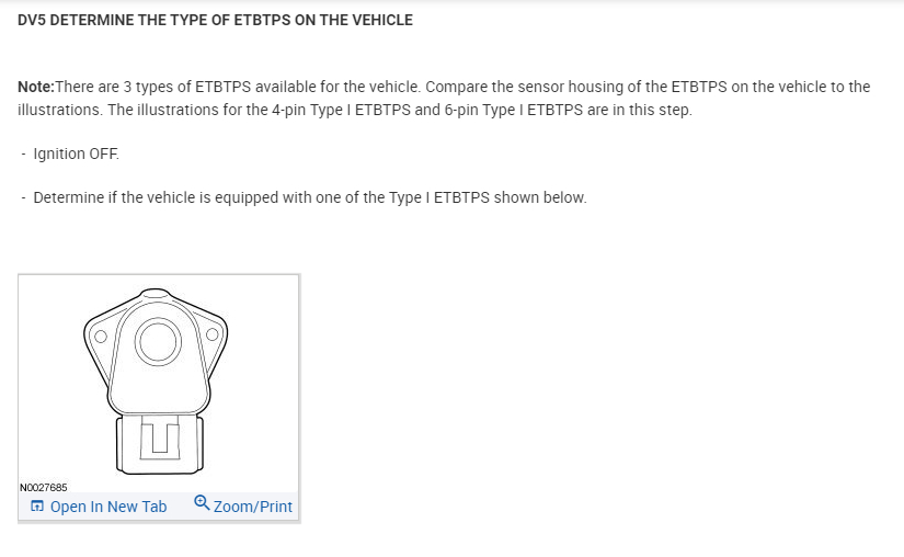

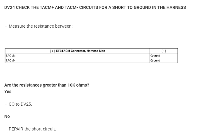

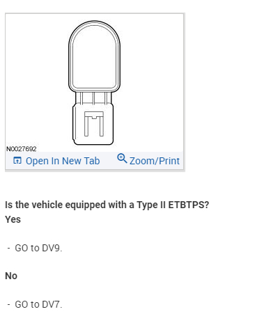

Coder P2112 indicates the throttle plate is at an angle further than commanded by the PCM. This leads me to a list of diagnostics specific to the P2112 which I have attached below.
The diagnostics include 30 tests, so they are somewhat extensive. However, you may find the issue within the first few tests.
Jan 24, 2023 at 7:34 AM
