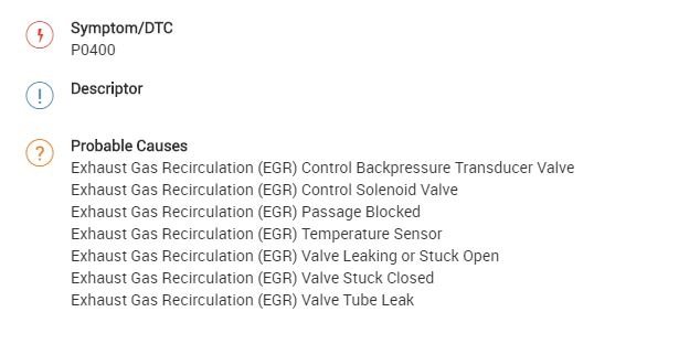

Yesterday my check engine light popped on with codes P0400 and P0171. I know P0400 is something to do with the EGR system but can't figure out if these could both be caused by the same thing. Both codes came at the same time. What are my most likely culprits that I should check first? Thanks in advance for any help.
Feb 3, 2020 at 7:37 PM
Good morning,
The 400 code is EGR related. The system needs to be checked to verify the failure. I posted the possibilities for you to view.

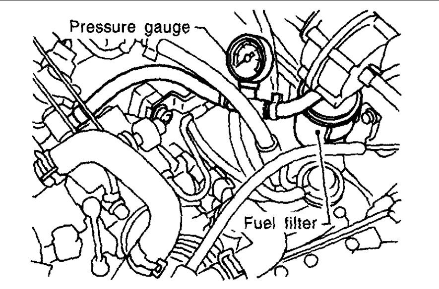

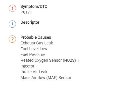

The 171 is for lean running. I would check and make sure there are no vacuum leaks. Beyond that, I would check the fuel pressure.
https://www.2carpros.com/articles/repair-lean-mixture-codes-p0171-or-p0174-on-some-manufacturers
NOTE:
When reconnecting fuel line, always use new clamps.
Make sure that clamp screw does not contact adjacent parts.
Use a torque driver to tighten clamps.
Use Pressure Gauge to check fuel pressure.
Do not perform fuel pressure check with system operating.
Fuel pressure gauge may indicate false readings.
1. Release fuel pressure to zero.
2. Disconnect fuel hose between fuel filter and fuel tube (engine side).
3. Install pressure gauge between fuel filter and fuel tube.
4. Start engine and check for fuel leakage.
5. Read the indication of fuel pressure gauge.
At idling:
With vacuum hose connected
Approximately 235 kPa (34 psi)
With vacuum hose disconnected
Approximately 294 kPa (43 psi)

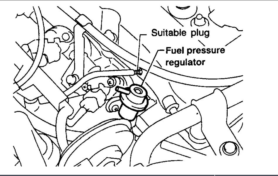

If results are unsatisfactory, perform Fuel Pressure Regulator Check.

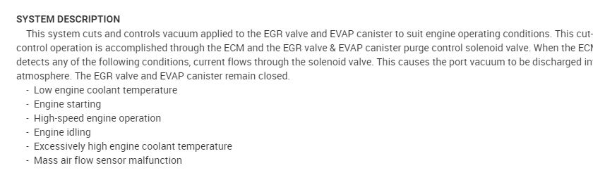

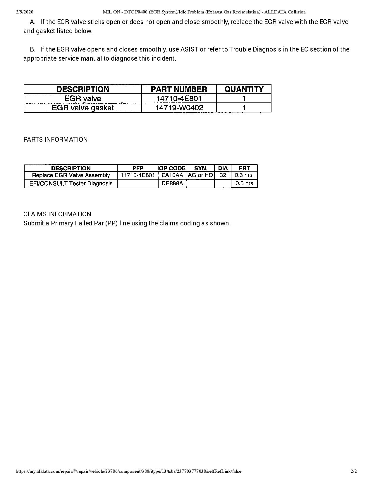

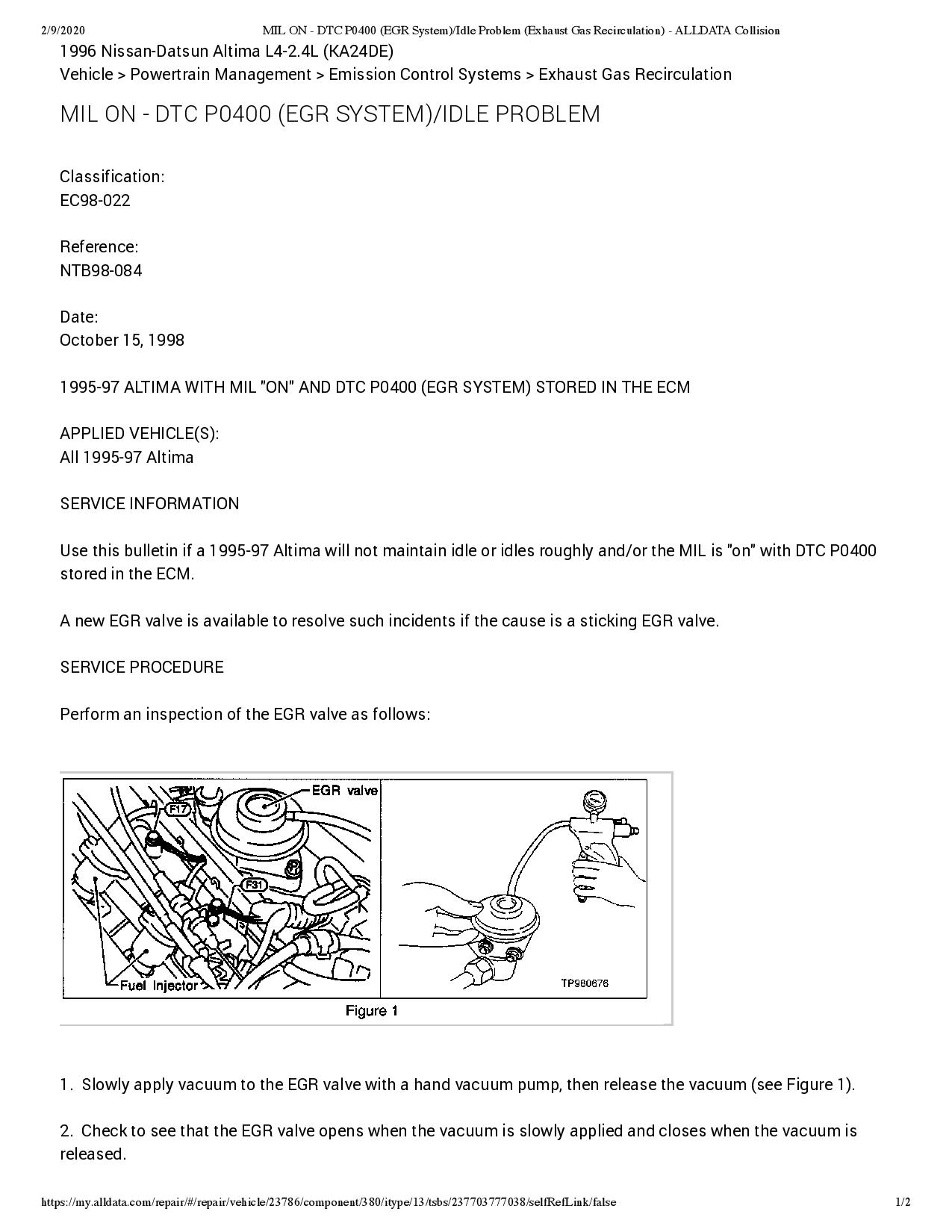

There is a TSB for the EGR valves sticking on these vehicles attached below.
Could be the cause of your P0400 code.
A stuck open EGR valve can also cause you to have a lean running condition.
Let us know what you find.
Regards, Joe

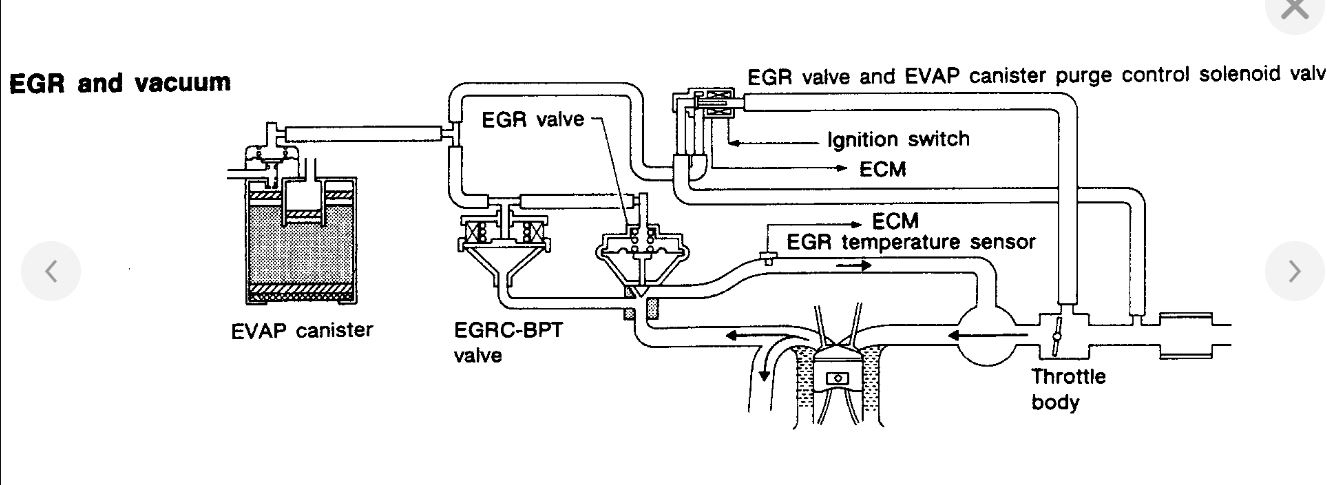

After fixing all vacuum leaks yesterday I cleared the codes. After work today on the way home the check engine light came on again. I expected to pull the p0170 and p0400 again, but when I pulled the codes it was only the p0170 code. Could fixing those bad vacuum leaks have solved the p0400?
Feb 10, 2020 at 5:46 AM
No, it just takes longer for that code to set than the 171.

10-4. I will go through the other tests that we have already discussed for EGR valve and fuel pressure it may be a few days before I post back. I'll have to order a fuel pressure gauge and a hand vacuum pump to perform those tests.
Feb 10, 2020 at 6:06 AM
Sounds like a plan.
Feb 10, 2020 at 6:23 AM
RICHARD HOLLOWAY
  • 26 POSTS
Fuel pressure 36 psi with vacuum hose connected. 44 psi with vacuum hose disconnected.
EGR valve does move up with vacuum applied and drops when vacuum is released.

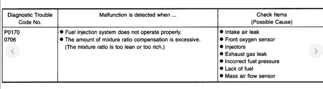

P0170 came back long term trim at idle still reading 0.0 at 2,000 rpm's. it's reading 9.4 Freeze frame shows it happened at idle fuel system OL-Fault, 797 rpm , long term trim 0 short term trim 25.
Feb 14, 2020 at 6:50 AM
It is running to lean now.
Feb 14, 2020 at 6:58 AM
RICHARD HOLLOWAY
  • 26 POSTS
Okay, injectors are good. I checked those when I replaced the seals. I know there isn't a vacuum leak anymore. We know the fuel pressure is good. So that leaves exhaust gas leak, front 02 sensor, or MAF sensor.

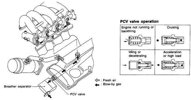

As a precaution i would first replace the PCV valve.
Also check the condition of the PCV hose.
If it is cracked or collapsing replace the hose.
I have attached the photo showing the location in the picture below.
I failed PCV valve can cause MAF sensor reading issues and it is a cheaper replacement part before replacing the MAF. I would replace the PCV valve and retest and then i think your next step would be to replace the MAF.
Regards, Joe
