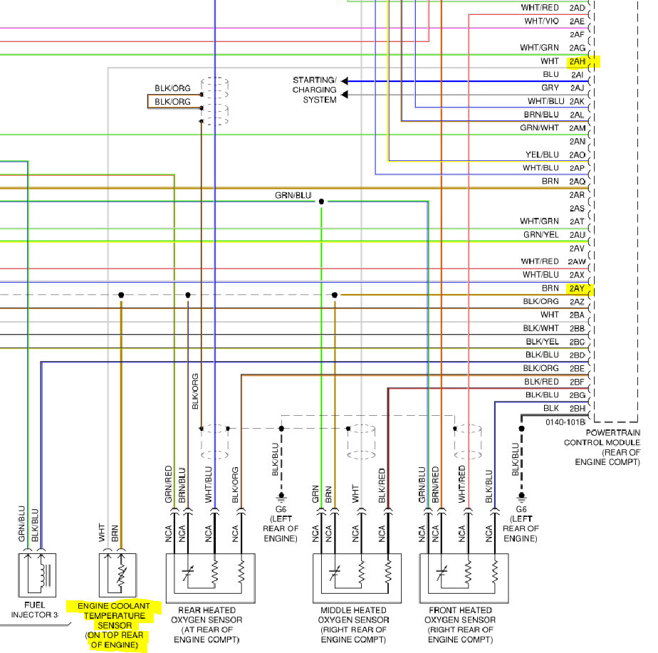

It all started with a leaking Water out flange…
-removed and noticed gasket and housing had failed. Replaced and filled with coolant. Leak fixed
-days later engine began to overheat after a short drive, off hunch I replaced Thermostat and filled with coolant. Engine was still overheating.
-days later I bought obdII scanner and read codes p0117. I reset codes and car ran like normal. Everything ran fine. I monitored the temperature, and it was going smoothly. Fans kicked at a good temperature. So, I went on a drive.
- During the 10–15-minute drive everything was still going good, I thought I had fixed the issue. Then on my way home the issue returned, temp shot up to 285F on my reader then car gauge slowly climbed up to High then began to drop to below Low point on gauge. The scanner still read hot temperature from 234,240,285F.
-I bought t stat at auto zone and water outlet flange on Amazon. Could this be an issue?

P0117 is a generic OBD2 code. It indicates that your Mazda 3’s PCM has detected the signal coming from the engine coolant temperature (ECT) sensor has a voltage level below its normal operating range.
While P0117 is often caused by a bad sensor or wiring issue, you should treat it like the engine is overheating as the fault can also be caused by a physically overheating engine.
One reason for an overheating engine after cooling system repair is a possible air lock.

Check the coolant temperature sensor, connector and wiring
See image 1 for wiring diagram
A good video on sensor location, covers fault P0118:
https://youtu.be/lnbR4q7jupQ
As you replaced the outlet coolant flange, the flange incorporates the sensor.
It could be a bad quality part if the sensor came with the housing
