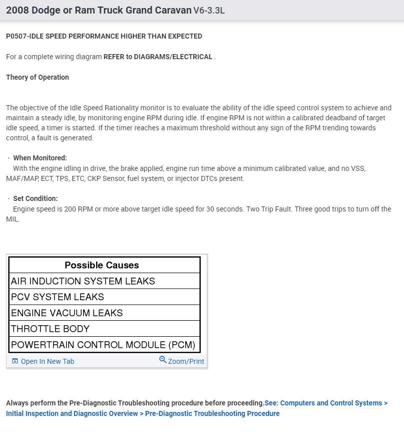

My caravan has a DTC code P0507. What would cause this and how would i fix it?

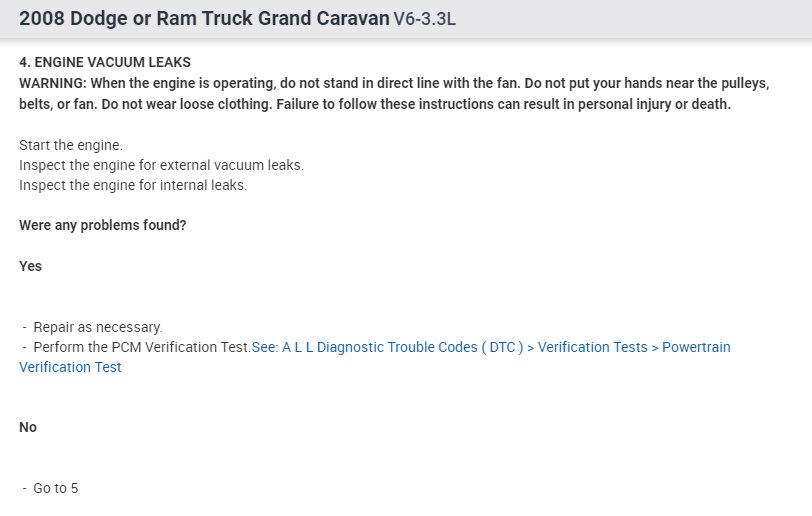

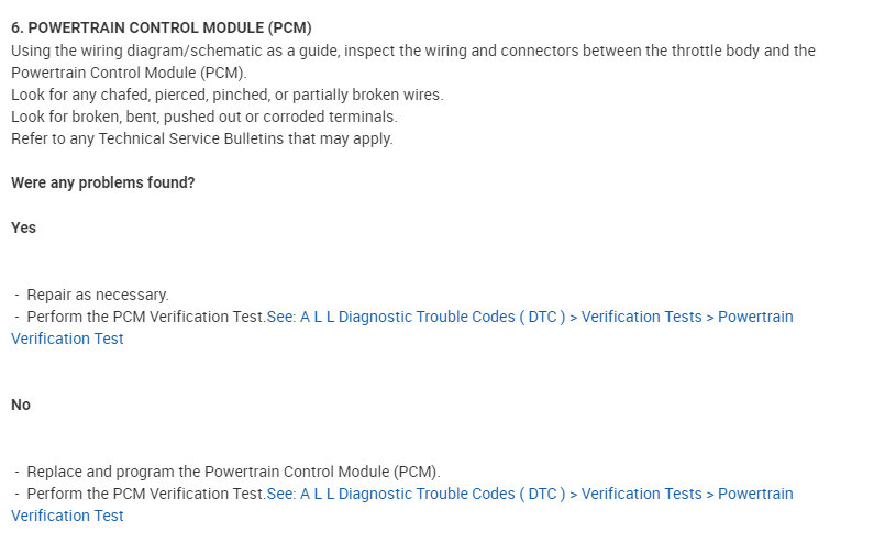

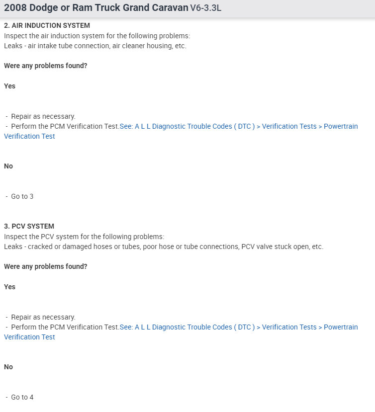

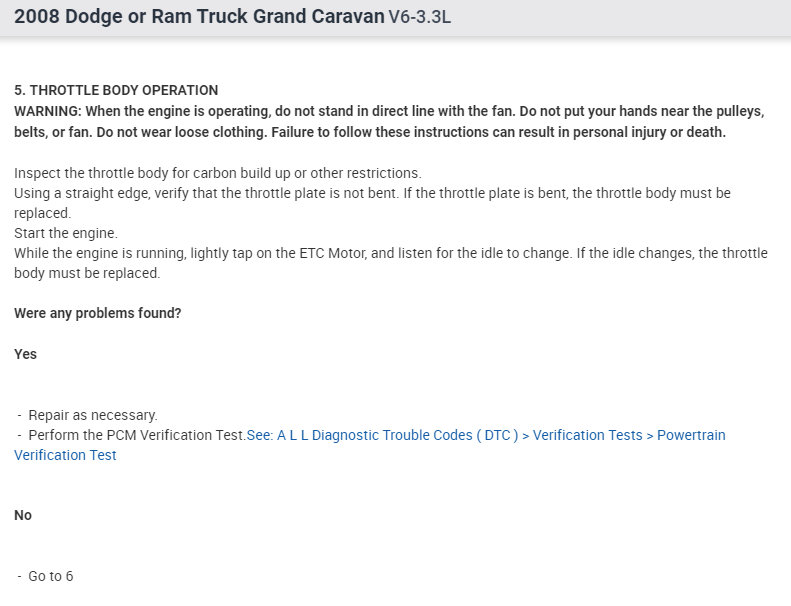

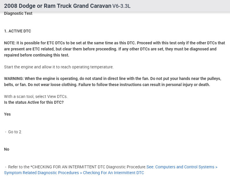

The codeP0507 Idle speed performance higher than expected
This could be due to a leak in the intake system or in the PCV system, and it could be due to a vacuum leak. It can also be due to an issue with the PCM.
I have attached the diagnostics for the code P0507 below for your reference.
Let me know of any questions.
