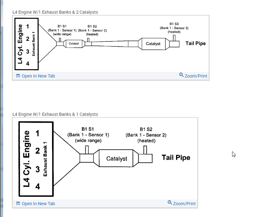

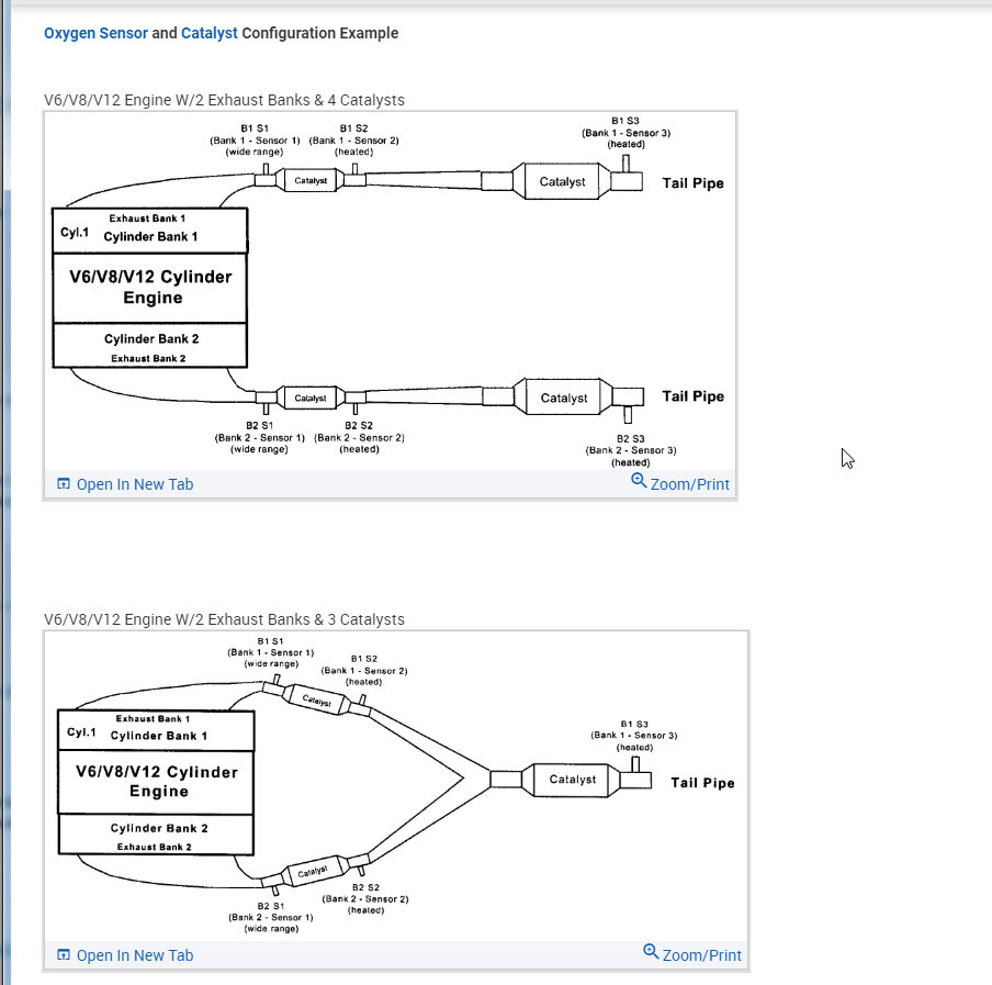

How many catalytic converters are on my car
2002 VOLKSWAGEN PASSAT
172,000 MILES • 2.8L • 6 CYL • TURBO • 4WD • AUTOMATIC
SHANE LORD
Which ones are secondary?
Apr 23, 2020 at 2:03 AM
There are a couple different options depending on engine and options. I can't find any definitive way to tell which one each has so it looks like you will have to see the documents and then compare with how your vehicle is equipped. Looks like the 4 cylinder has either one or two so I would look towards the rear of the vehicle and see if you have a one back there and that means you would have two.
Let me know what you find. Thanks
