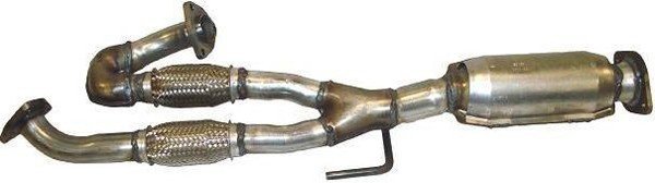

How many catalytic converters are on the car listed above that is a 3.5SE?
Feb 21, 2017 at 3:58 AM
STEVE W.
  • 15,349 POSTS

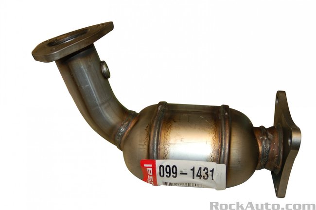

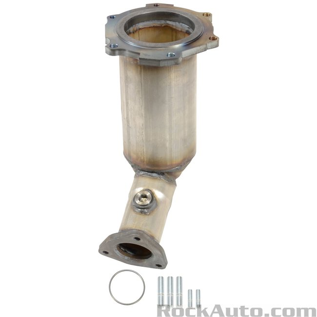

There are three. One attaches to the front bank of cylinders near the radiator, another attaches to the rear bank of cylinders near the firewall. Those both feed into a Y pipe that goes under the floor and has the third converter in it.
The front two are the most often replaced.

There are three one at each exhaust manifold and the main cat under the car here is a guide to help you test each of them.
