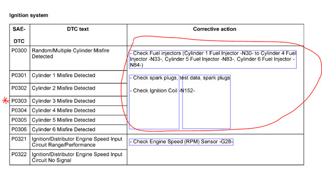

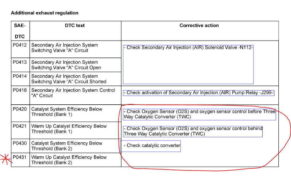

I have a misfire on the left side bank 1 cylinder 3. I wanted to know if a bad catalytic converter from bank 2 from the right side would cause the misfire? Also I noticed the car has been overheating on hot days.

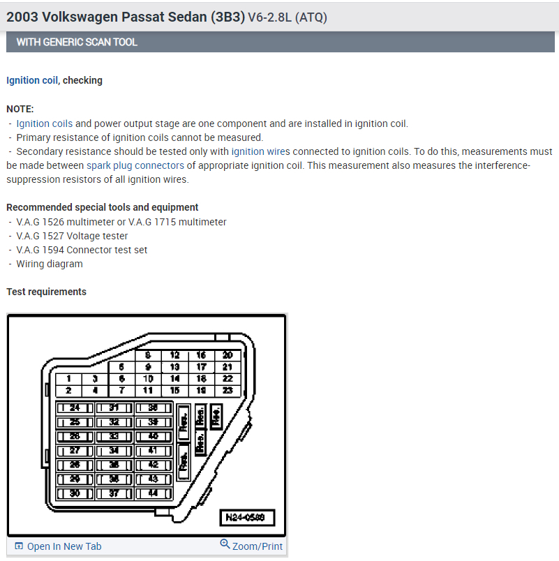

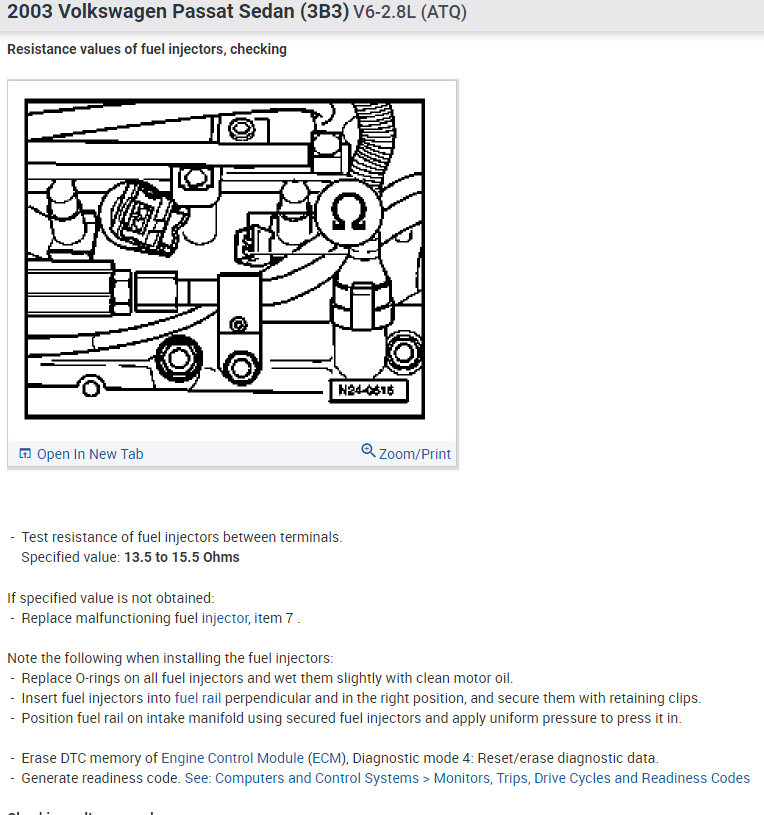

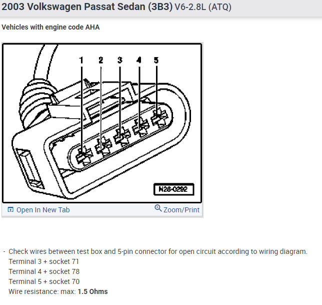

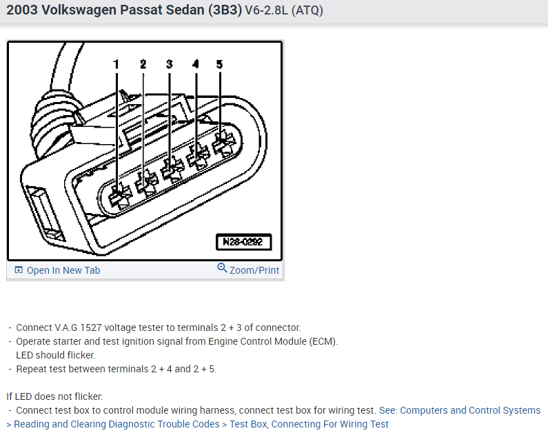

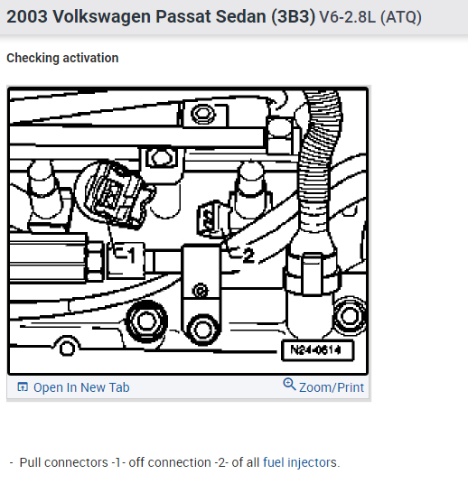

There are few reasons you could have the misfire. Bad catalytic converter is one of the reasons that it can misfire. Then again it could be due to other factors.

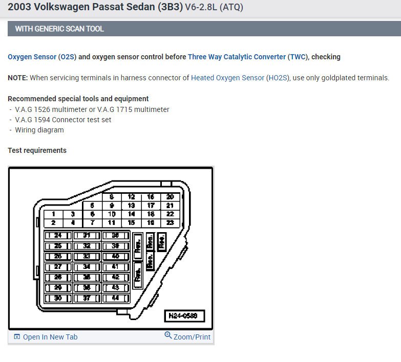

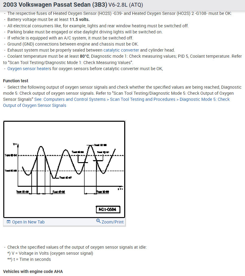

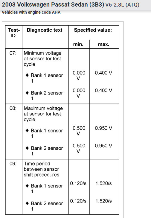

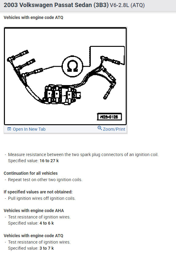

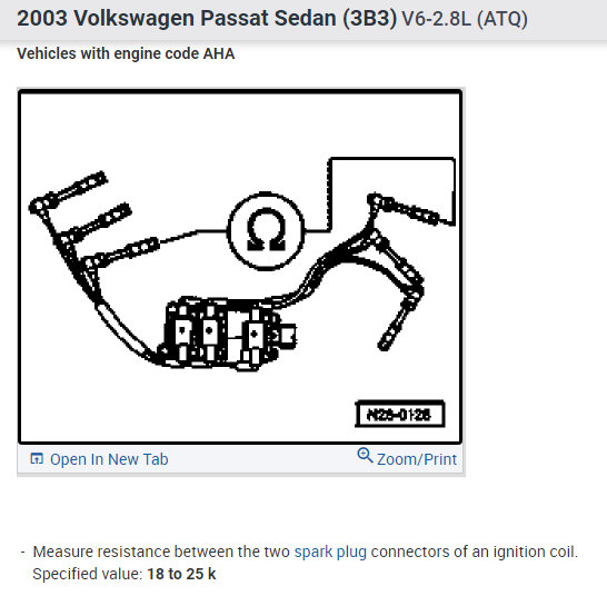

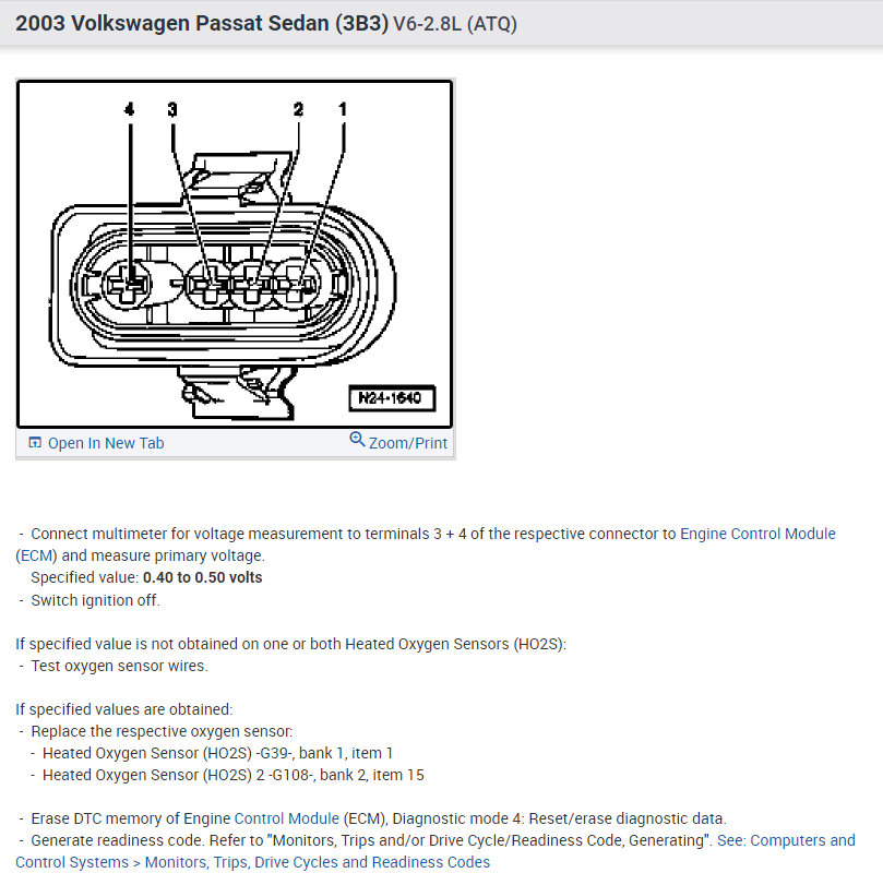

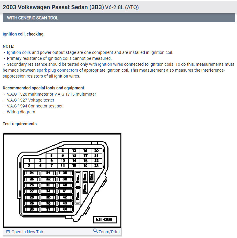

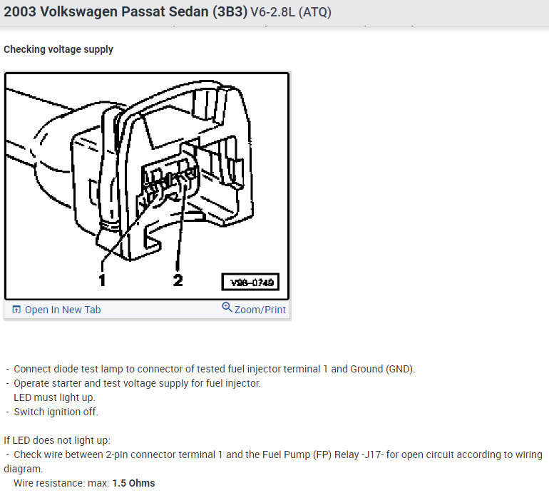

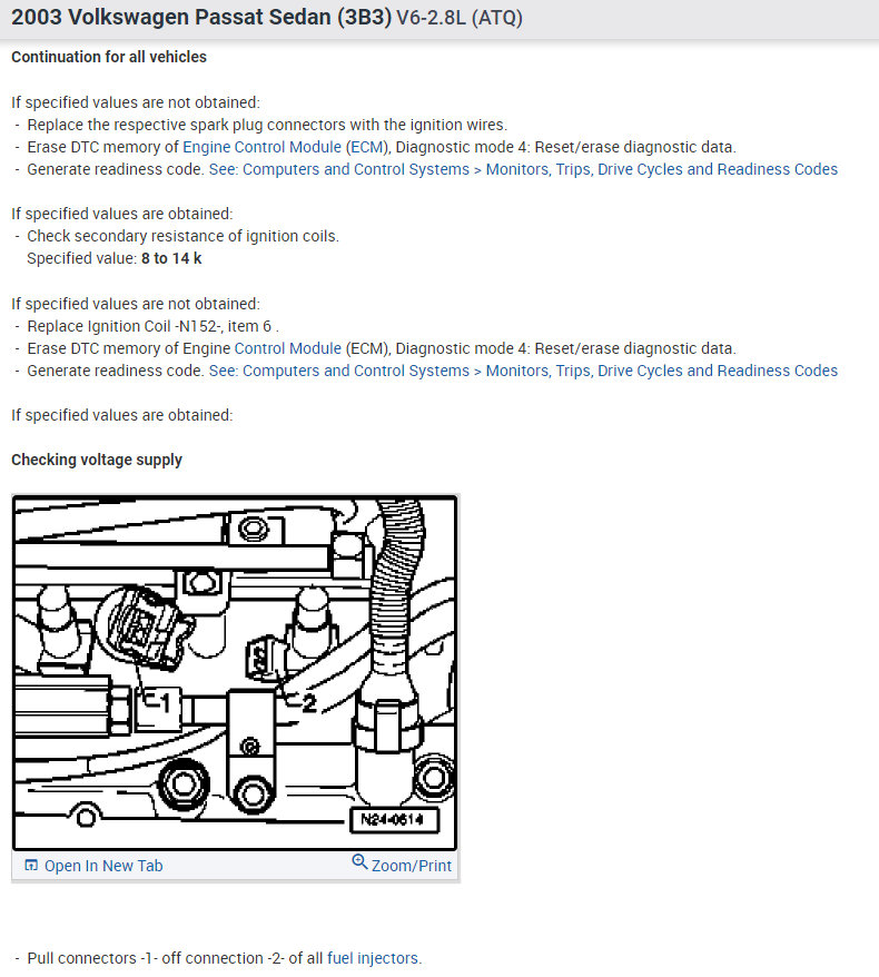

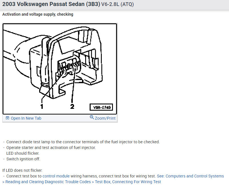

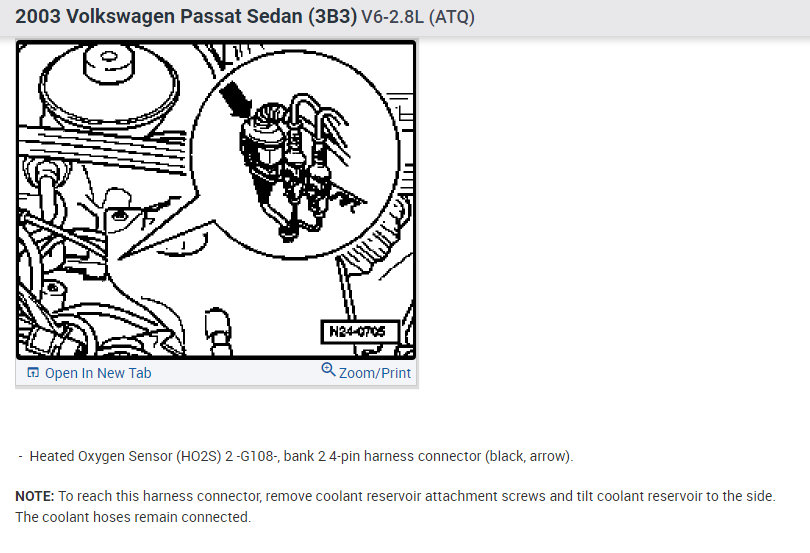

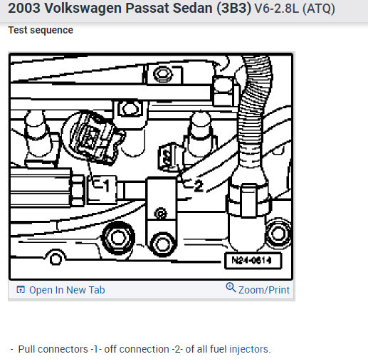

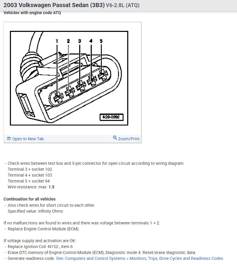

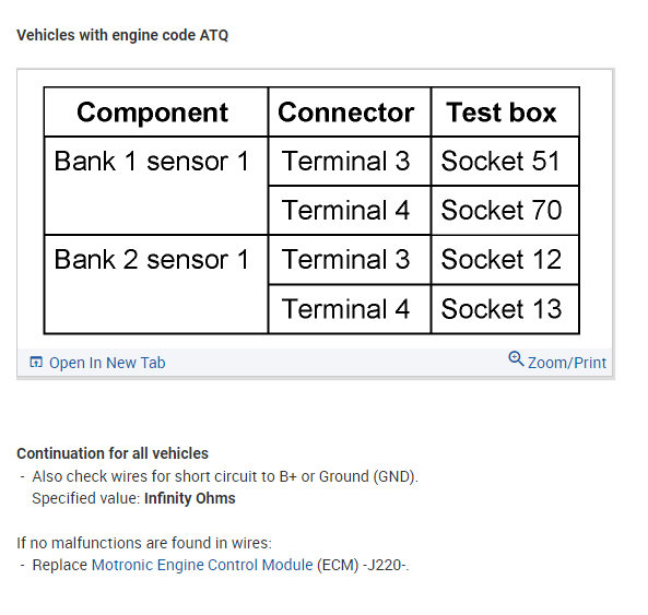

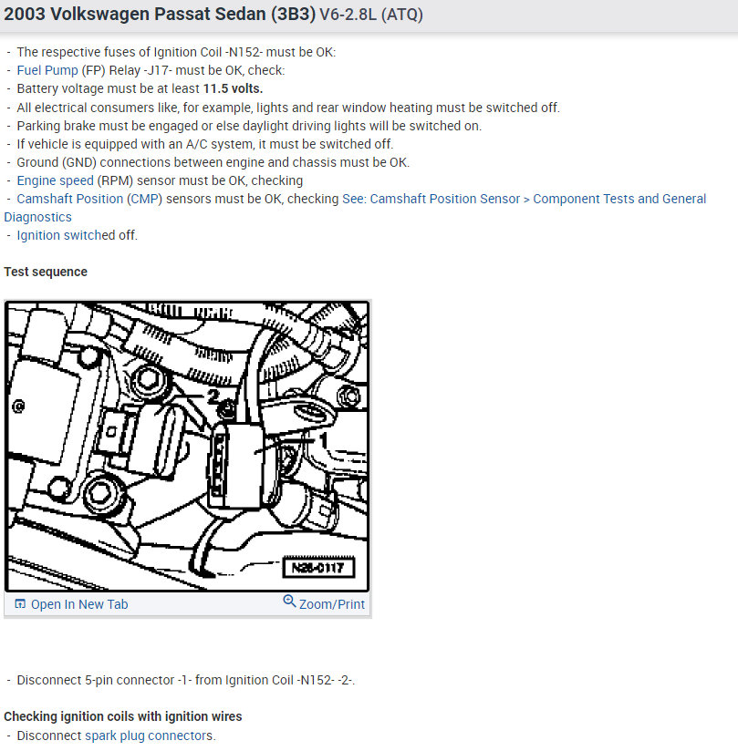

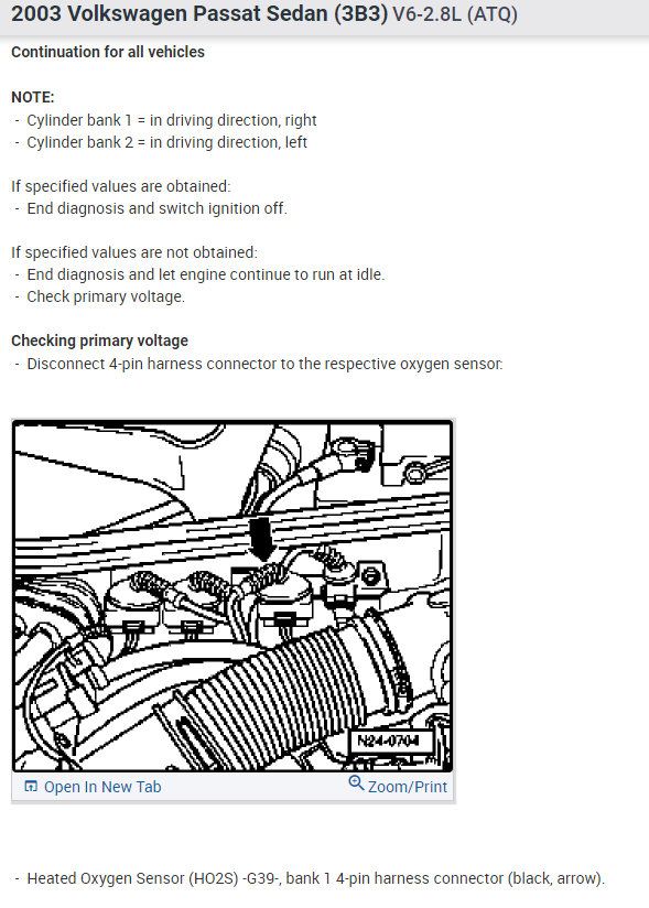

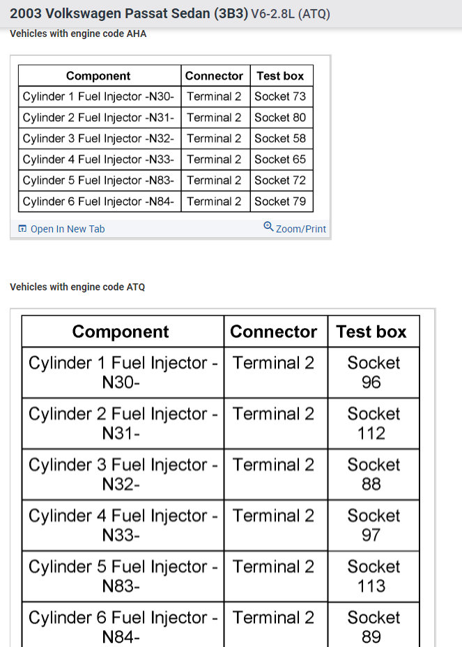

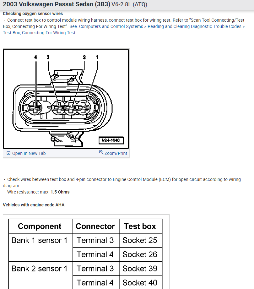

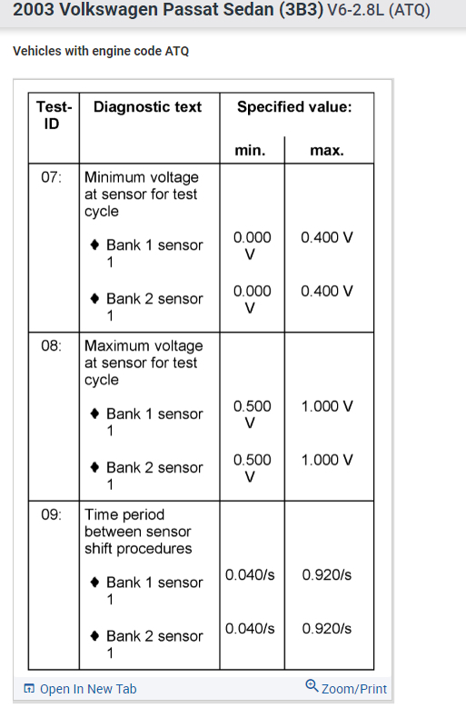

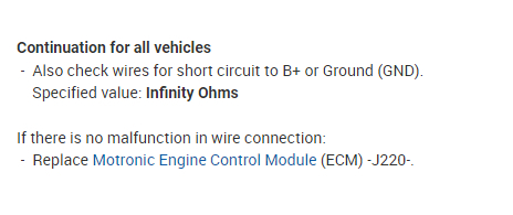

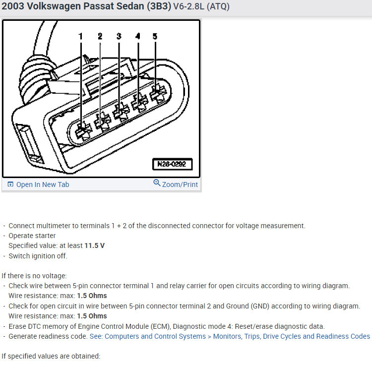

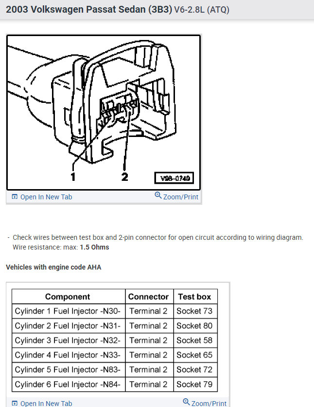

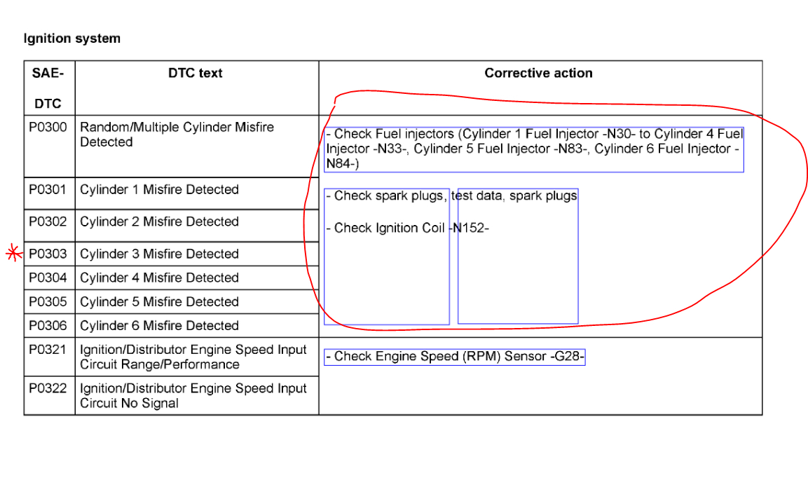

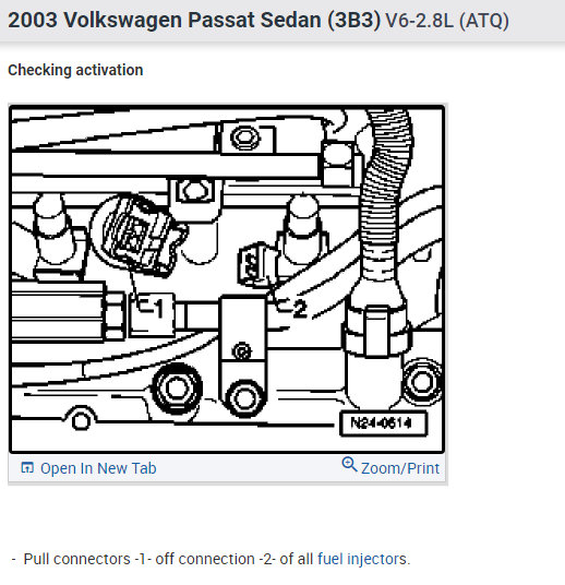

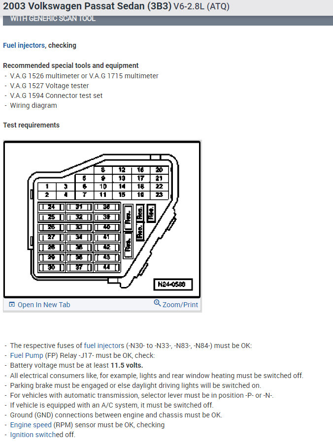

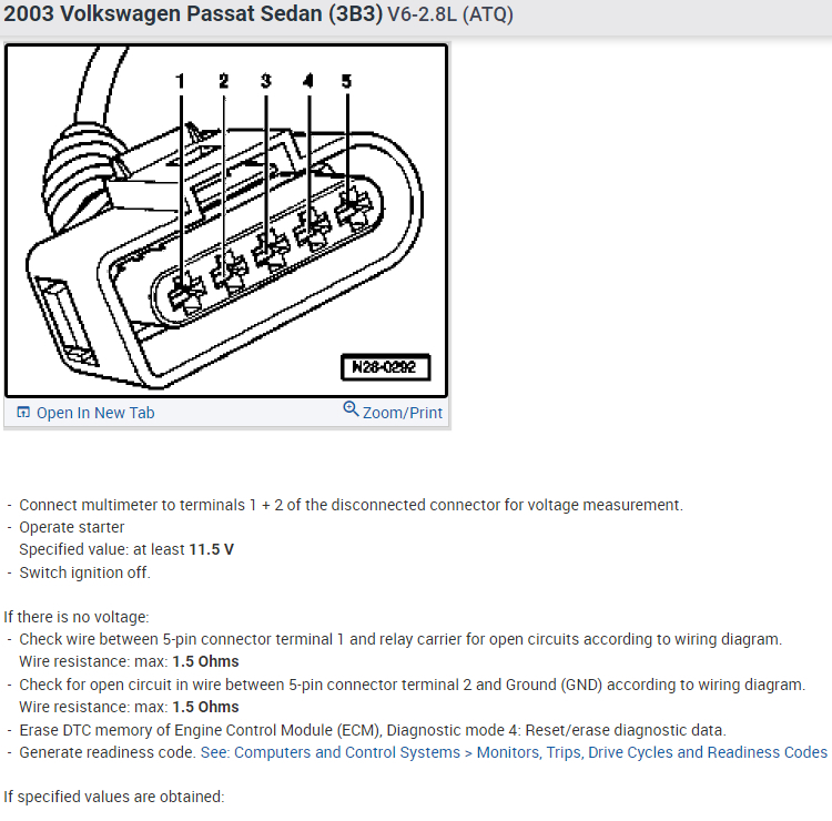

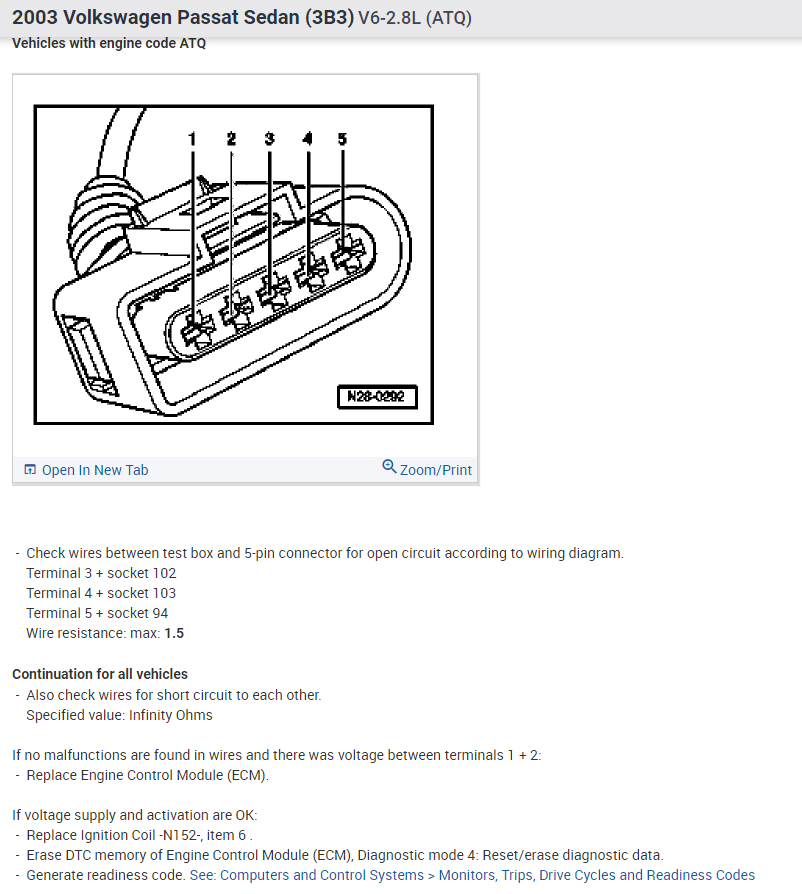

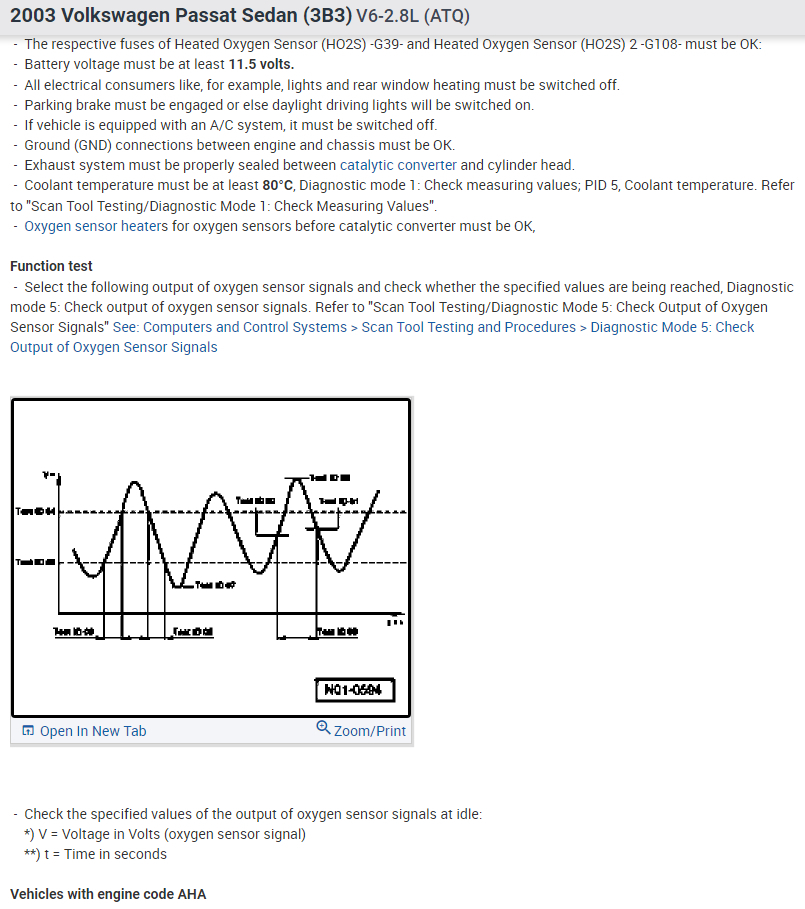

I have attached the complete diagnostics for bot code P0431 and P0303.
Go through that step by step process, it will help you narrow down exactly the issue that you might have.
