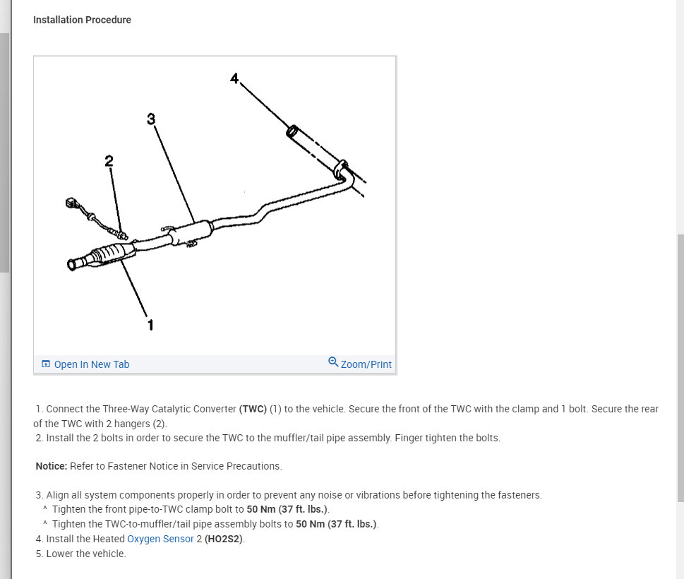

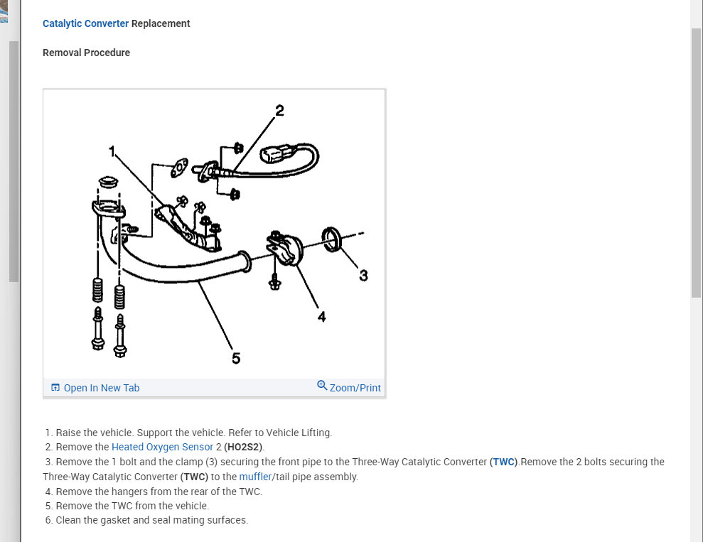

I need to know the pipe sizes going into and coming out of the converter off possible. I'm trying to avoid the trial-and-error guessing game as I buy conversion pipes
Apr 26, 2022 at 7:57 AM

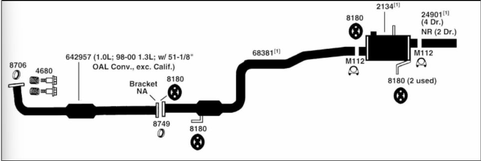

I am not finding any specific specs on the pipe diameter but looking at this diagram below it appears to be a 1.5-inch diameter pipe.
Basically, if you take a look at the diagram below you will see the clamps are M112 clamps.
These are for a 1.5-inch diameter pipe so that would make sense for this vehicle.
Please see the info below and let us know what questions you have. Also, if this turns out to be wrong, please let us know.
Thanks

To be perfectly clear, that would be outer diameter, correct?
Apr 27, 2022 at 7:02 AM
Correct. Here is a link to Summit that will help with the exact measurements for these clamps:
https://www.summitracing.com/parts/aph-m112?seid=srese2&utm_source=bing&utm_medium=cpc&utm_campaign=Brands+|+A&utm_term=4581733679766074&utm_content=GSAPI+5e2b1603362ef
Thanks
Apr 27, 2022 at 12:09 PM
THEMAILMAN
  • 102 POSTS
Okay. Where I made the cuts, I found the inner diameter before the converter to be 1.75in and the outer diameter after the converter to be 1.75in.
