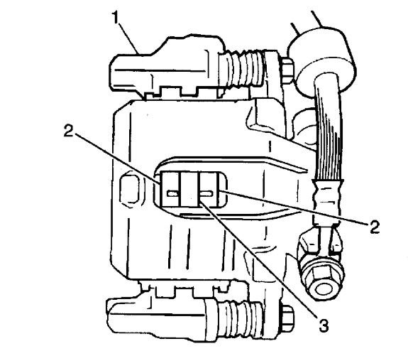

When I would go 50-55 mph the wheel would shake.
My brakes didn't work one day while backing up. (Had to use my emergency brake to drive it home).
On the way home when I would use the brakes it felt like the car was jumping and shaking and also really loud.
Drove fine, just not when I applied the brakes.
Also sounds like maybe a rotor or wheel bearing but I'm not sure.
When the car was jacked up, you could easily turn the tire but it was catching somewhere and not as easy to turn when that area came around.

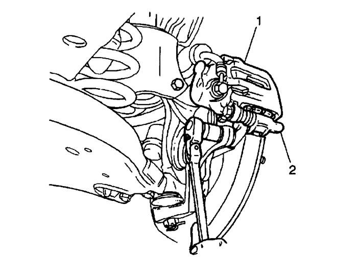

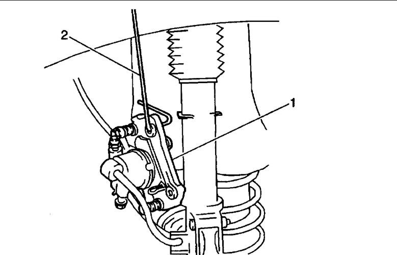

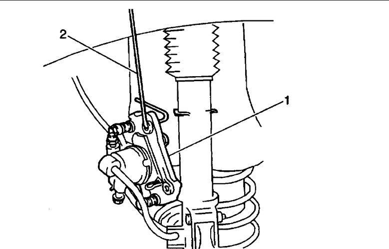

It sounds like your rotors are out of round causing most of your issues with the shaking.
I attached a guide to help you with the repair.
Rockauto.com is the best place to buy your parts.
Brake Rotor Replacement

4. Position the C-clamp around the outer pad (2) and caliper. Tighten the clamp until the piston bottoms in its bore.
5. Remove the 2 mounting bolts, the caliper (1), and the caliper bracket (2).
6. Lift the caliper and the caliper bracket, along with the brake pads, off of the rotor.
Notice: Do not allow the brake components to hang from the flexible brake hoses. Damage to the brake hoses could result.
7. Suspend the caliper and the caliper bracket (1) with a wire (2) in order to prevent damage to the brake hose.
8. Remove the brake rotor from the wheel hub. If necessary, install two 8 mm bolts into the rotor. Tighten the bolts in order to force the rotor off of the wheel hub.
