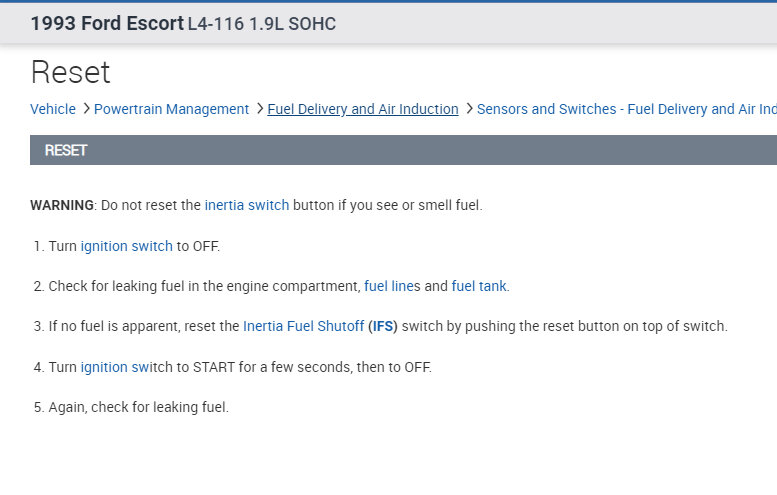

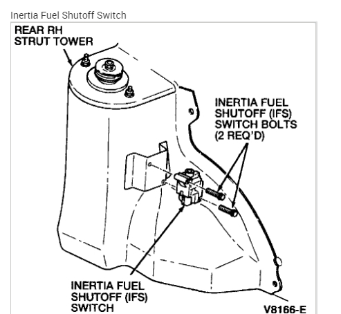

Try resetting the inertia switch. If you look at pic 1 below, it shows the location of the switch which is under the hood in the inner fender, near the strut tower. Pic 2 are the directions to reset.
Let me know if that helps with the light that is on.
