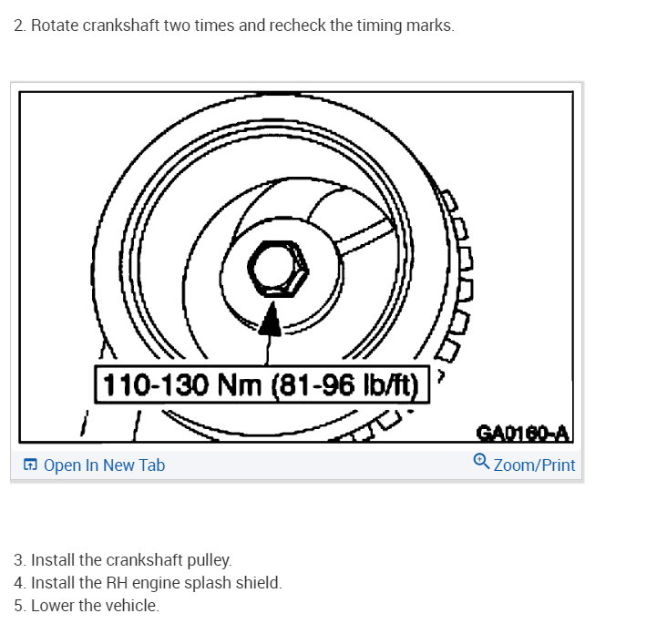

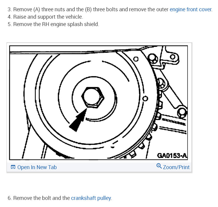

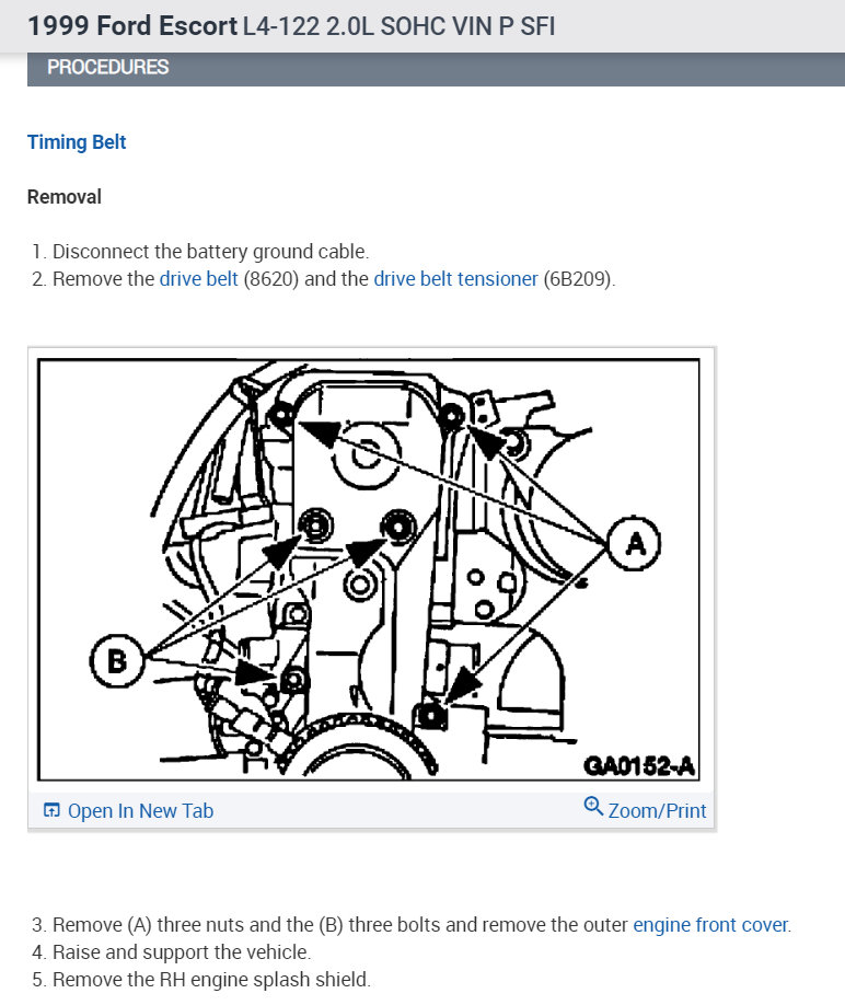

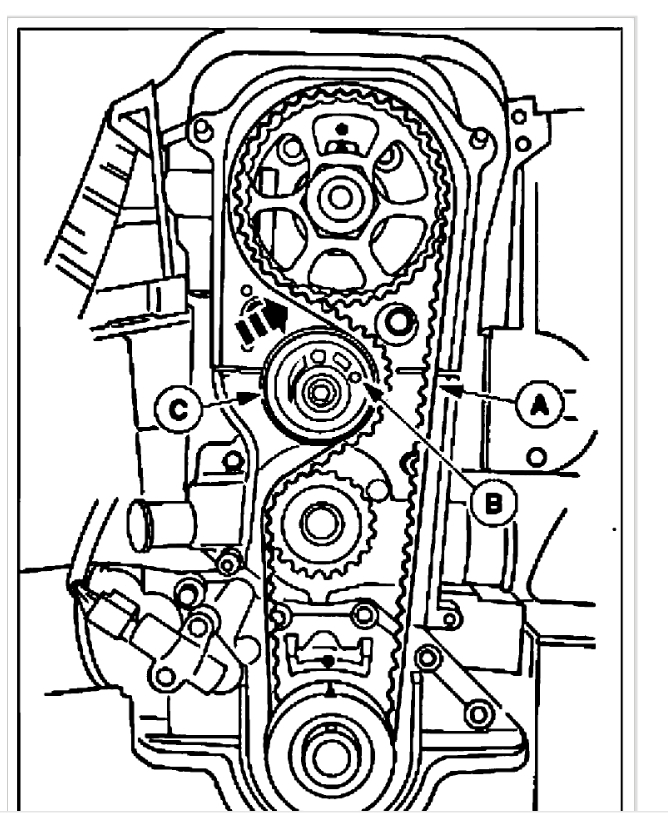

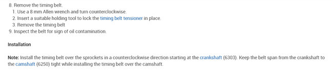

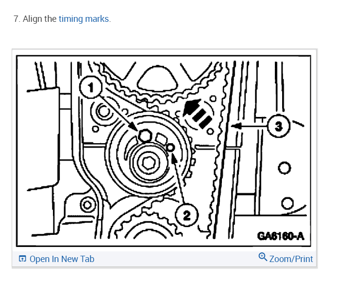

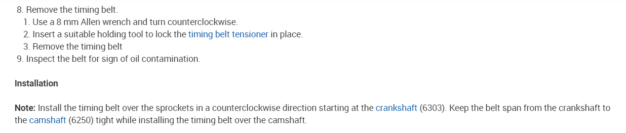

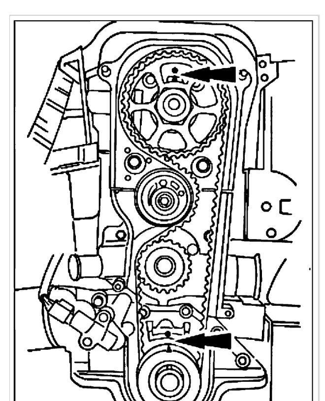

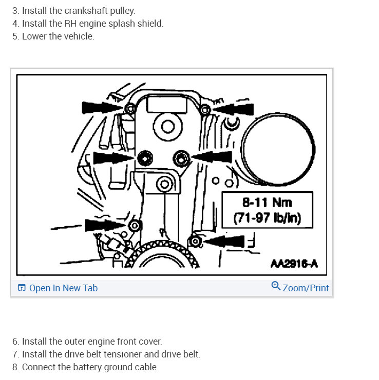

It sounds like the timing belt has jumped a tooth or two. Let's remove the timing belt cover to check the marks. I have found the instructions on how to replace the belt which shows the timing marks. Also, can you upload a quick video of the engine cranking over? That way I can see if the engine is in good shape. Check out the diagrams (below). Please let us know what you find. We are interested to see what it is.

We replaced the timing belt about a year ago. But we will double check it is threaded correctly and hasn't shifted for some reason. Here is a video of it. You can hear at the beginning when it kind of sputters but runs for a few seconds. It does that often, but just won't stay running. Thank you SO very much for any help! It is so very much appreciated!

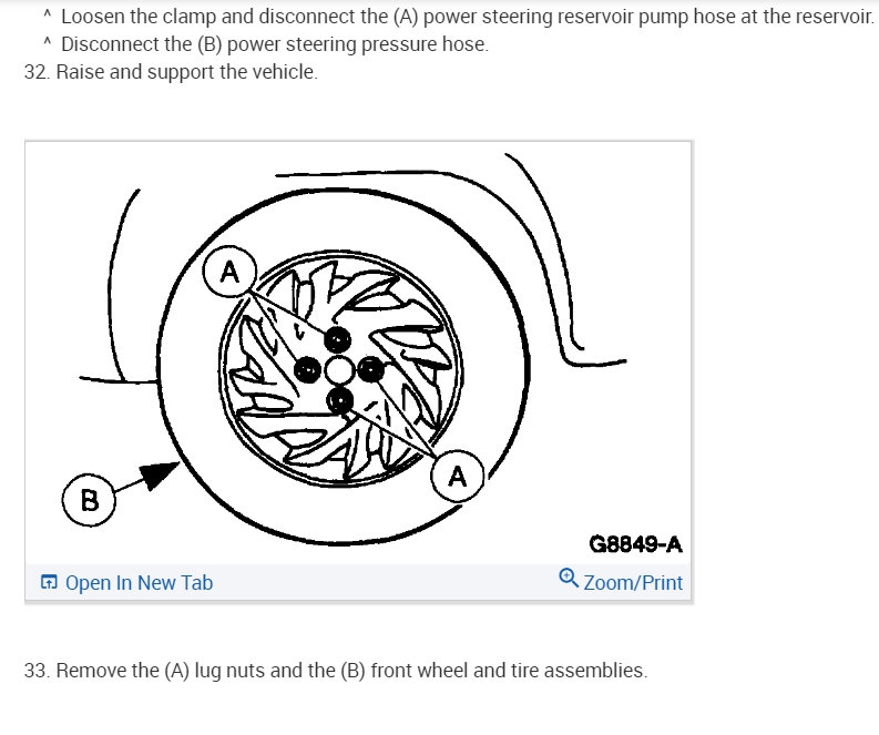

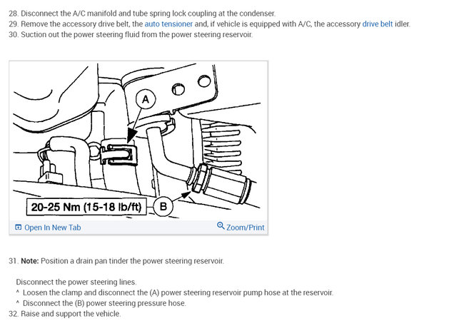

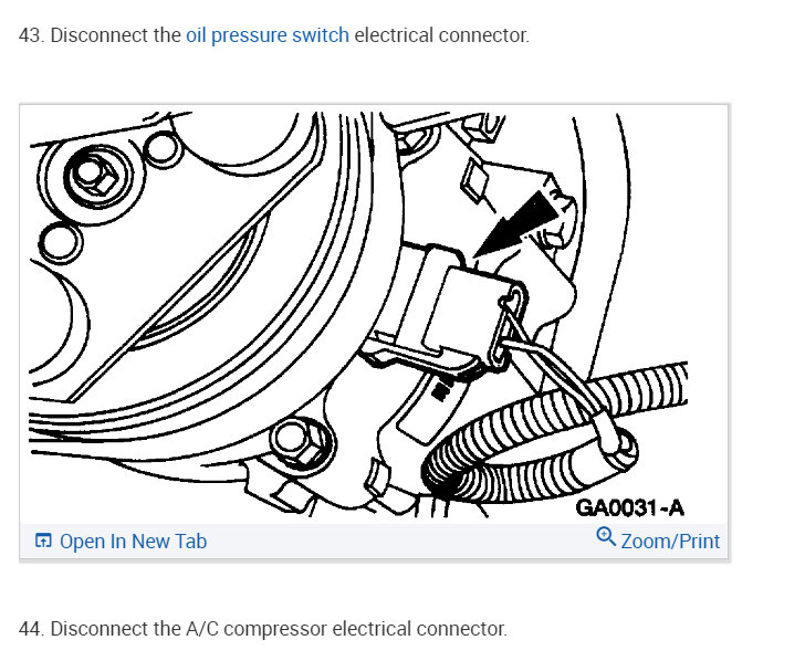

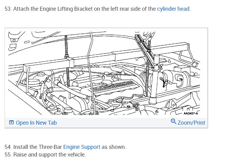

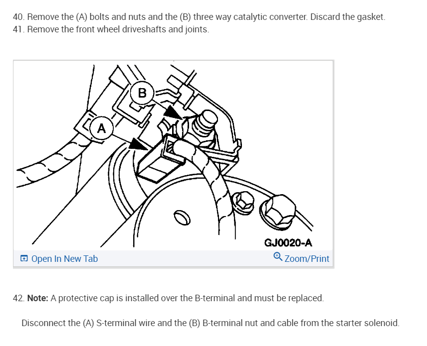

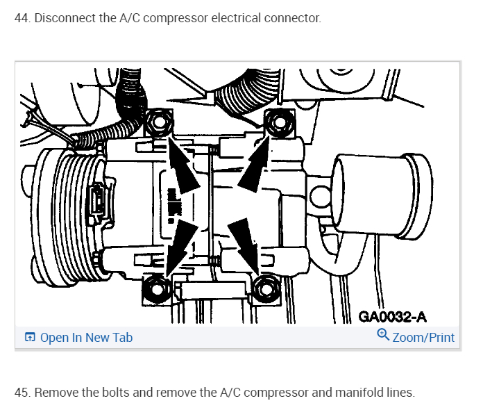

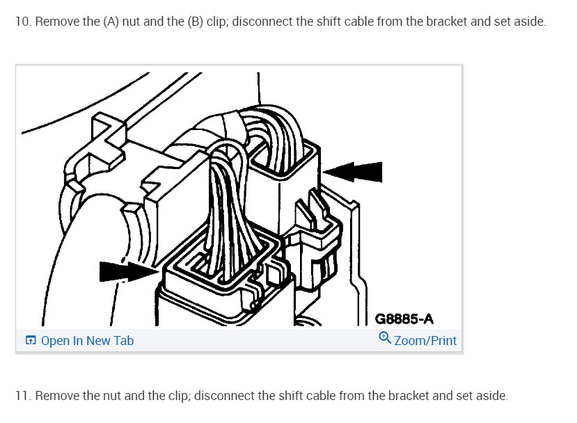

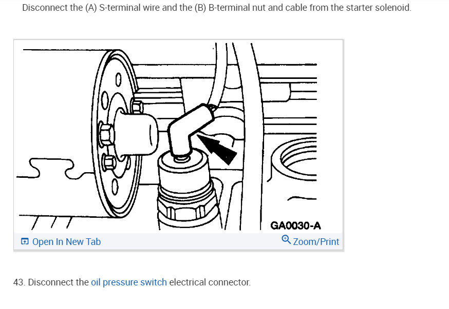

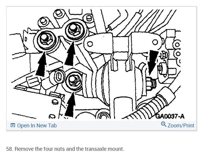

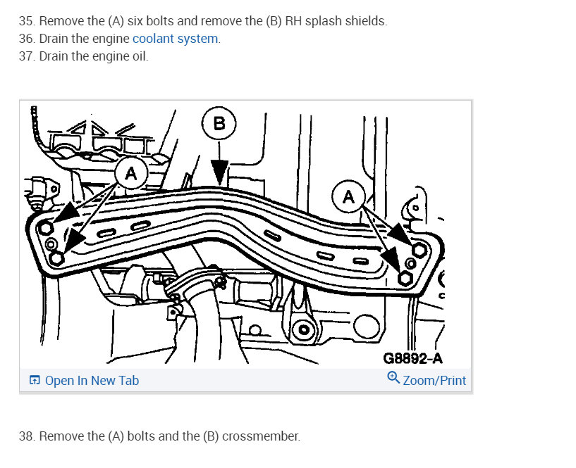

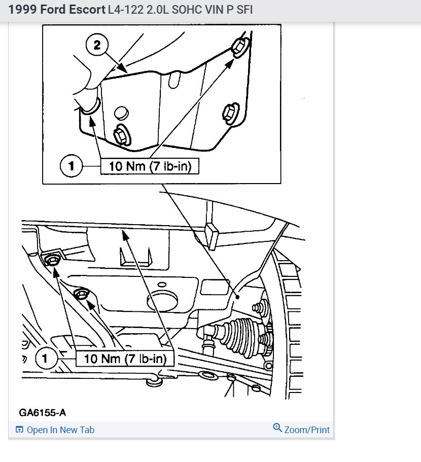

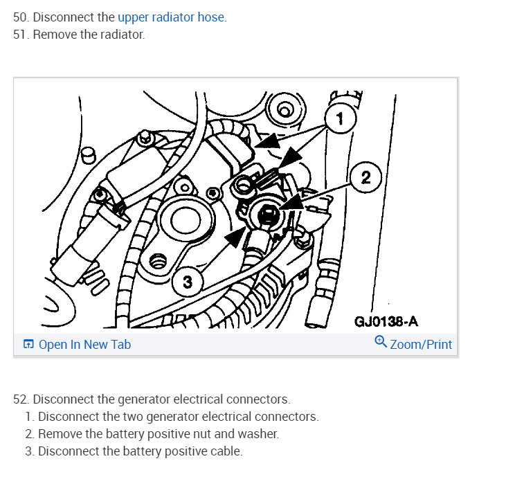

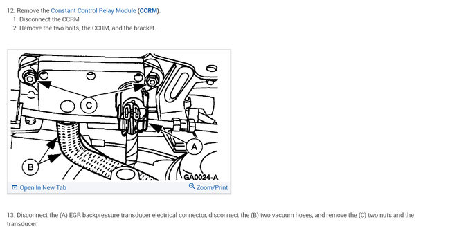

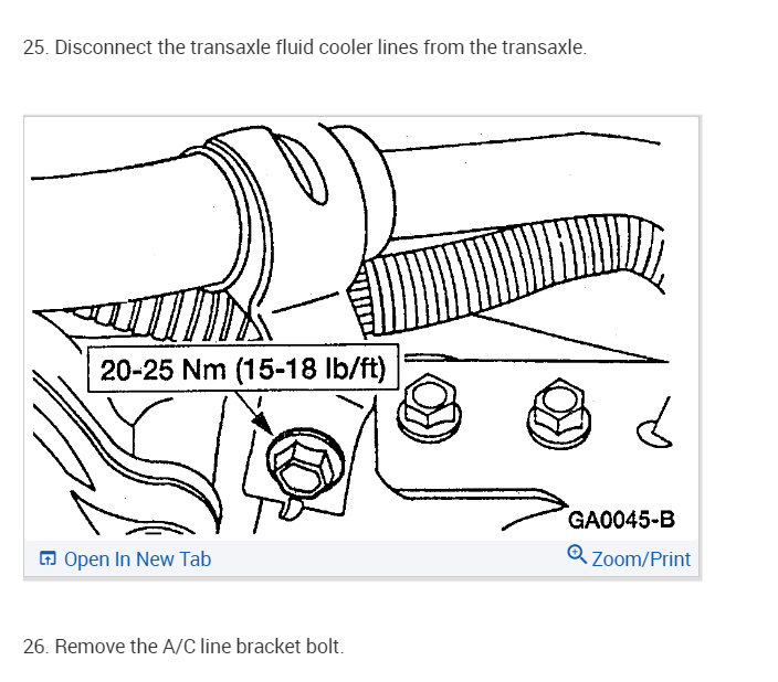

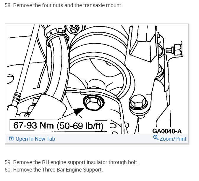

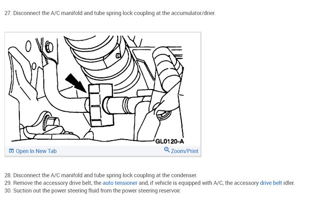

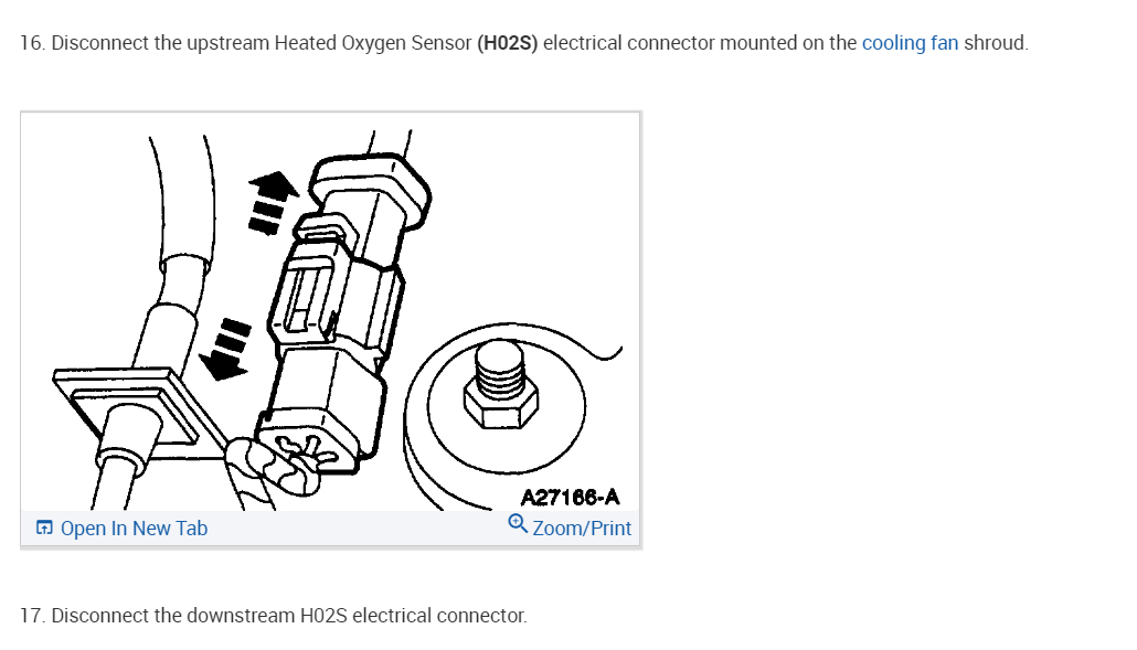

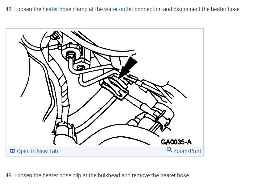

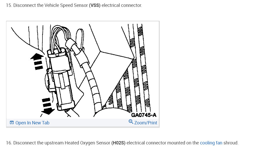

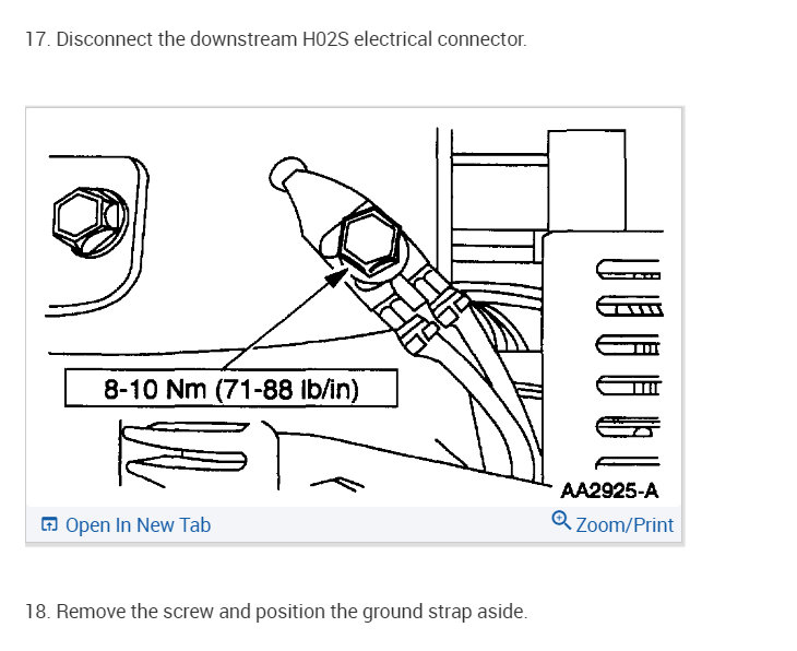

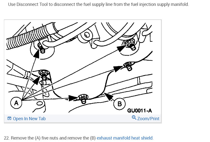

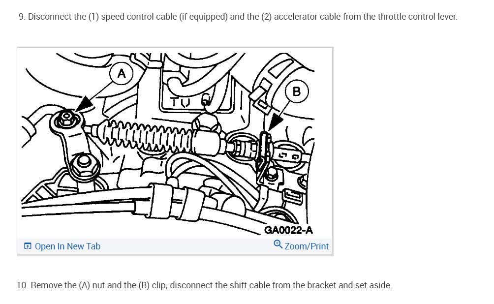

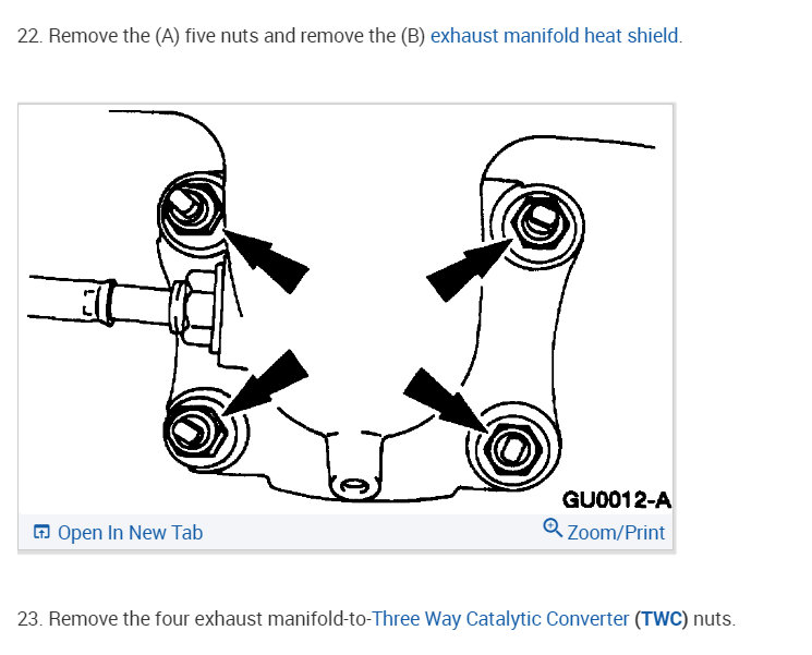

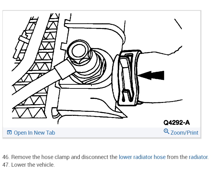

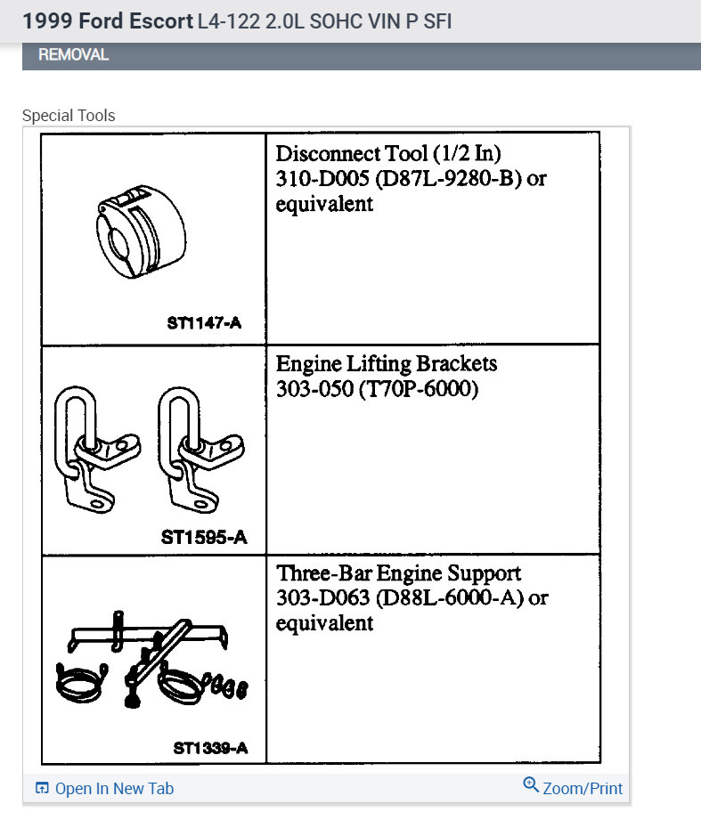

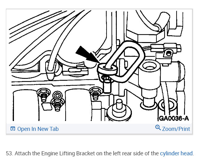

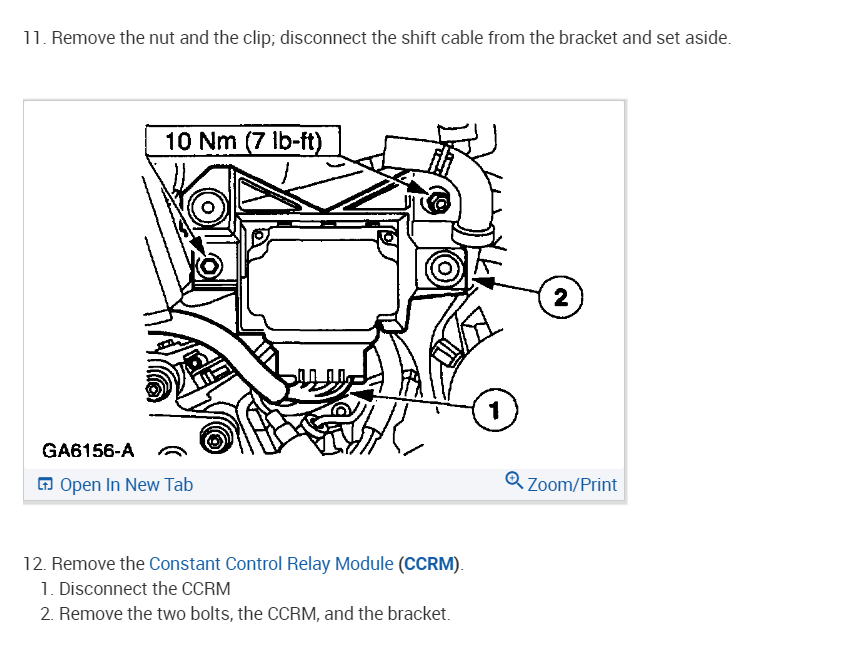

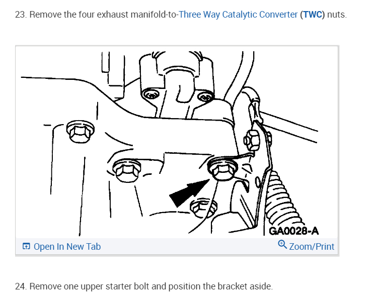

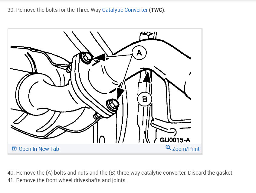

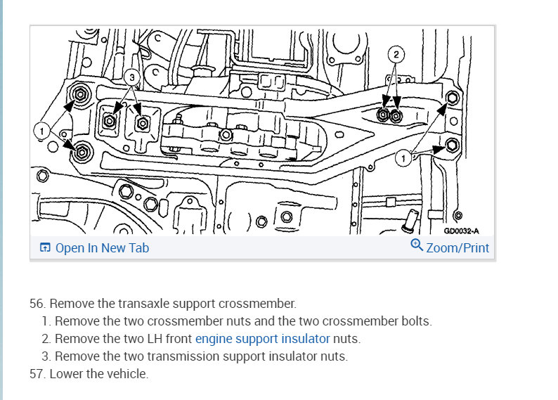

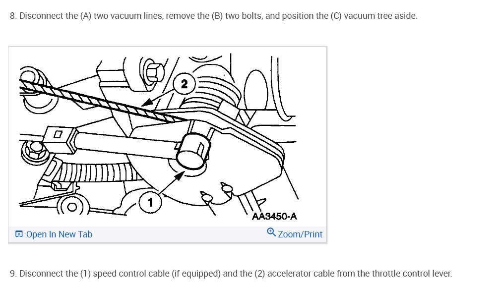

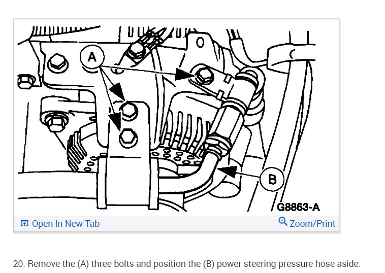

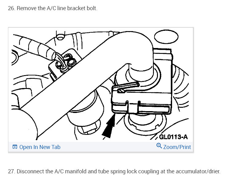

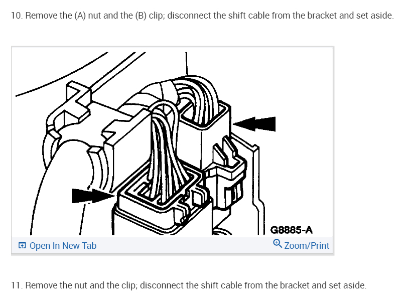

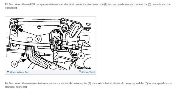

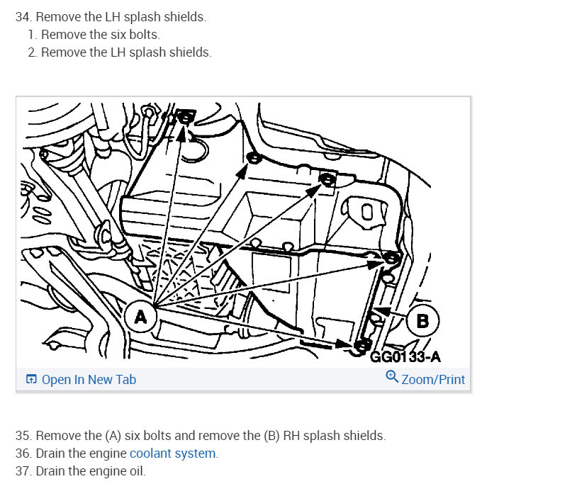

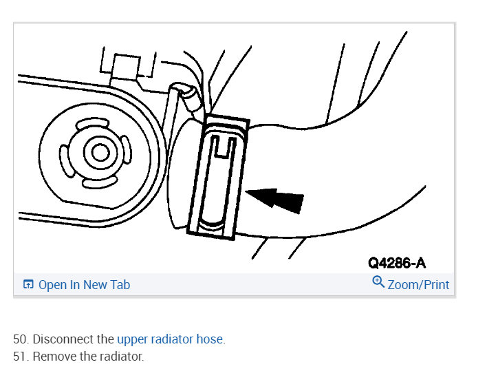

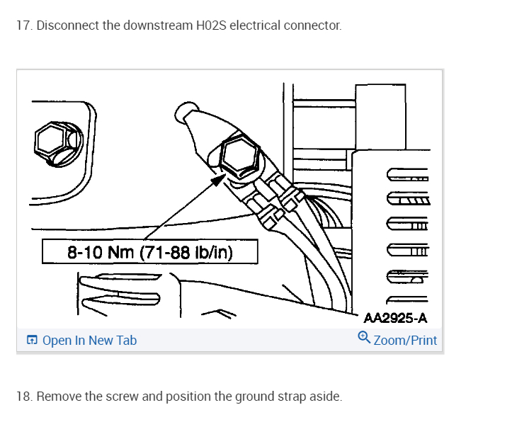

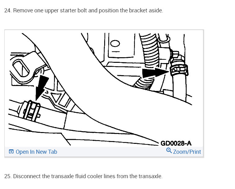

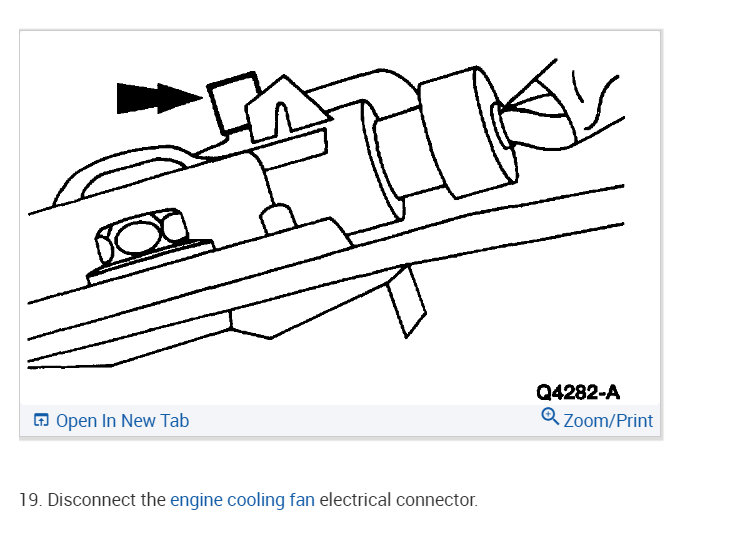

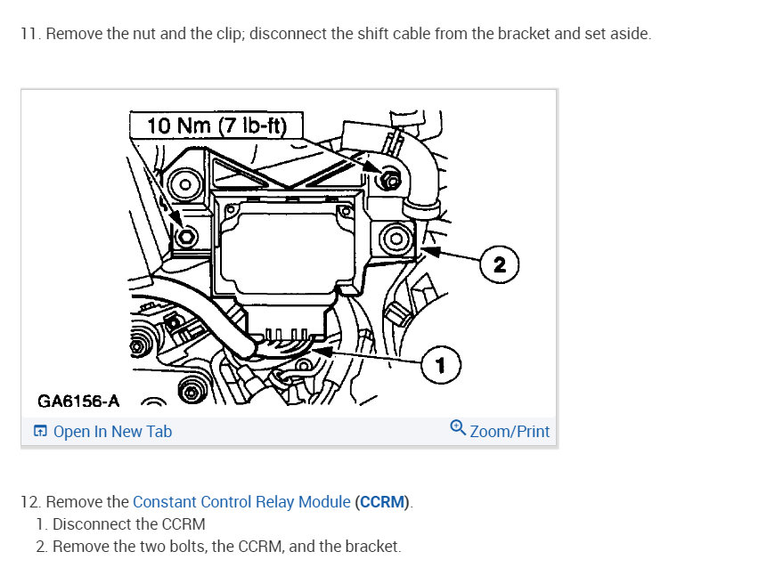

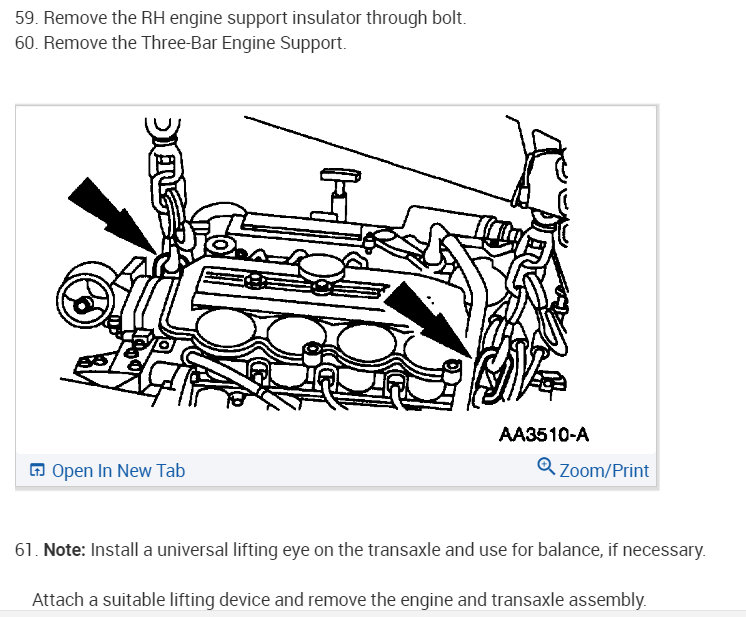

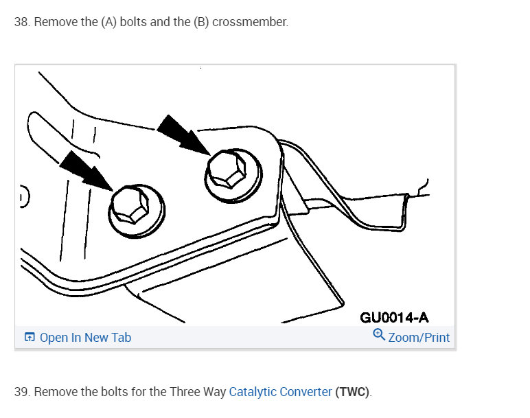

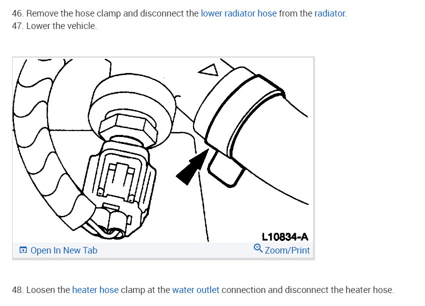

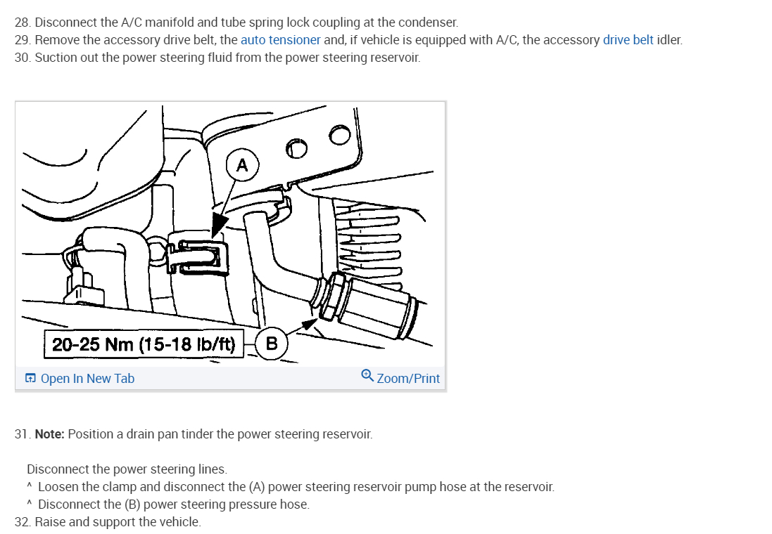

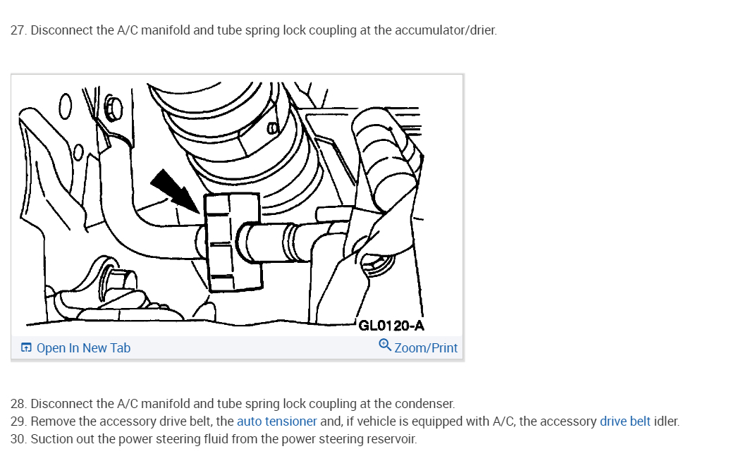

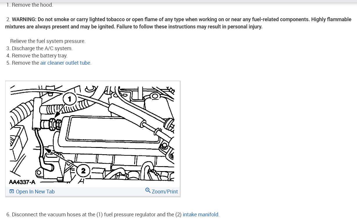

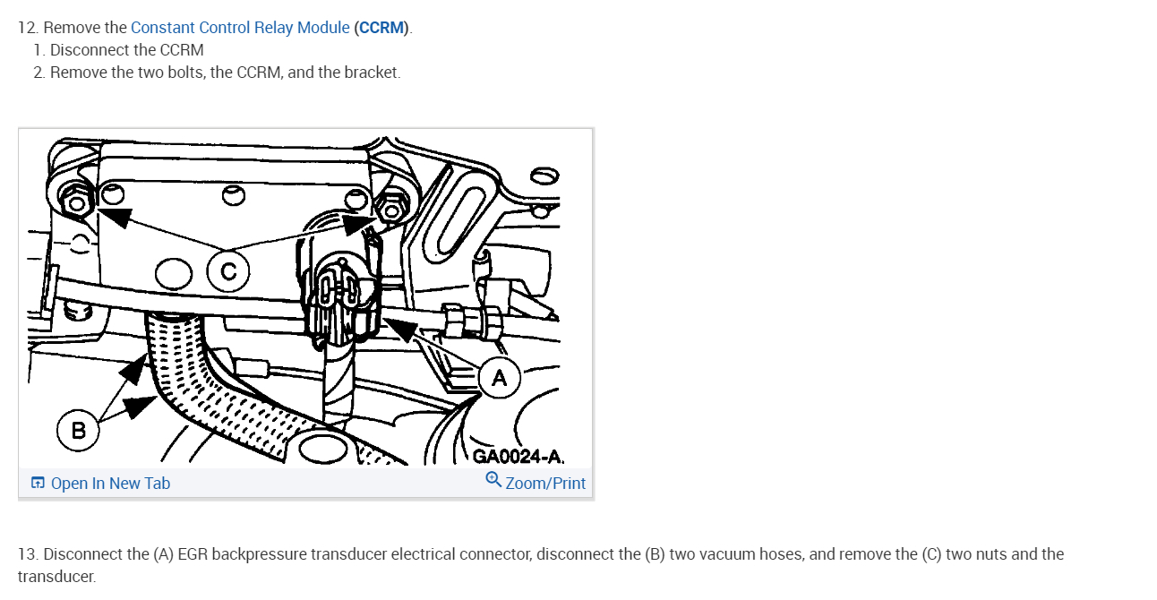

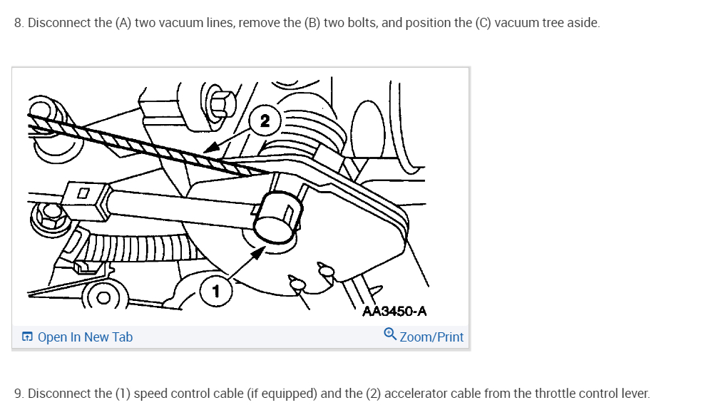

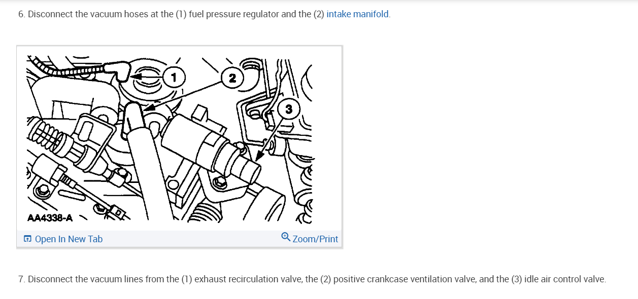

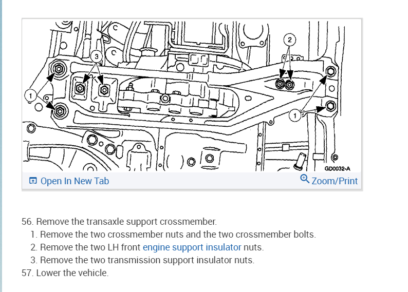

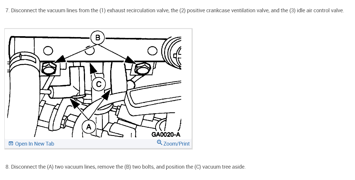

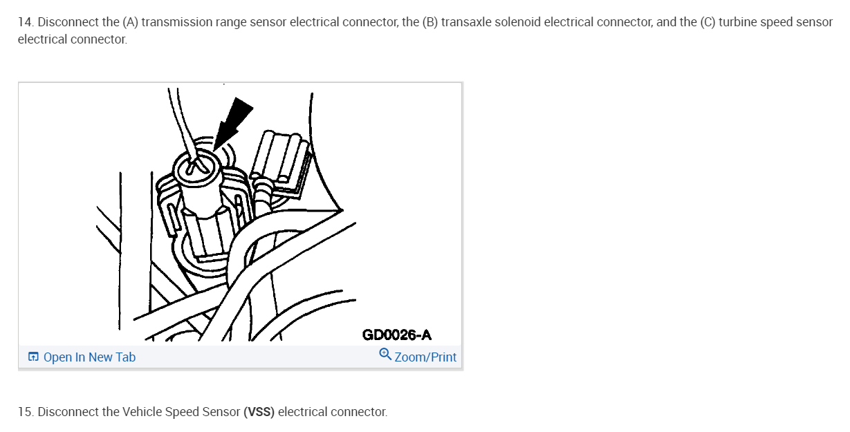

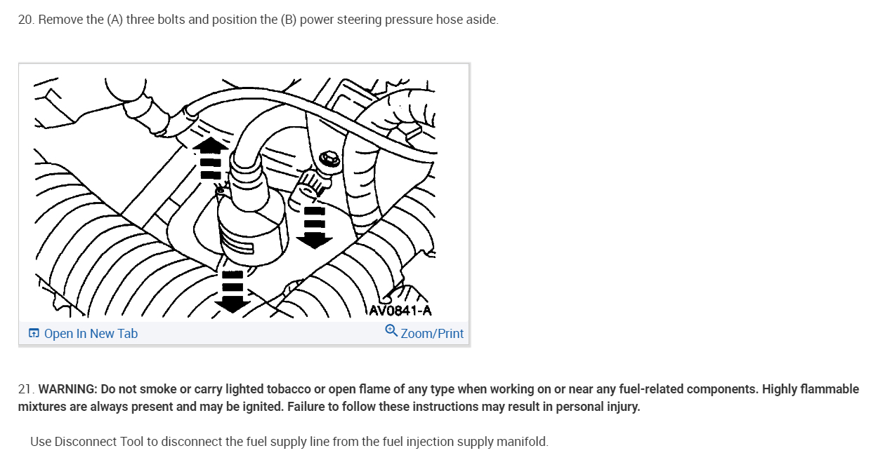

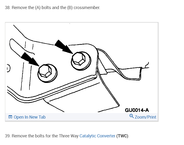

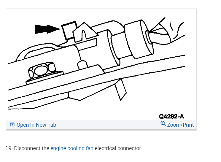

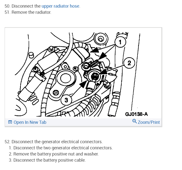

Yep, sorry about that. The engine is no good, time for another. Here is how you can remove the engine for repair or replacement.
