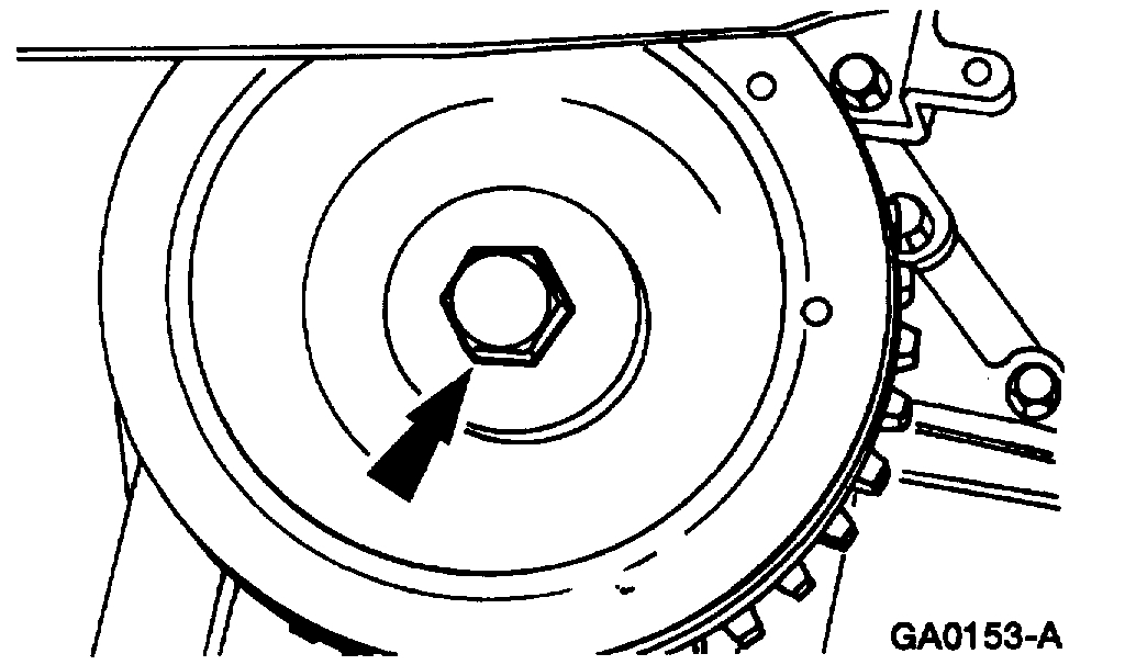

Or, you can check the belt itself. You will need to remove the timing belt cover on the front of the engine. Note that the belt may not actually be broken, but may have jumped time (slipped). If you determine the belt is bad and needs replaced, here are the directions for doing it. All attached pictures correlate with these directions.
Note: the water pump is driven by the timing belt. It may have locked up damaging the belt. Replace the pump when replacing the belt regardless if it appears good.

1. Remove the drive belt and the drive belt tension-er.

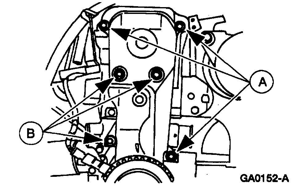

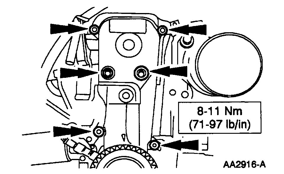

2. Remove the (A) three nuts and the (B) three bolts and remove the outer engine front cover.
3. Raise and support the vehicle.
4. Remove the RH splash shield.

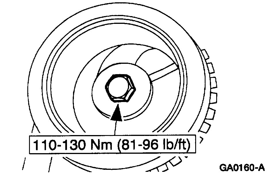

5. Remove the bolt and the crankshaft pulley.

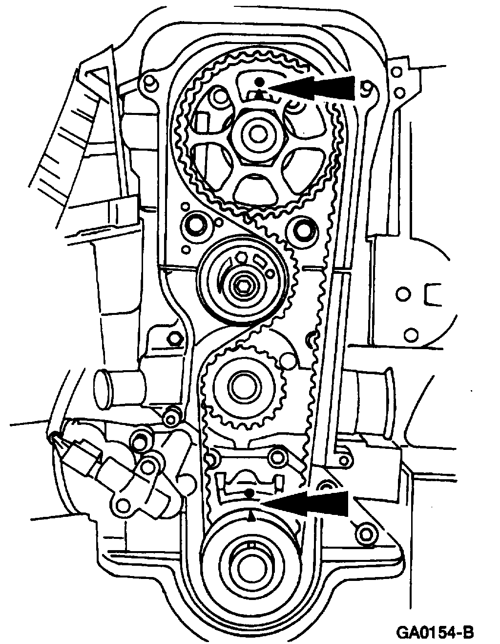

6. Align the timing marks.
7. Remove the timing belt.

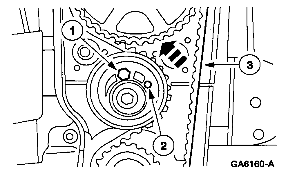

1. Use an 8 mm Allen wrench and turn counterclockwise.
2. Insert a suitable holding tool to lock the timing belt tension-er in place.
3. Remove the timing belt.
8. Inspect the belt for signs of oil contamination.
Installation

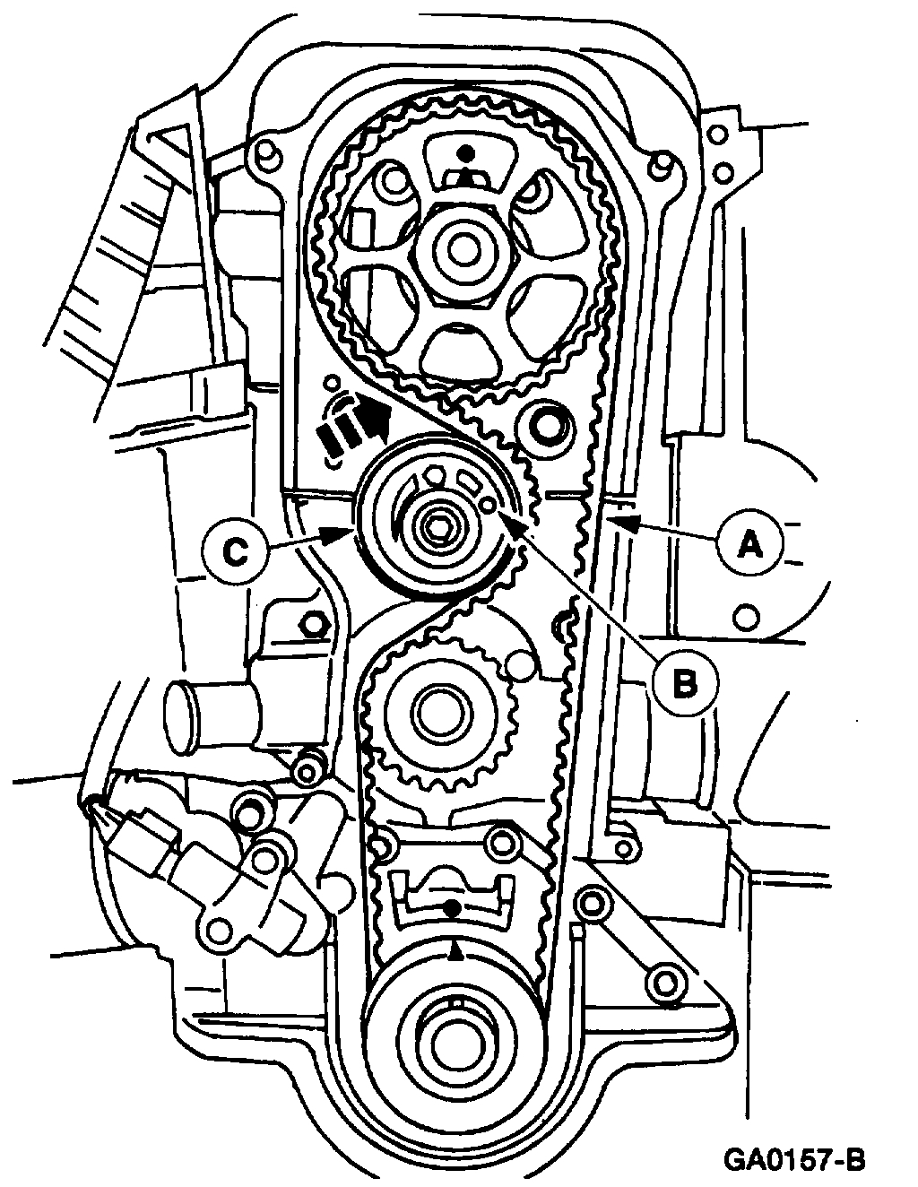

1. Note: Install the timing belt over the sprockets in a counterclockwise direction starting at the crankshaft. Keep the belt span from the crankshaft to the camshaft tight while installing the timing belt over the camshaft.
Install the (A) timing belt and remove the (B) holding tool to release the (C) timing belt tensioner.
2. Rotate crankshaft two times and recheck the timing marks.
3. Install the outer engine front cover.
4. Install the crankshaft pulley.
______________________________________________
