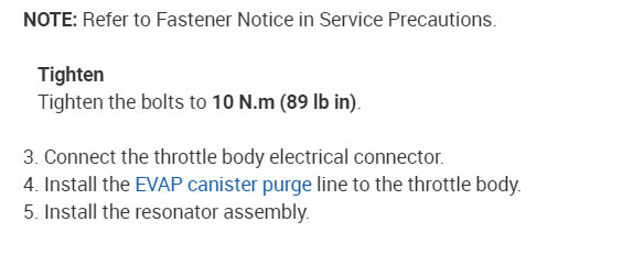

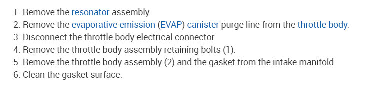

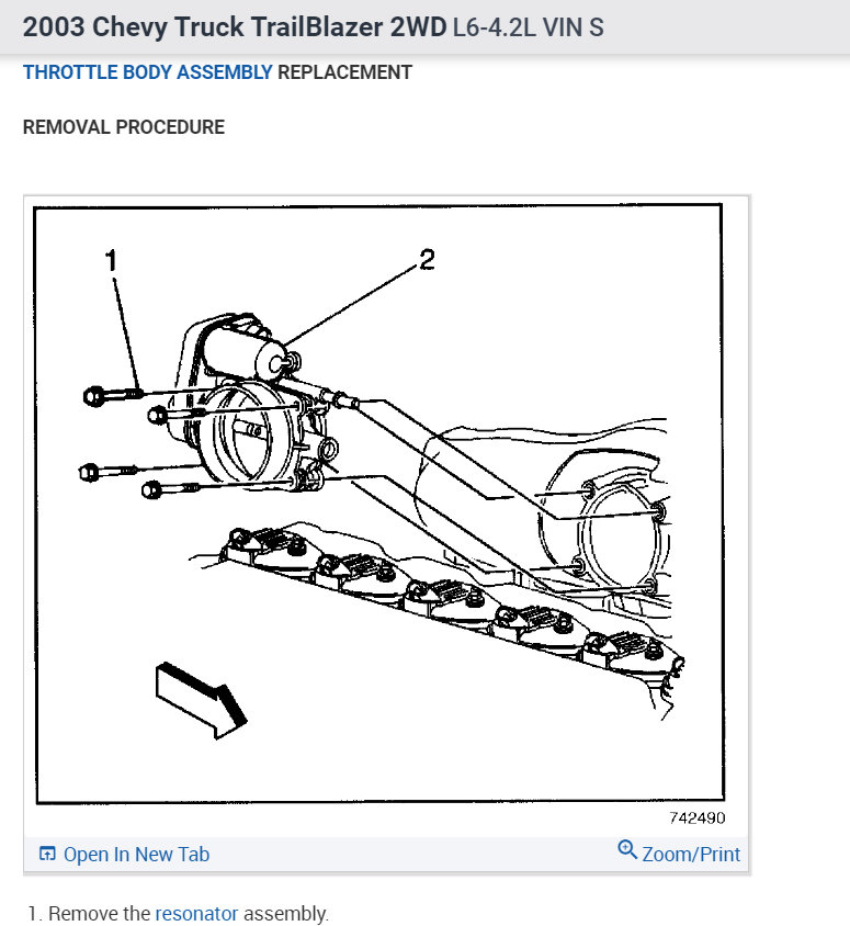

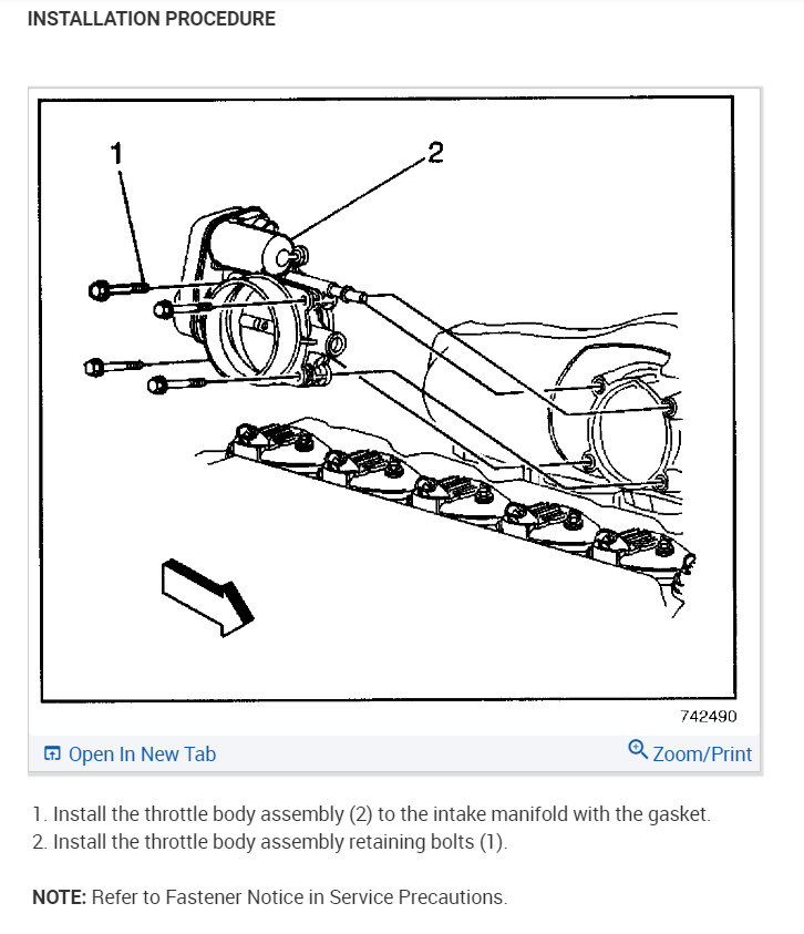

There is no set up required according to the manual which I have left below. Is the part new or used? We need to scan for codes. You can get a code scanner from Amazon for about $20.00.
Here is a guide/video to show you how:
Here is a scanner link:
https://amzn.to/3Qi1SS6
Also remove the electrical connector for inspection and to make sure it is connected fully. Check out the diagrams (below). Please let us know what happens.
Aug 2, 2022 at 1:22 PM
