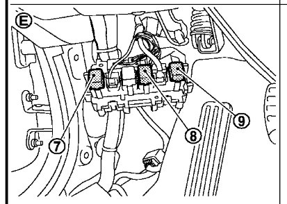

It sounds like the ignition relay #7 has gone bad. but to be sure here is a guide to help with the test and the location of the relay with the wiring diagrams so you can see how the system works:
This guide can help as well
Feb 15, 2019 at 11:02 AM

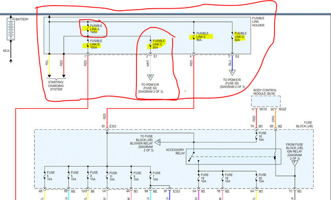

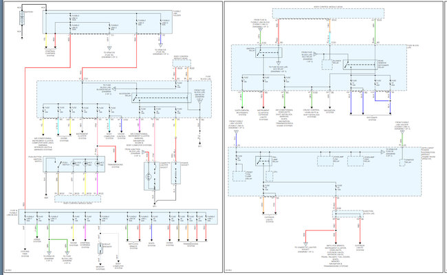

Wow! I never heard of this happening when programming a key. If you lost power to everything, I honestly don't think it's the immobilizer, Yes, it would prevent the engine from starting, but lighting and other things should be working.
First, have you confirmed the battery is fully charged and the terminals are clean and tight? Next, if you look at the pic I attached, it shows that power throughout all systems start a what is called fusible links. A fusible link is basically a wire that works like a traditional fuse. If excessive power flows through this link, internally, the wire will fail to protect the circuits.
To check a fusible link, it can be done two ways in this case. First, see of power is available where the link connects, or you can check the link for continuity.
What I need you to do is to check these links to see if power is making it where it goes. Here are a few links that you may find helpful:
