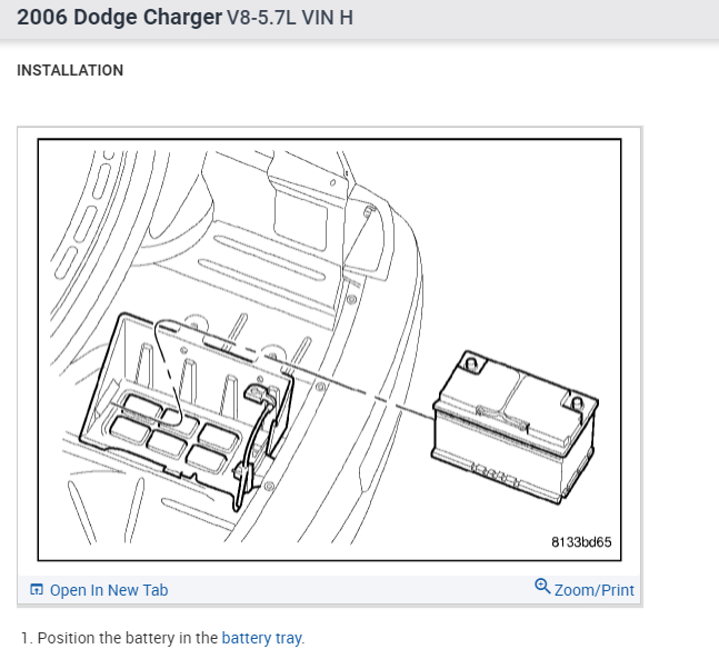

Trying to start my vehicle it just makes a single click then nothing. Occasionally it will attempt to turn over for a brief second then stops. I tested the alternator and replaced the starter (it was bad anyways) but the alternator tested good. The battery still has a charge on it. I do not know what else it could be.

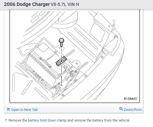

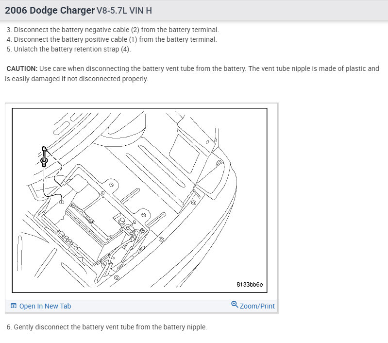

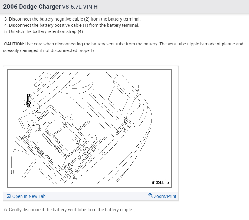

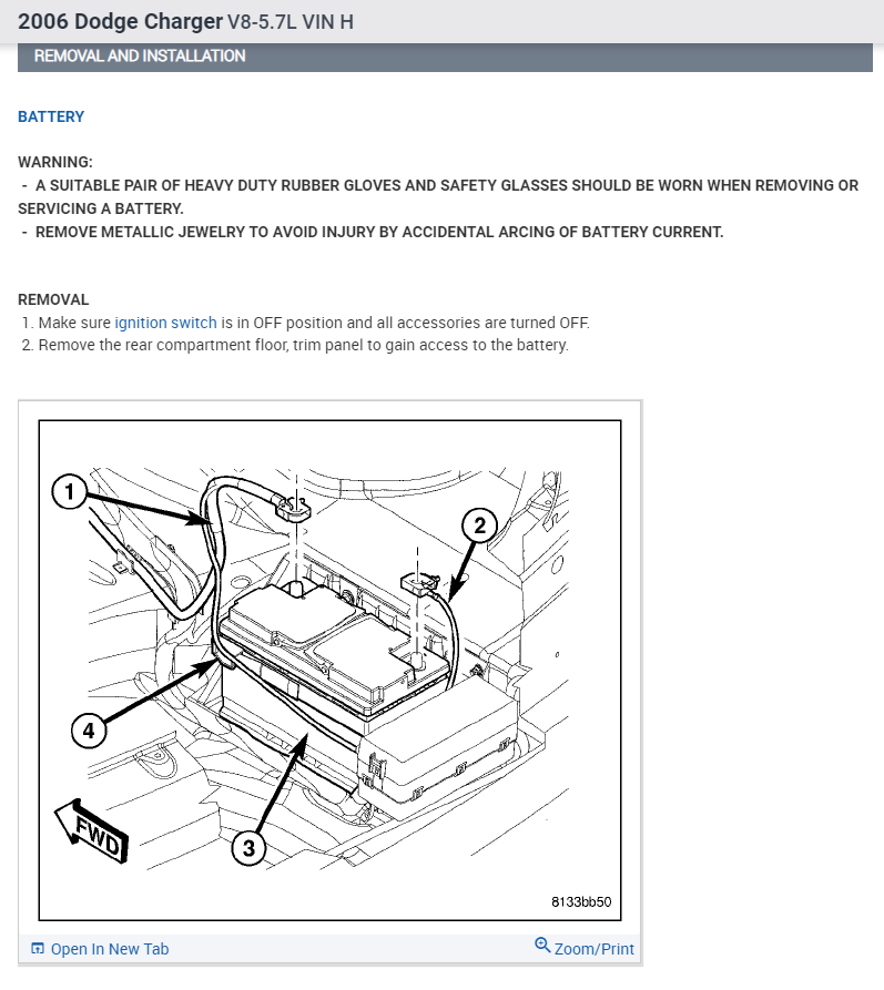

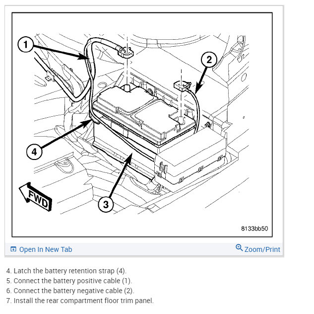

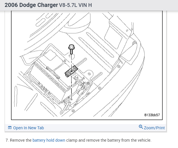

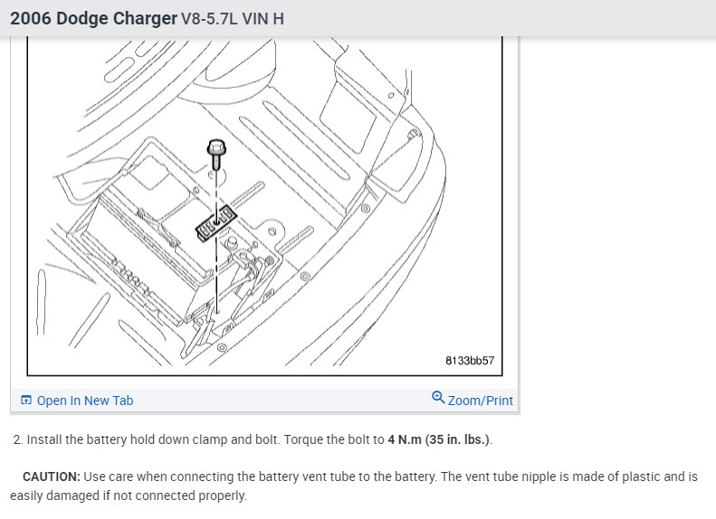

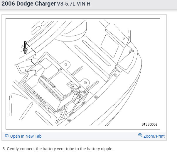

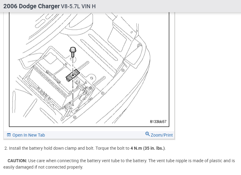

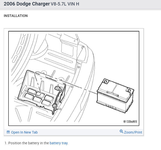

I have attached the battery replacement procedure below.
