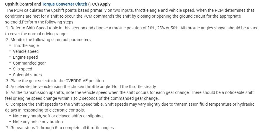

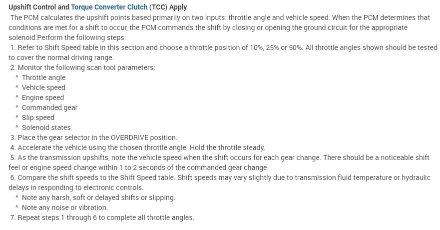

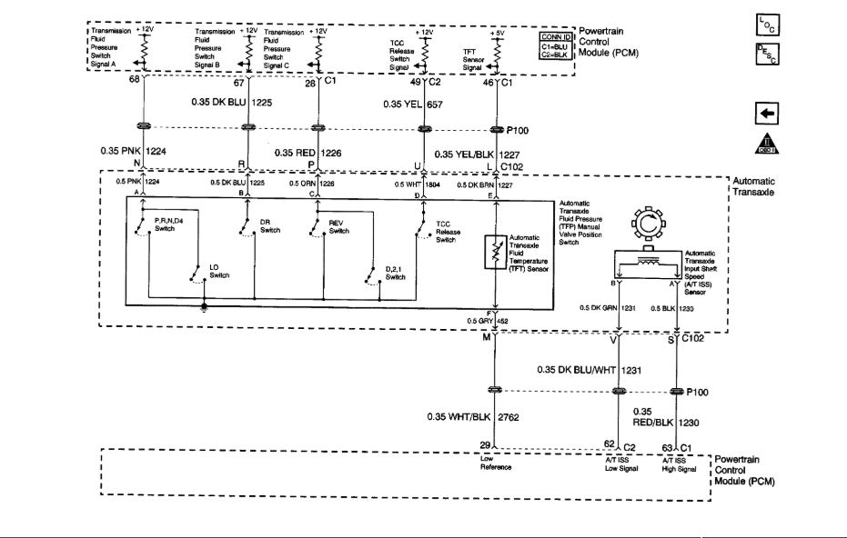

I attached a flow chart and possible issues.

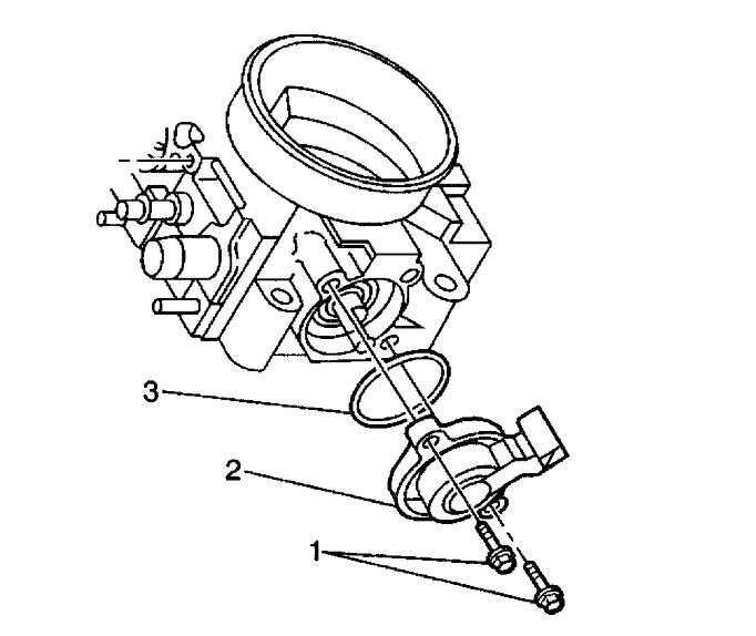

The throttle position sensor is critical in shifting. If the ECM does not see the signal, it will not shift.
Check the voltage with a scan tool to see if there is a signal being sent to the ECM.
