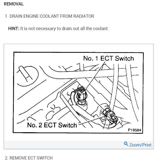

I got my transmission rebuilt two years ago. First year had no problems. Then when I first start the car in the morning and immediately turn on the AC without warming up the engine/transmission problem starts (not often, three or four times in a year). I start driving, car shifts into first and second with ease, then gets stuck on third (around thirty five mph). I am still able to accelerate past thirty five mph, but the tachometer just keeps increasing without shifting into fourth. Then I turn off the AC, turn off car, wait a few minutes, turn car back on without AC and everything goes back to normal. What is the problem? I am lost, what does the transmission have to do with the AC?
This only happens when I first start driving, when engine/transmission are cold and I do not wait to warm up engine and start driving immediately (with AC on:). I live in TX, FYI.

This sounds like you have a engine coolant temperature sensor that is not working right. Here is a guided to help you see what you are in for when changing the sensor with diagrams below to show you how it will be on your car:
https://www.2carpros.com/articles/coolant-temperature-sensor-cts-replacement
This car has two sensors I would do them both.
Check out the diagrams (below). Please let us know what you find.
