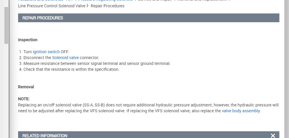

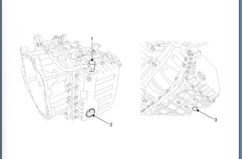

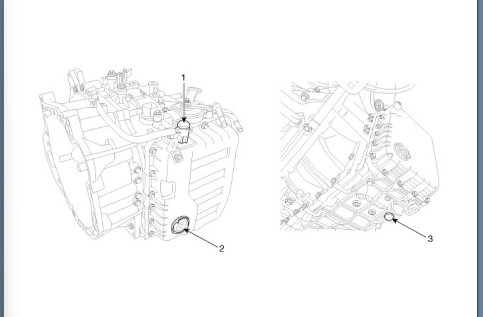

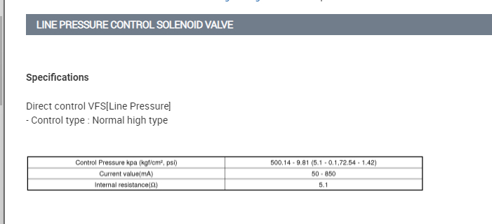

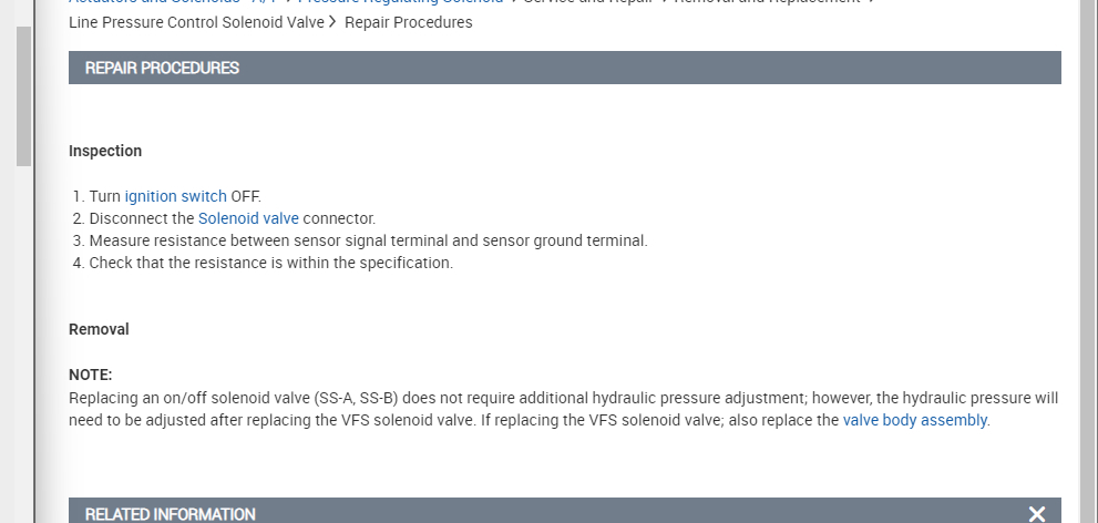

Thanks for covering the basics first so just to confirm, did you drain the fluid into a pan and check for metal in the pan? I know you said it didn't have any, but we just want to make sure this is how you checked it.

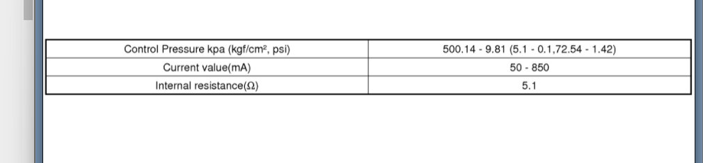

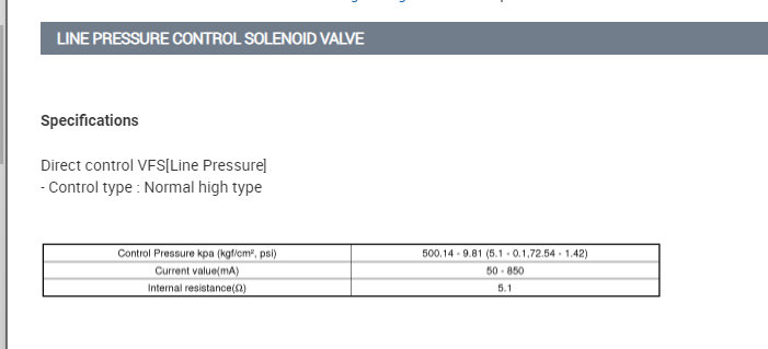

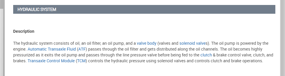

I suspect we have a loss of pressure in forward gears or an issue with the pressure regulating solenoid. I am attaching some info on this below, but I suspect we are going to have to dig into the unit in order to figure this out.
It would be helpful if we can confirm pressures when you are in gear and then in park.
So, let's start with this info and we can go from there.
Thanks

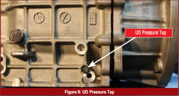

This is what I did: car jacked up and on a cold start, I measured the pressure (using an Engine and Transmission Oil Pressure Test Kit) through the UD tap located next to the drain plug.
- In Park and Rear - No Pressure
- In Drive or Low 1/2 - Pressure spikes to 150+ PSI with a jolt, then drops and maintains to 45 PSI on idle (750 RPMs). TCS and ABS light get on, now only one wheel moving. At RPMs 1,250, it goes to 195 PSI, still one wheel moving. And then further increase in RPMs say 1,500+ the pressure needle moves swiftly between 210 - 240 PSI, still one wheel moving.

This does help. I doubt that a temperature sensor is causing this, but we need to check the codes just to make sure we don't have something to take us in another direction.
As for the pressure, that is exactly what you were supposed to do.
Basically, those pressures are showing that you most likely have a cut seal which is why the pressure is low and then jolts when you put it in gear, and you get the pressure spike.
As for the wheels spinning when on a lift, that is normal for these vehicles. Basically, when there is no load on the transmission the torque goes to one wheel and then it will switch sides easily and it causes it to act crazy.
Lastly, what I meant by digging into the unit means we are looking at a rebuild in order to see what is happening. So, if I am correct with a cut seal then we will find that when the unit is rebuilt.

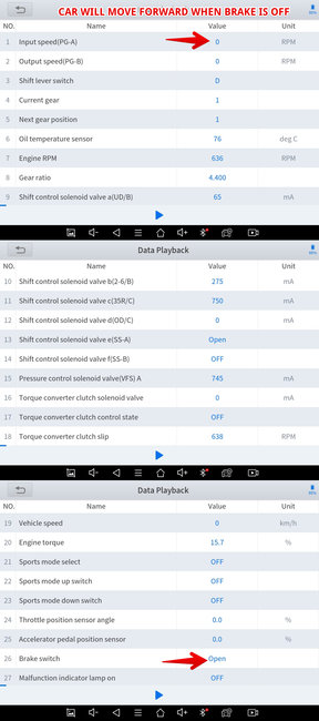

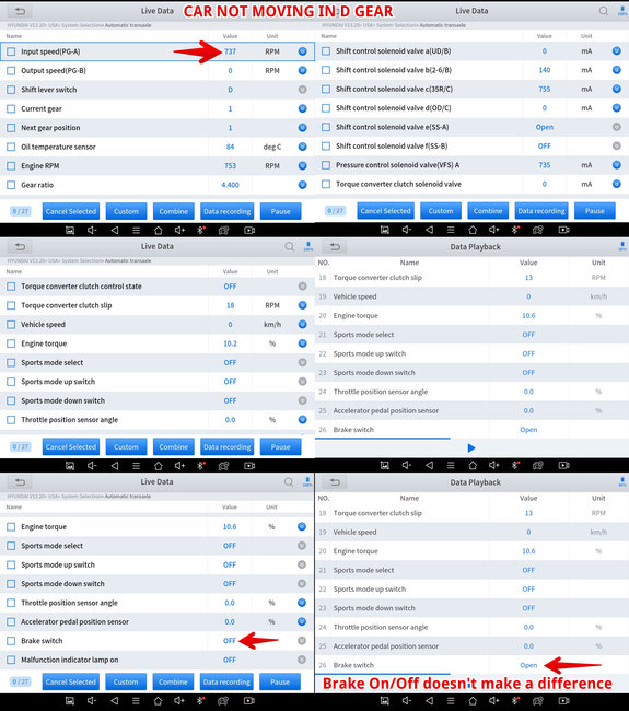

Hi Kenny, I really appreciate your help so far here. I was able to get hold of the advanced diagnostic tool, and I replicated the issue to monitor some TCM params. Here are some more observations or data points for you:
- Issue of "Car not moving forward in Drive gear" is easily replicable at Transmission Oil temperature reading at 85 Celsius. Monitored the temperature reading from cold start to hot, it was going up gradually which means the temperature sensor is good.

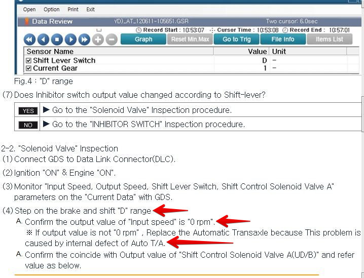

- In Drive gear when the Brakes are on and Input Speed reads 0, the car will move forward when Brake Switch turns off. However, when the Input Speed is not 0, the car won't move forward. Attached also found a picture of diagnostic steps from Hyundai on another forum, stating this condition as Internal Transmission Failure and suggesting replacement.
- When in Drive gear, foot off the brake, and the car doesn't move, the physical pressure reading at UD tap point is 10-15 PSI. Then if I rev up the engine to 1,500 RPMs, the pressure suddenly spikes to 75-90 PSI, the car will jolt forward and come back to normal forward motion.
- Attaching both, when the car moves forward and when it doesn't, snapshots of the diagnostic record.
I understand at this point I definitely have to look inside the transmission, but just wondering if you can pinpoint me specifics on what I should be looking for damage and repairing. Maybe some video or guide links will help. Thanks again.
Mar 2, 2022 at 11:47 AM
Okay. This is good.
I am suspecting you are getting more confirmation that the internal issue is the direction we need to go.

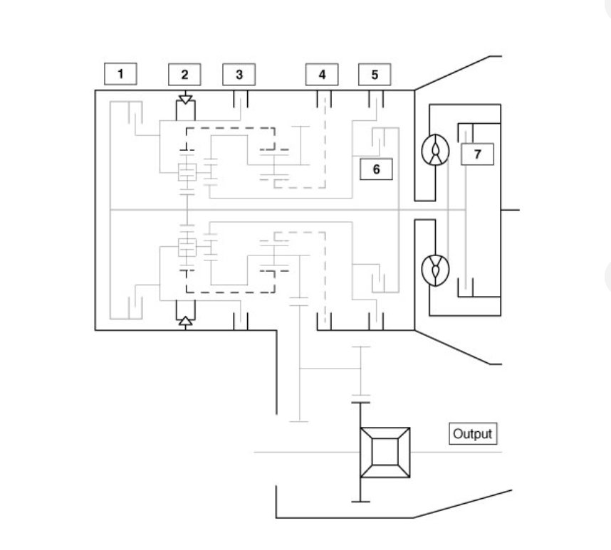

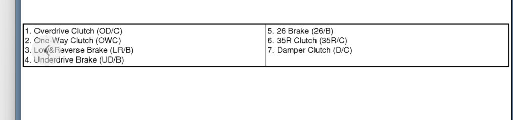

So, from what I am seeing and mostly because of when you accelerate and raise the speed at which the pump is turning and this increases pressure in the unit that it only then engages, and it jerks points to either a torque converter issue or a leak in the under drive is leaking causing pressure to escape and then once it is high enough it sells and bangs into gear.

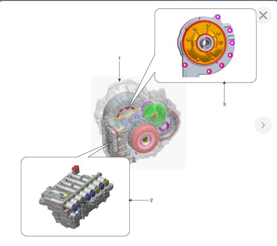

So, if it were me, I would get a complete rebuild kit and go through the entire transmission and replace the converter and pump while you are there.

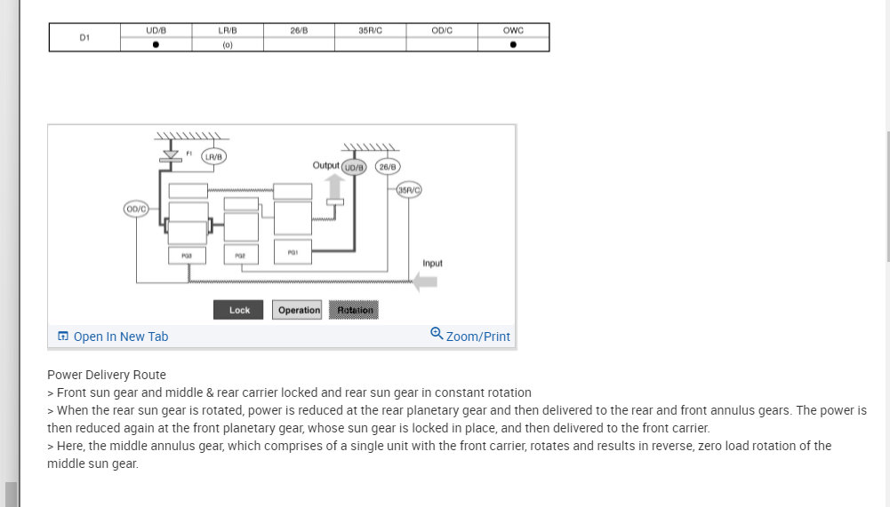

I attached the info below, but the last page is a power flow showing in D the pressure goes through the underdrive and the one-way clutch.
