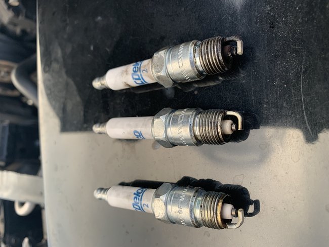

I found the problem. Did a compression test. In the picture are #1, #2 and #4 spark plugs.
#1 pressure was 105.
#2 had none whatsoever. Even after pouring a teaspoon of oil in it.
#4 had 125 lbs of pressure.
So. Burnt valve. Time to rebuild it.
Thank you both for your time, Ken and Dave.
