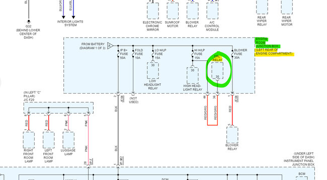

Okay, the car will crank and go but as long as I'm moving in drive none of the lights work. (Headlights, brake lights, taillights etc.) Now if I turn the headlights on before I put it in drive the car won't move, as if it is in neutral. Now reverse works with or without the lights. Can someone please help?

That is a good one alright, is the check engine light on? We need to run the codes to confirm the problem, it sounds like it could be a BCM that is out. You can get a CAN scanner (Controller Area Network) from Amazon from about $32.00.

From some extra research on this issue because it's definitely the weird one for the month, one suggestion for a temporary fix was to remove the DRL Relay (daytime running lights). It might be something having to do with the headlight switch, brake lamp circuit because it's tied into the transmission control module, or some module needing an update or has failed. Do any lights work if turned on after you're in Drive? These cars have a lot of electrical issues. But try removing the relay to see if you can at least get your brake lights working. Because that's a safety issue there.

Hello, I was just curious, does your check engine light come on when you turn the key to the on position and then go off? Or are all the lights on the Instrument Cluster out as well? I'm still going over this one because it's such a strange case study and multiple people are working on it now.

Okay, sorry to hear that. If the vehicle ends up having any transmission diagnostic trouble codes stored these are known for issues on the short sections of the transmission wiring harness that go to the valve body. The solder joints crack and the connections fail. They can cause all kinds of electrical issues. How it might be related to the exterior lighting, I don't know, it can be some type of electrical load and multiple faults at once. But if they can get some type of scan for trouble codes on the vehicle, it might give some direction.
