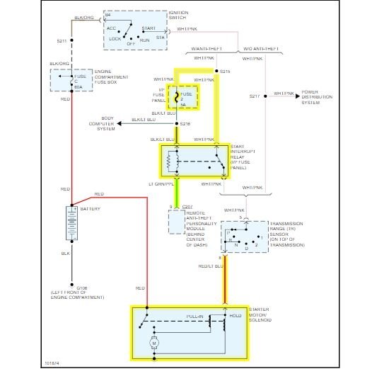

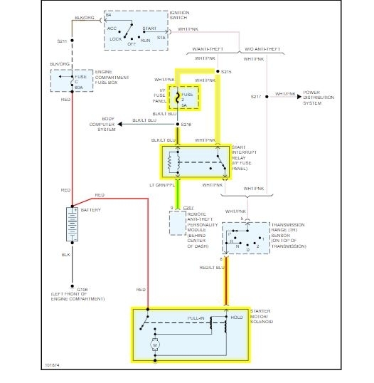

Good afternoon,
I attached a diagram for the starting system. Test for power at the small wire on the solenoid with the key in the start position.
Let us start there.
I am also concerned about the motor. Can you turn it by hand to be sure the motor is not locked up?
