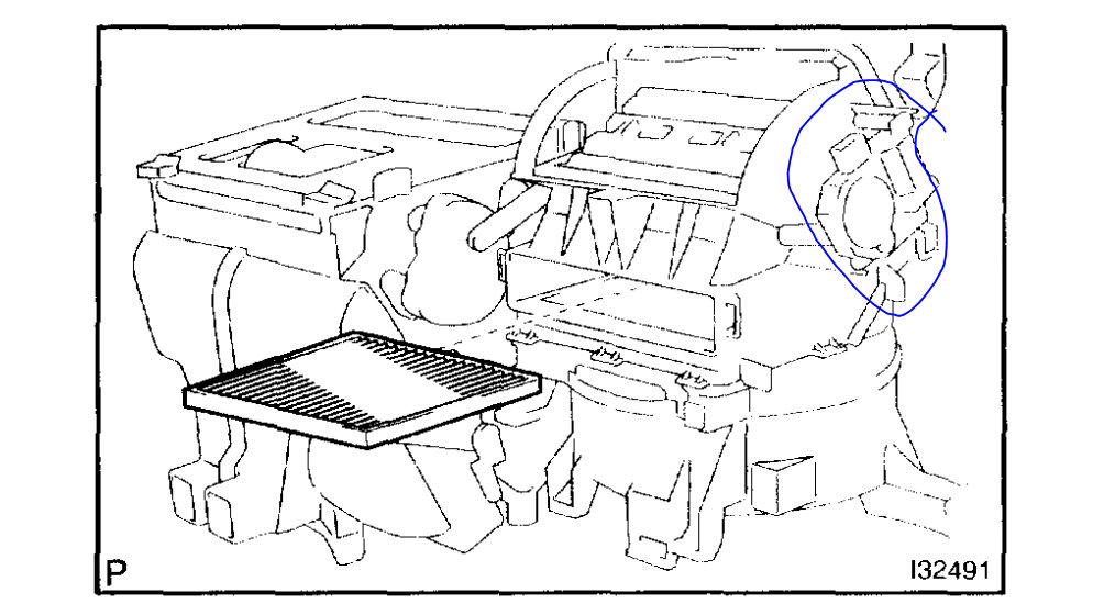

Also, when command heat and cold, can you hear the mode door moving back and forth in the dash?

Thanks for the speedy reply! I have called all our part stores where I live and none of them rent unfortunately. Is there a way I can check my refrigerant in my vehicle? When I engage AC button, there is light at the button but I don't hear a difference. When you mentioned hot and cold command. Do you mean when I engage AC? Or when I turn the dial from hot to cold. Lots of air blowing out vents so I didn't think it was any sort or blower issue. I really did assume my relay was bad seeing that the AC was so good last year. But unfortunately not this time. Is there anything else I can check or do without those gauges? Otherwise I may have to buy a set.
Saturday, June 29th, 2019 AT 12:03 PM
  • 52,797 POSTS
Turning the dial.

I checked the dial. I can hear it switch and feel the difference in hot and cold air. Don't have Harbor Freight in Canada, but I will try and source some somewhere.

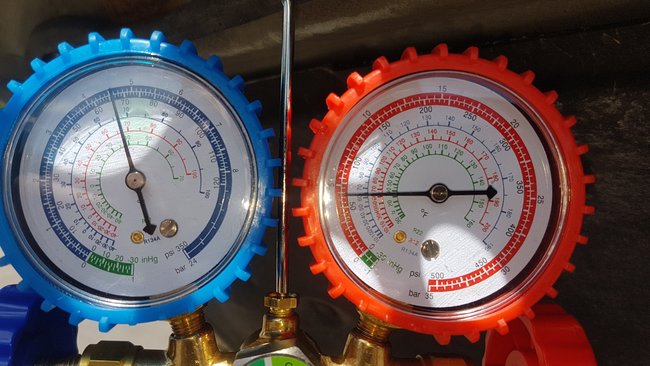

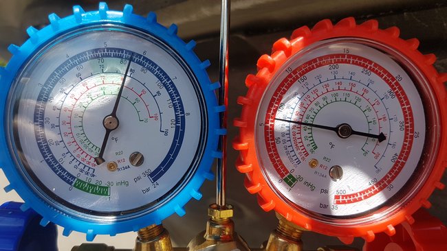

BDHAMILTON
  • 7 POSTS
Did my measurement. I will post pictures here. There is a picture with engine off and engine on warm with AC full blast.
Sunday, June 30th, 2019 AT 10:01 AM
  • 52,797 POSTS
Was the compressor on when the engine was running? The fact the pressures are the same tells me the compressor is no good as it is not building any pressure.
Sunday, June 30th, 2019 AT 10:04 AM
BDHAMILTON
  • 7 POSTS
Compressor was runing. Seems like the low side went up and high stayed about the same. Is there a beat practices way to conduct the test?
Sunday, June 30th, 2019 AT 10:10 AM
  • 52,797 POSTS
You have done the test. If the compressor was running and those were the pressures, then the compressor is bad.
