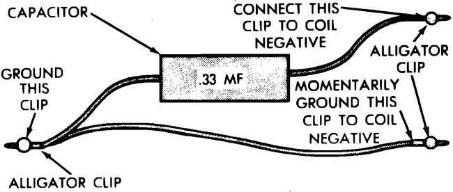

Do me a favor, try this test and let me know what you find. The picture attached correlates with the test.
________________________________________________
1989 Plymouth Acclaim V6-181 3.0L SOHC
With Powertrain Control Module (PCM)
Vehicle Powertrain Management Computers and Control Systems Testing and Inspection Symptom Related Diagnostic Procedures No Start Test No Start (NS) Tests Ignition System No Start Test With Powertrain Control Module (PCM)
WITH POWERTRAIN CONTROL MODULE (PCM)
Fig. 2 Coil negative terminal jumper wire
Before proceeding with this test, perform "Ignition System Starting Test." Failure to do so may lead to unnecessary diagnostic time and incorrect test results.
1. Measure battery voltage using a suitable voltmeter. Battery voltage must be at least 12.4 volts to deliver the necessary voltage to operate the cranking and ignition system properly.
2. Crank engine for five seconds while noting voltage at coil (+) terminal.
3. If voltage does not remain near battery voltage during cranking, problem is contained within the SBEC engine electronics. Refer to the appropriate chapter in the "Fuel Injection Section" for diagnosis.
4. If voltage remains near battery voltage during cranking, turn ignition Off and disconnect 60-way electrical connector, from SBEC and inspect connector for any loose terminals.
5. Remove coil (+) lead, then connect suitable jumper wire between battery (+) and coil (+) terminals.
6. Momentarily ground terminal 19 of 14-way connector using a suitable jumper wire, Fig. 2. A spark should be present when ground is removed.
7. If a spark is present, replace SBEC. If spark is not present, use special jumper to directly ground coil (-) terminal.
8. If spark is present, locate and repair open in wiring harness. If spark is not present, replace ignition coil.
Also, let me know if you tried to get diagnostic trouble codes following the link above.

when I perform this test, is the connector to the SMEC connected or disconnected to the SMEC once I have located pin 19 and does the ignition key position involved in this test?

Key on and disconnected.

Today I had more time to spend on the Acclaim. I process to start the you have requested, I had removed the 60 plug connector and found very odd the 19th pin was recessed in the connector. Once I tried to attach the connector to the SMEC the pin would not seat in it port. I push it in with needle nose pliers and the vehicle started right way. To correct the pin from falling out, the casing to the SMEC has a inch wide plastic guard for the wire harness so I drilled two holes and secured the harness with a zip-ty so it won't move and keep the pin in place.
Thanks again for the help and saving me the time from wasting it on the fuel system.
