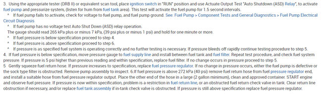

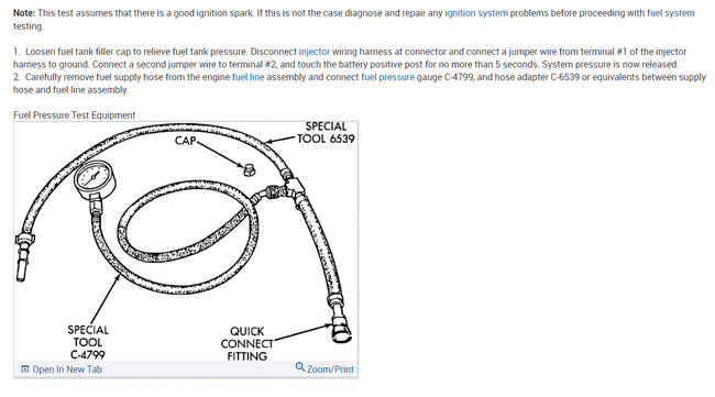

If there are no codes, what I need you to do is check fuel pressure. It isn't hard to do. You will need a fuel pressure gauge, but most parts stores will lend one to you.
Here is a link that shows in general how the procedure is done:

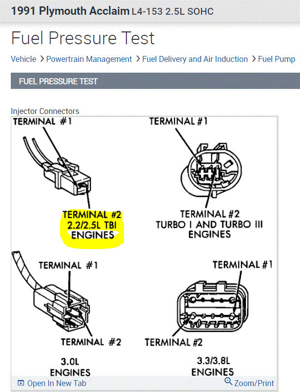

If you look at the attachments below, I included the directions specific to your vehicle. I assume this isn't turbocharged, so I highlighted the connector relevant to you in pic 1. Also, the manufacturer's pressure specifications are included in the directions.

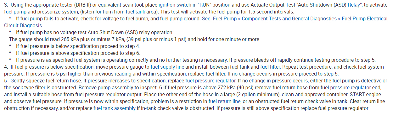

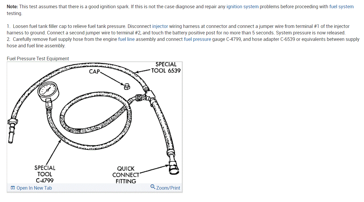

Here is the information you requested. I would suggest performing a fuel pressure test. You might have a weak or failing fuel pump that is not providing proper fuel pressure. Here is a tutorial showing how to perform a fuel pressure test on an in-tank electric fuel pump:
If you don't have access to a fuel pressure tester most auto parts stores have a tool loaner program and can rent you one. After performing this pressure test get back to us with the results and we'll go from there. The fuel pressure specification on your Acclaim is 38-40 PSI with key on-engine off. Hope this helps and thanks for using 2CarPros.
