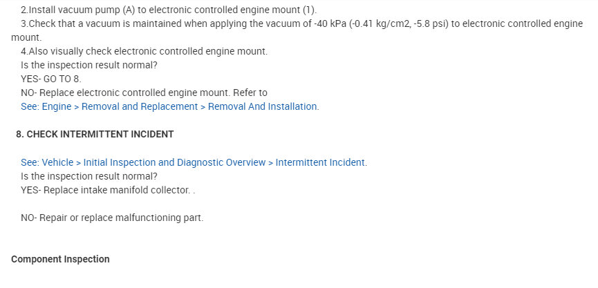

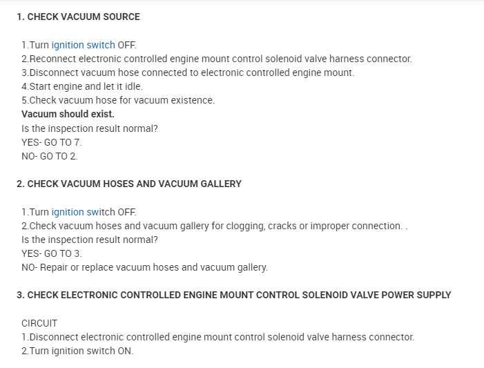

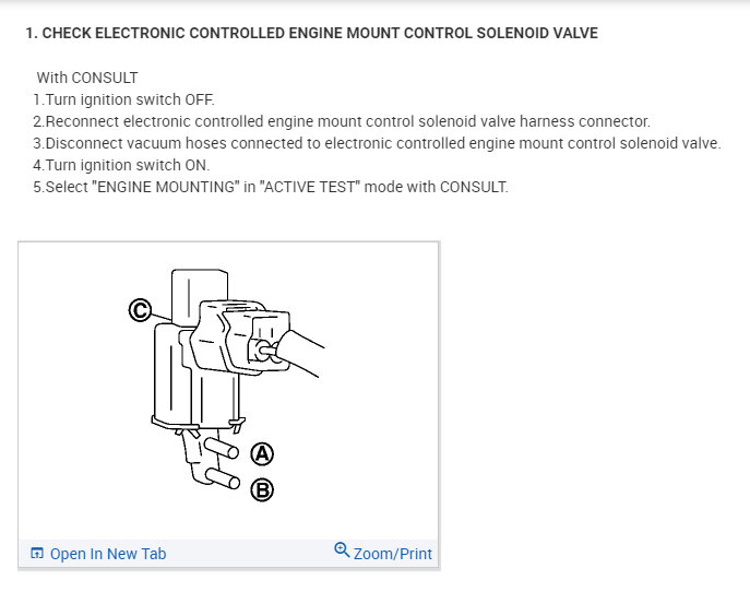

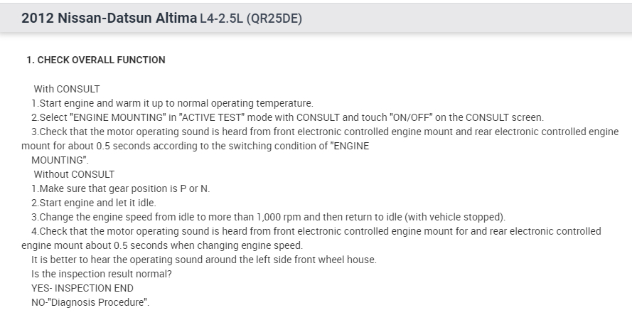

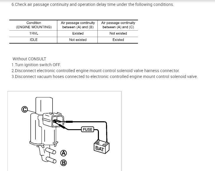

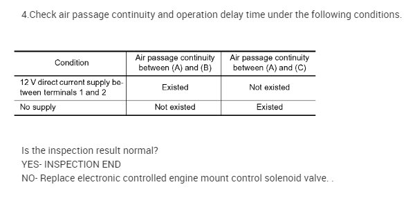

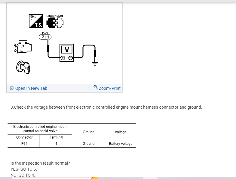

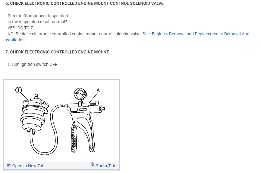

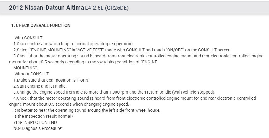

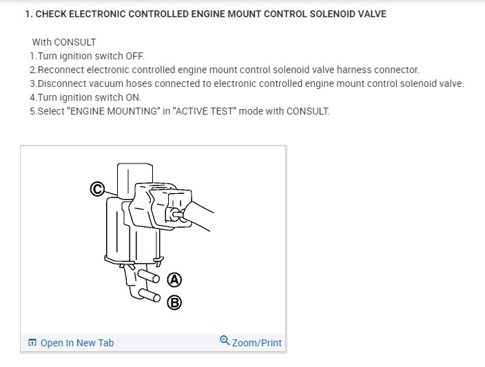

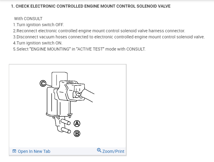

As far as the engine mounts, yep, they can set a code. The vehicle has electronically controlled motor mounts. The mounts are both electrical and vacuum operated.
Is it possible for you to ask for the code that was set? Also, keep in mind that the mounts' vacuum supply between the intake manifold and the electronically controlled engine mount may be faulty causing an engine vacuum leak and rendering the mounts inoperative.
If you can, let us know the codes. If he no longer has it or them, you really should have the can-bus scanned for codes.

  • 110,194 POSTS

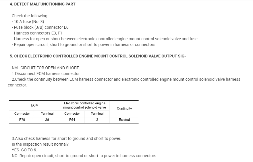

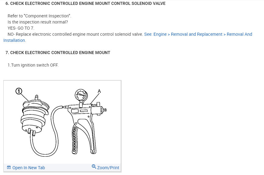

That makes sense. When you place the vehicle in drive, the engine torques in one direction against a specific mount. When in reverse, it goes the opposite way onto a different mount. I have a feeling that is the issue.
I don't know if you want it, but I attached the diagnostics below for this circuit.
Let me know if I can help. If you have a chance, let me know what is found.

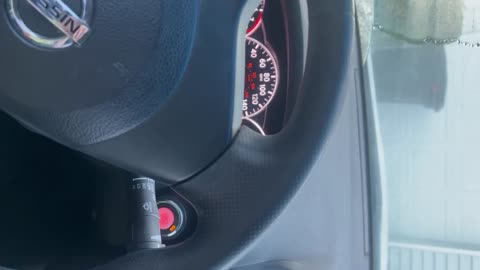

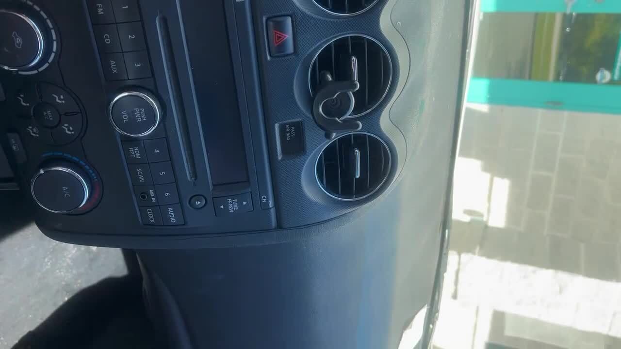

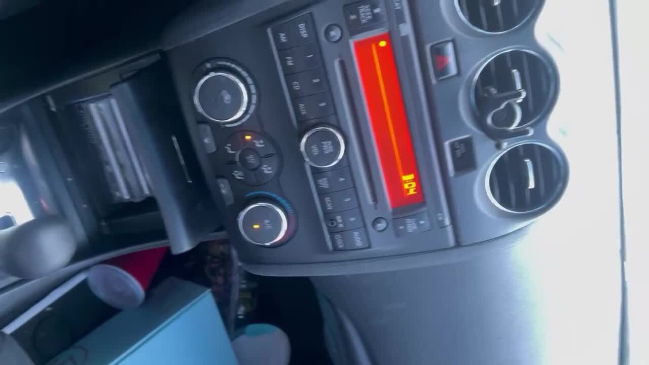

Hey guys. Just dropped the car off at the shop again, the ac is now not blowing as cool and makes a rattling noise when turned on and remaining on. This didn’t happen before. The vibrating/shaking in idle and reverse is not as prominent as it was prior to the ac no longer working, but still there. When I dropped it off, the owner of the shop said to me “we didn’t realize it was a shaking in the dash, we thought it was from the engine which is why we were going crazy with motor mounts.” I’ve told him the entire time the vibration is felt from the dash and in my steering wheel and gear shift and seat, the entire front of the car. Even my passenger in the back seat felt the vibration. I’m just incredibly frustrated and losing faith in them. If the problem is not resolved this time, I’ll be taking it elsewhere. I told them to run codes and check everything. My A/C compressor is only 1.5 years old, so hopefully not that. I attached video of the vibration prior to the ac not working as well and the weird rattling sound I can now hear when ac is on.

MBLUNCK
  • 6 POSTS
You can also hear that weird rumble when you turn the A/C off now. I have no idea.
