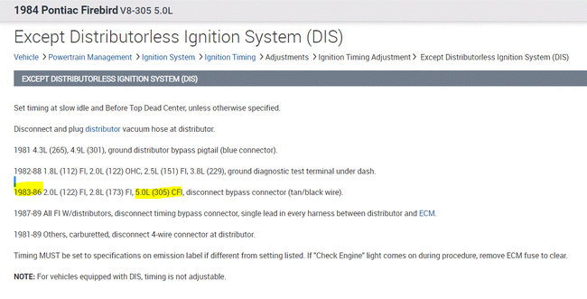

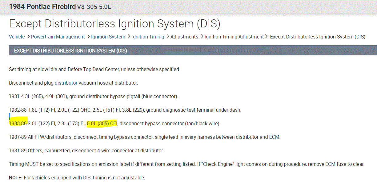

smog tech disconnected the 4 wire connector to my distributor and said he had to to test the timing and ran my engine "My shop manual says "not" to disconnect the 4 wire connector and to disconnect the single wire connector that comes out the wiring harness. Well since the smog tech did that my car doesn't drive pass 45 mph now. Why?
Dec 2, 2020 at 7:32 PM
  • 110,194 POSTS
If it is a fuel-injected vehicle, only one wire is disconnected. If it is carburated, then a 4 pin connector gets disconnected. See attached pic 1
Do me a favor. This has an OBD1 diagnostic system that doesn't require a scan tool to retrieve diagnostic trouble codes. All you need is a short jumper wire or even a paper clip.
Follow this link and let me know if any codes are present:
https://www.2carpros.com/articles/buick-cadillac-chevy-gmc-oldsmobile-pontiac-gm-1983-1995-obd1-code-definitions-and-retrieval-method

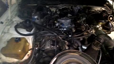

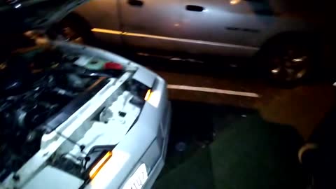

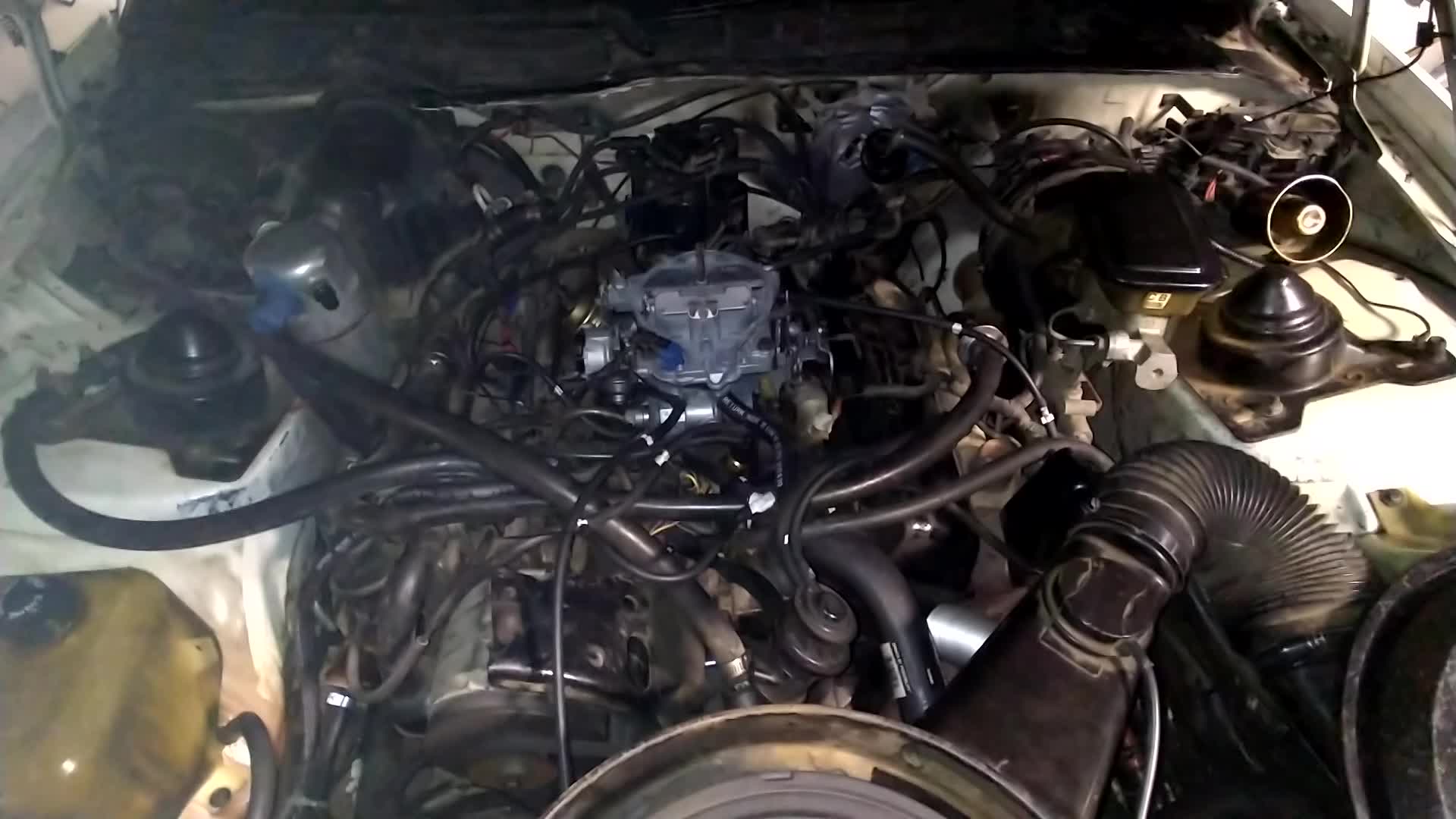

This is his wife. I'm not sure if he did what you asked, but this is what it looks and sounds like. he just put on a new carburetor.
Dec 5, 2020 at 5:48 PM
  • 110,194 POSTS
Has the new carburetor eliminated the stalling issues? Also, what is that clicking sound I'm hearing? Is that one of belt-driven accessories or is it coming from the engine? It almost sounds like it could be timing chain slap. If you place a timing light on it, does it stay consistent or is timing jumping around?

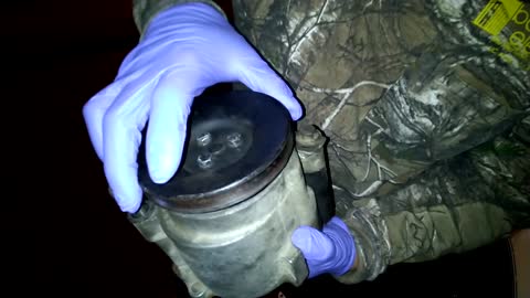

I removed the belt off of the secondary air injection pump. And then I turned on the engine. The rattling noise disappeared. The carburetor did not fix the stalling I think because of the secondary air injection pump. since I put on the carburetor it feels like the car wants to go but it won't go past 20 MPH.
Dec 7, 2020 at 3:22 AM
  • 110,194 POSTS

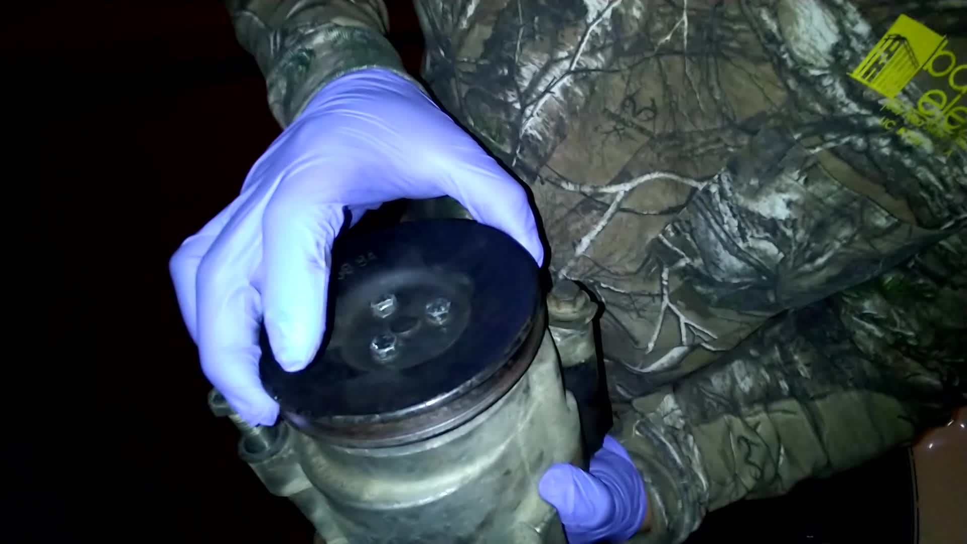

Is it possible for you to record what is happening and upload it for me to hear? Also, check the pulley on the air pump. I just found a technical service bulleting (TSB) related to the noise. The bolts on the pulley can get elongated and cause the problem.
Dec 7, 2020 at 6:25 PM
NAEB83
  • 11 POSTS
Yeah, I took off the secondary air injection pump I wiggled around the the pulley and it seems that the secondary air injection pump is loose and it's shaky.
Dec 7, 2020 at 7:03 PM
NAEB83
  • 11 POSTS
Secondary air injection pump.
Dec 7, 2020 at 9:05 PM
NAEB83
  • 11 POSTS
Engine.
Dec 7, 2020 at 9:07 PM
  • 110,194 POSTS
The pump needs to be replaced. What is happening when it refuses to go over 20 MPH? Can you make a video of that so I can see and hear it?

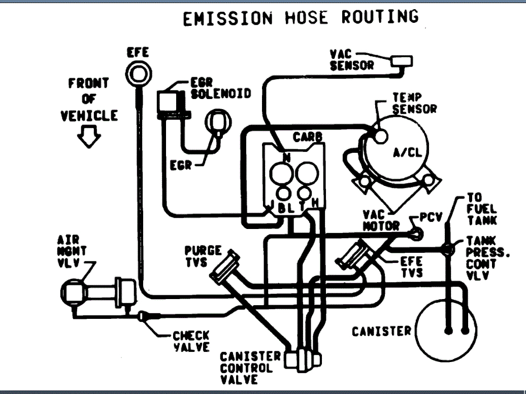

I'll take a video of the car and how it runs after I install the new secondary air injection pump

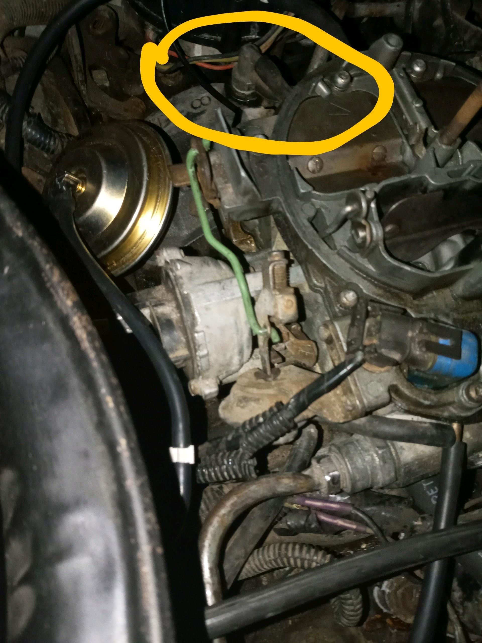

This picture that I'm sending you with the yellow circle circling around that ported valve towards the back of the firewall into the manifold I don't know what it connects to. do you know by any chance?
Dec 10, 2020 at 4:22 AM
  • 110,194 POSTS
It's been a while. LOL I see the hoses. Can you follow them? There was a thermal vacuum control valve that ran to the intake and was designed to prevent the EGR from opening when the engine was cold (below 60°F if I recall). It would block vacuum to the EGR until the temperature was reached.
See if you can follow it to any point. If you look at the attached pic, it shows the EVAP system vacuum schematic. See if that helps.
