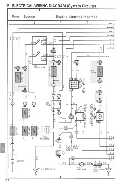

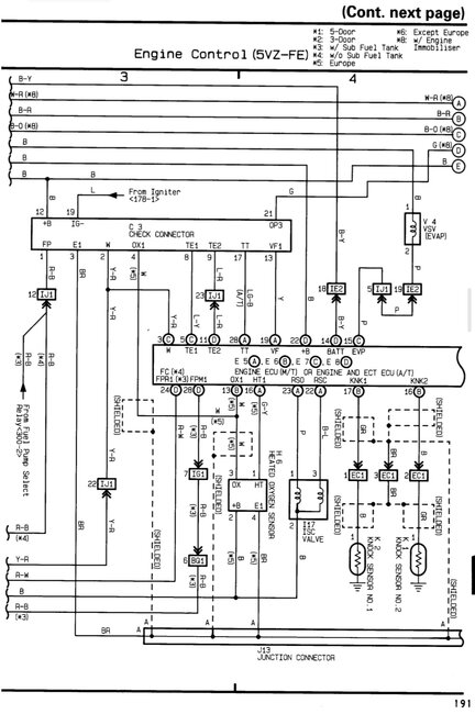

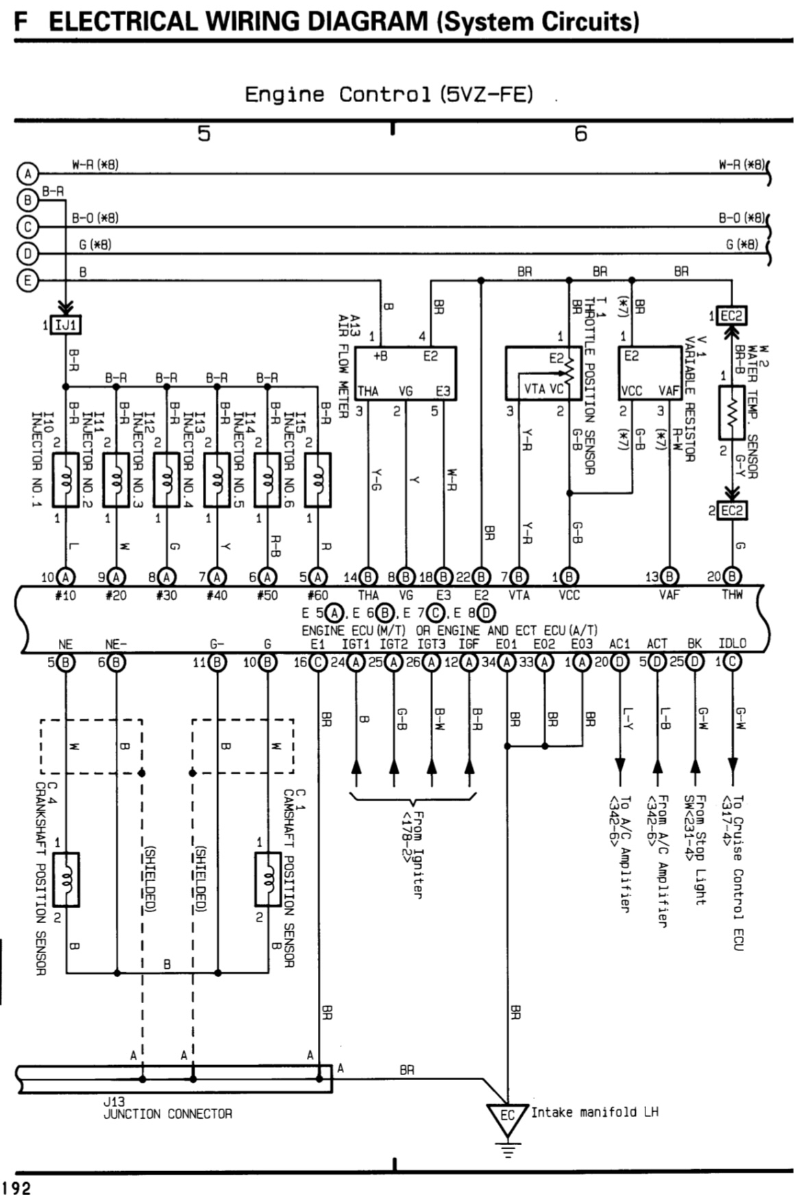

Found the circuit diagrams online.
(http://htftp.offroadsz.com/marinhaker/programi/VSI4KO%20ZA%20TOYO/Land_Cruiser_1996_Electrical_Wiring_Diagram1.pdf - model 5VZ-FE)
But kind of tough to follow for a non-pro. Any ideas what we could do to help ourselves? Do you understand which components are part of the circuit? Those would be easier to find for us than understanding the wiring diagram. :)

We need to get this fixed for you. I looked at the wiring schematic you sent. Unfortunately, I can't read the writing. It is too blurry.
Can you take a pic of the wire that was replaced? Also, check where the new wire is connected to make sure there is a good connection and that the wire it connects to appears to be of the same gauge.
Also, check the connectors at the fuel injectors. Make sure they are tight as well. If I had to guess, and keep in mind, this is a theory, I suspect the power supply to the injectors is spliced at one point. That is normally what I see. You have one wire from the fuse, and it splices into several wires for each injector. I have a feeling that it wasn't repaired correctly.
If possible, take a few pics of what you are dealing with. Hopefully, it will help me.

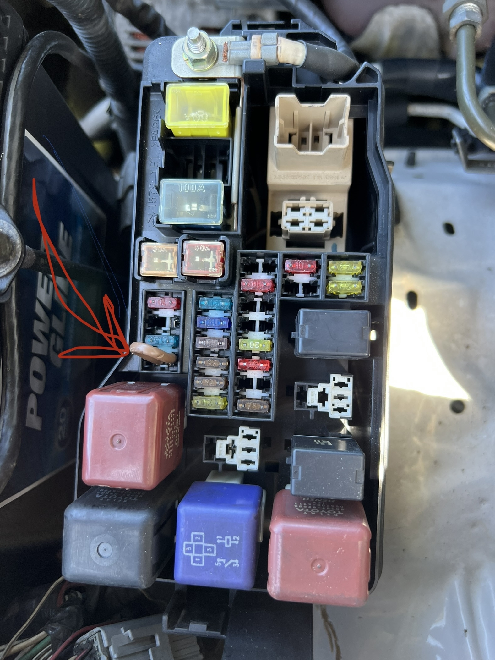

Maybe there was a misunderstanding, just to clarify: there was a wire in the fuse box instead of a fuse, put by the previous owner, probably to bypass the car stalling as it will take more heat (?). I have attached a picture of the wire. So, there wasn’t, to my knowledge and what I can see, any bad repair that could cause the trouble.
A mechanic will replace the fuse holder today, maybe that helps. If not, we will try to check the connectors going to the injectors. Unfortunately, the fuel pumps are in the tanks so that’s not that easy. Any other connections to components that you suspect?

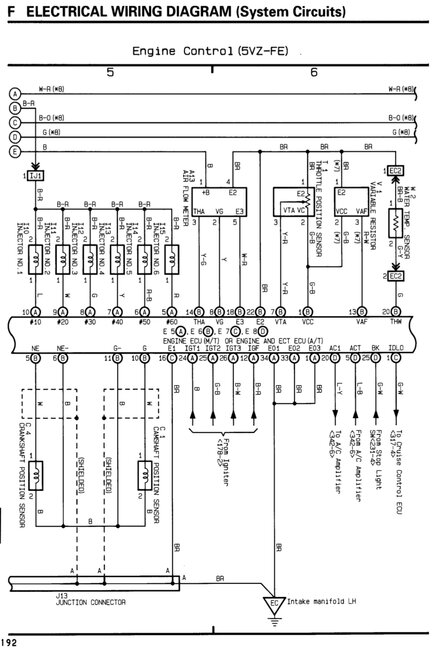

I have also attached the circuit in better quality hopefully.

Wow! You are lucky it didn't catch fire. A fuse is designed to fail when a certain amount of voltage/amperage is exceeded. It does that to prevent wiring from melting down due to excessive power draw.
Placing a wire in there jumped the fuse and took away all protection. Remove that wire. That is why the box melted. Excessive voltage draw.
Replacing the box will help. Tell him to replace the wire with the proper fuse. Hopefully, it won't fail. If it does, then we have a short and it needs attention. Don't put another wire in place of the fuse. That is a disaster waiting to happen.
