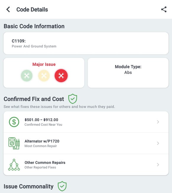

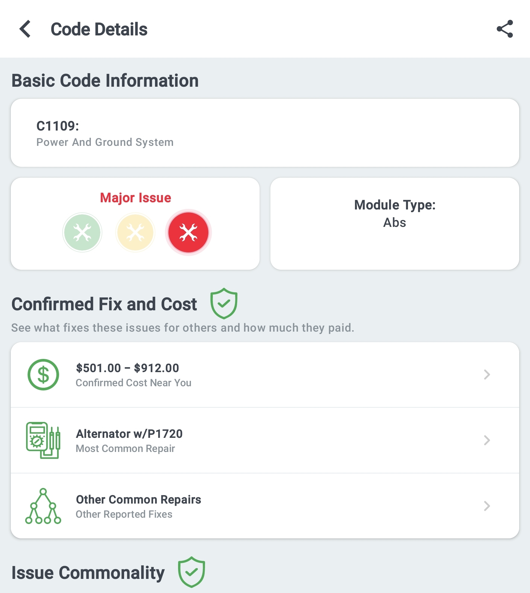

Jun 29, 2023 at 12:40 AM
JADEASHLEY531
  • 8 POSTS
I haven't done the live yet, but a code showed up not sure if that would be my issue or not.
Jun 29, 2023 at 1:49 AM
MATHGEN
  • 128 POSTS
That code refers to a power issue in the ABS module. That should not cause your issue. If the ABS warning light is not staying on, then I would just clear that code and retest. It could have been stored at some time in the past.

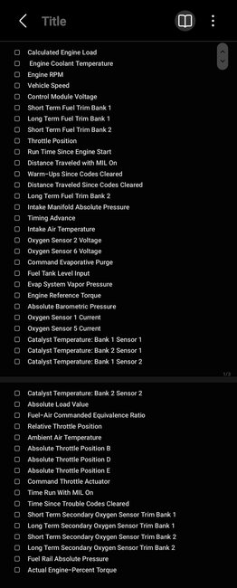

No news, I can't find the data you told me to watch on the live these are my options for live.
Jul 1, 2023 at 1:58 PM
MATHGEN
  • 128 POSTS
Well, without seeing all of the sensor data, I can only go by the symptom. The only other thing I can suggest at this time would be to have the transmission fluid and filter replaced. Dirty or contaminated fluid could cause a control valve in the valve body to stick.
