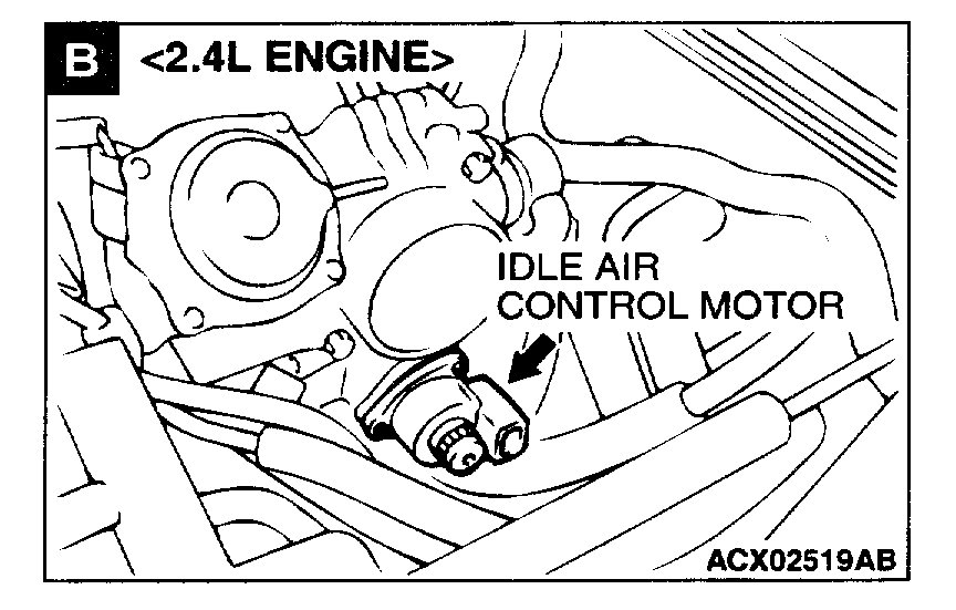

Here are directions for testing the idle air control valve. It is responsible for maintaining engine idle speed. The directions are extensive and require use of a multi-meter and basic understanding of testing wiring. Before performing the test, remove the IAC, located on the throttle body (see pic 1) and make sure there isn't dirt or corrosion on the portion that goes into the throttle body or in the throttle body where it mounts. If there is, clean and reinstall and test.

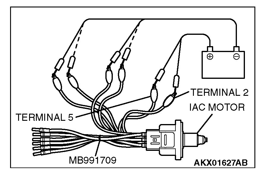

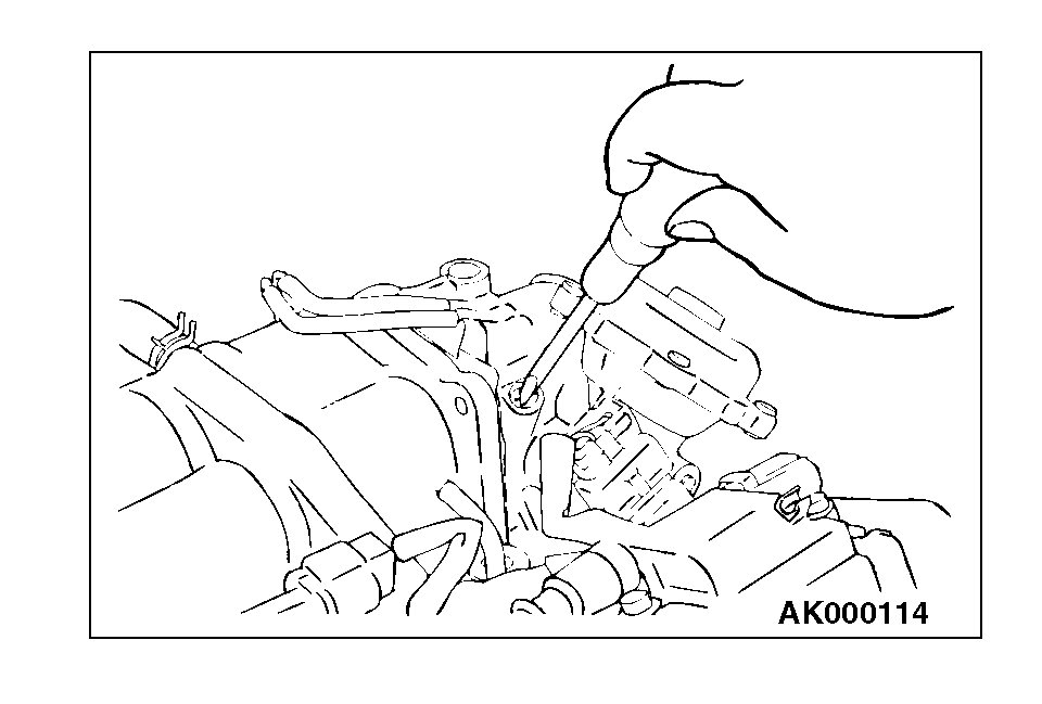

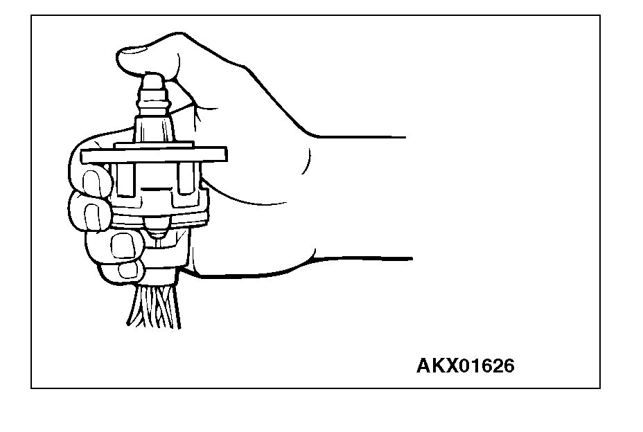

Testing (see pics 2-4)

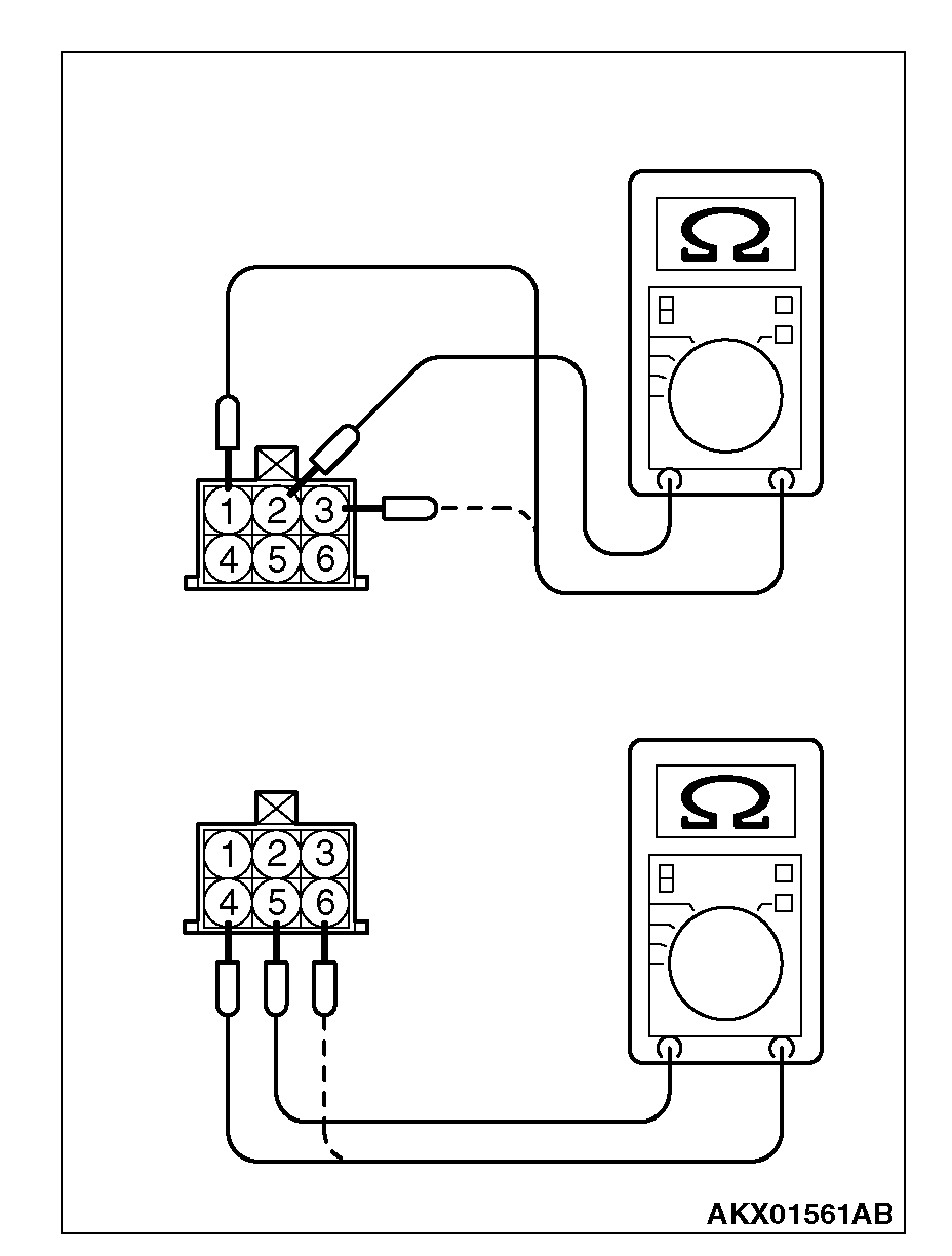

Checking the Coil Resistance
1. Disconnect the idle air control motor connector.
2. Measure resistance between terminal No. 2 and either terminal No. 1 or terminal No. 3 of the connector at the idle air control motor side.
Standard value: 28 - 33 Ohms [at 20 °C (68 °F)]
3. If resistance is not within the standard value, replace the IAC motor.
4. Measure the resistance between terminal No. 5 and either terminal No. 6 or terminal No. 4 of the connector at the idle air control motor side.
5. If resistance is not within the standard value, replace the IAC motor.
1. Remove the throttle body.
2. Remove the idle air control motor.
3. Connect special tool MB991709 to the idle air control motor connector.
4. Connect the positive (+) terminal of a power supply (approximately 6 volts) to terminal No. 2 and the terminal No. 5.
5. Connect the negative (-) terminal of the power supply to each clip as described in the following steps. Then check whether or not the stepper motor vibrates slightly as it operates.
1). Connect the negative terminal of the power supply to terminal No. 1 and terminal No. 4.
2). Connect the negative terminal of the power supply to terminal No. 3 and terminal No. 4.
3). Connect the negative terminal of the power supply to terminal No. 3 and terminal No. 6.
4). Connect the negative terminal of the power supply to terminal No. 1 and terminal No. 6.
5). Connect the negative terminal of the power supply to terminal No. 1 and terminal No. 4.
6). Repeat the tests in sequence from (5) to (1) to test opposite movement of the IAC.
6.
If vibration is detected during the test, the stepper motor can be considered to be normal.
