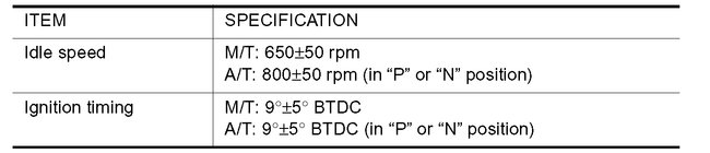

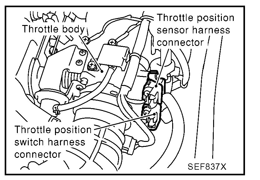

The first thing I think of when you say it stalls with the AC on is the idle air control valve (IAC). The iac is designed to maintain engine idle speed. There is a idle air volume relearn I want you to try. Normally it is done with a computer, but I was able to find a procedure to do it without. Try this.
Without CONSULT-II
1. Turn ignition switch "ON" and wait at least 1 second.
2. Turn ignition switch "OFF" and wait at least 10 seconds.
3. Start engine and warm it up to normal operating temperature.
4. Check that all items listed under the topic "PRE-CONDITIONING" , are in good order.
5. Turn ignition switch "OFF" and wait at least 10 seconds.
6. Start the engine and let it idle for at least 30 seconds.
7. Disconnect throttle position sensor harness connector (brown), then reconnect it within 5 seconds.
8. Wait 20 seconds.
9. Make sure that idle speed is within specifications. If not, the result will be incomplete. In this case, find the cause of the problem by referring to the NOTE below.
10. Rev up the engine two or three times. Make sure that idle speed and ignition timing are within specifications.

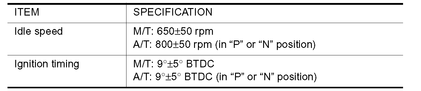

What is the pre condition list is looks like u were sending me links but they didn't come through so I could open them
Jul 25, 2019 at 12:30 PM
  • 110,194 POSTS
Welcome back:
I am so sorry. I forgot to add the pics. Pic 1 and 2 follow the same order as above. As far as the pre conditioning, here is the list.
PRE-CONDITIONING
Before performing "Idle Air Volume Learning", make sure that all of the following conditions are satisfied. Learning will be cancelled if any of the following conditions are missed for even a moment.
- Battery voltage: More than 12.9 V (At idle)
- Engine coolant temperature: 70 - 95 °C (158 - 203 °F)
- PNP switch: ON
- Electric load switch: OFF
(Air conditioner, headlamp, rear window defogger)
Let me know if that helps.

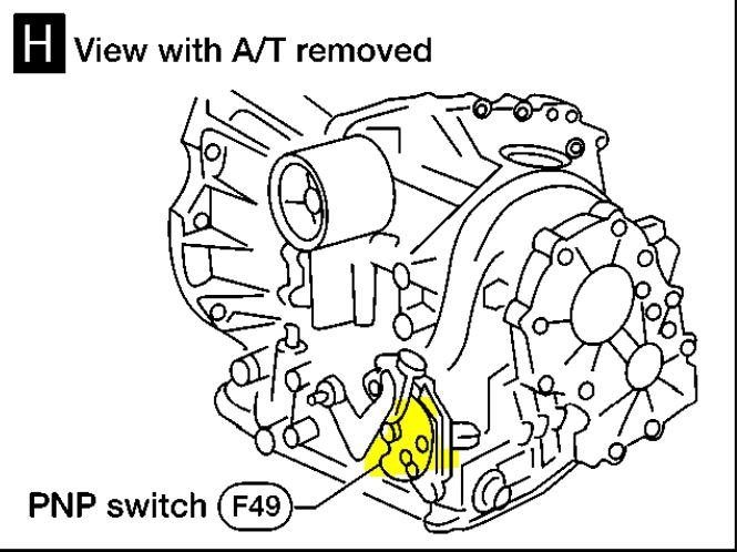

What and where is the PNP switch
Jul 26, 2019 at 4:27 AM
  • 110,194 POSTS
Welcome back:
See the attached pic.

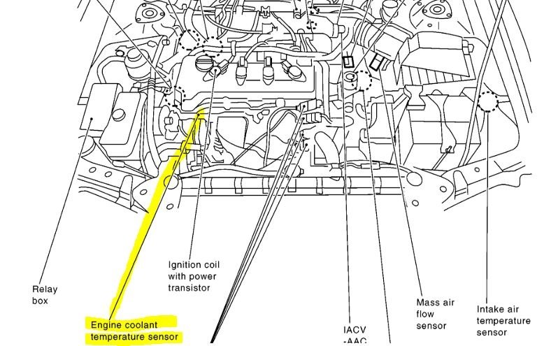

Okay, so today my call stalled when I turned into a parking lot. I had to turn it over about 6 times before it started. now it has the check engine light is on with code p0118.
Jul 27, 2019 at 3:24 PM
  • 110,194 POSTS
Welcome back:

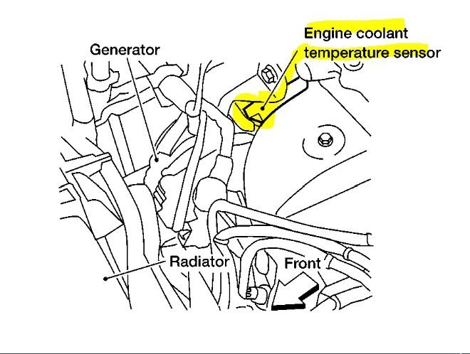

That code is related to the engine coolant temp sensor (ECT). What makes this interesting is the idea that based on the sensor's signal, the computer determines how rich or lean to make the fuel mixture. It could cause it to stall and not want to start if it is too rich or lean. Now, if you have access to a live data scanner (I assume you have a scanner because you provided the code) I want you to go to live data and check the signal from the ECT. It should indicate the correct engine coolant temperature. If it is way off, replace the sensor.
I attached 2 pictures below. The first shows ECT location in general. The second is more pinpointed.

It said my coolant temperature is - 40 I know that's not right it is 110 outside.
Jul 28, 2019 at 4:13 PM
  • 110,194 POSTS
Welcome back:
That's the problem. It's causing the computer to dump fuel to the engine so it can run in that temperature. I have a strong feeling that when the sensor is replaced, the problem will be gone. Lets just hope that the extremely rich fuel mixture didn't damage the catalytic converter.
