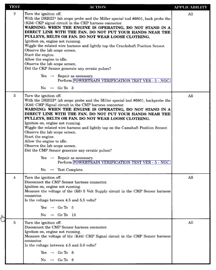

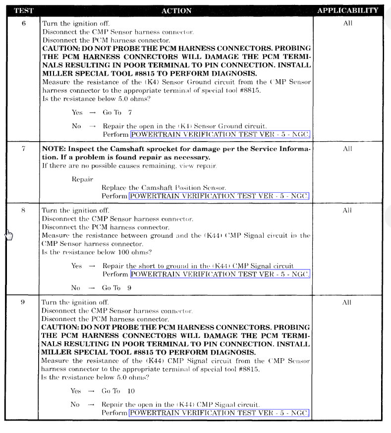

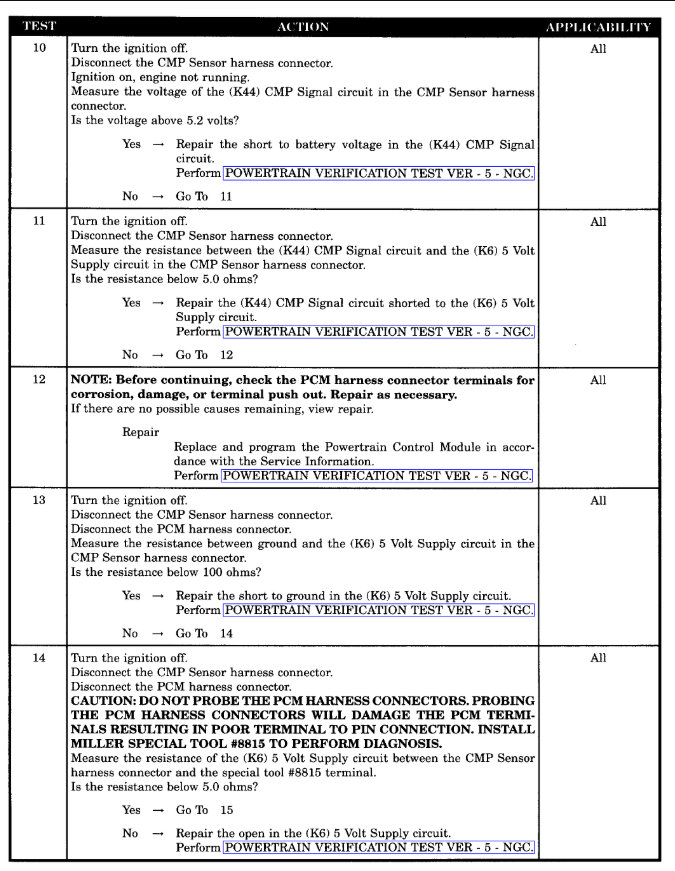

I changed both crankshaft sensor and camshaft sensor. I put new plugs in and there was spark at the plug when laid on the valve cover attached to the coil pack.
Saturday, February 15th, 2020 AT 4:59 PM
LONNIEB
  • 9 POSTS
Also the OBD reader keep showing a camshaft sensor code.
Saturday, February 15th, 2020 AT 5:05 PM
Okay. That is good additional info. Which was the actual code and is it still active? Thanks
Saturday, February 15th, 2020 AT 5:11 PM
LONNIEB
  • 9 POSTS
P0340 it’s not currently active.
Saturday, February 15th, 2020 AT 5:13 PM
Okay. If the code is not currently active, what is the vehicle doing? Did it cut off on the highway as you stated and then it hasn't restarted? Does it just crank and not start?

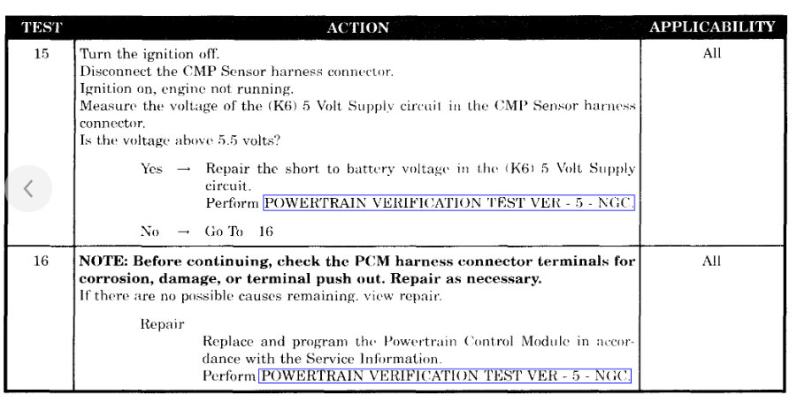

Could it be something with the ECM?
Sunday, February 16th, 2020 AT 6:18 AM
LONNIEB
  • 9 POSTS

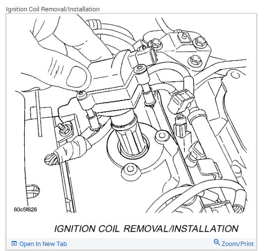

Would just one bad ignition coil cause this issue?
Sunday, February 16th, 2020 AT 11:08 AM
It could be the ECM. However, we need to run through this test and see what it brings us too. I understand that you replaced the CMP and CKP but we could still have a wiring issue.
But first if you have spark on the plug and the plugs are wet we can assume they are firing and the injectors are firing.
When is the last time you changed the plugs? If you were cranking the engine for this issue and the plugs were getting soaked with fuel, they will not fire "enough" to start the engine. Before we go any further, I would change out the plugs just to be sure.
It wouldn't hurt to verify compression on all the cylinders while you are changing the plugs. I doubt this is the issue but clearly we should confirm the compression is good.
To answer your question, one coil would not cause a no start as they are called coil on plug meaning it only fires one plug. If one was bad, you would have a misfire on just that cylinder.

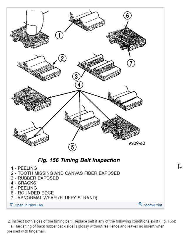

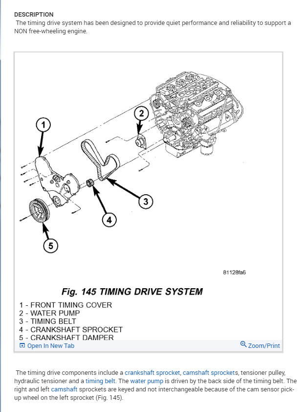

One other thing I thought of; is it possible that timing would be out of spec?
Monday, February 17th, 2020 AT 7:30 AM
It could be the timing. This is part of testing the timing. If the compression readings are low we will need to inspect the timing but it should effect all cylinders if that is the case because you have a single timing belt.
