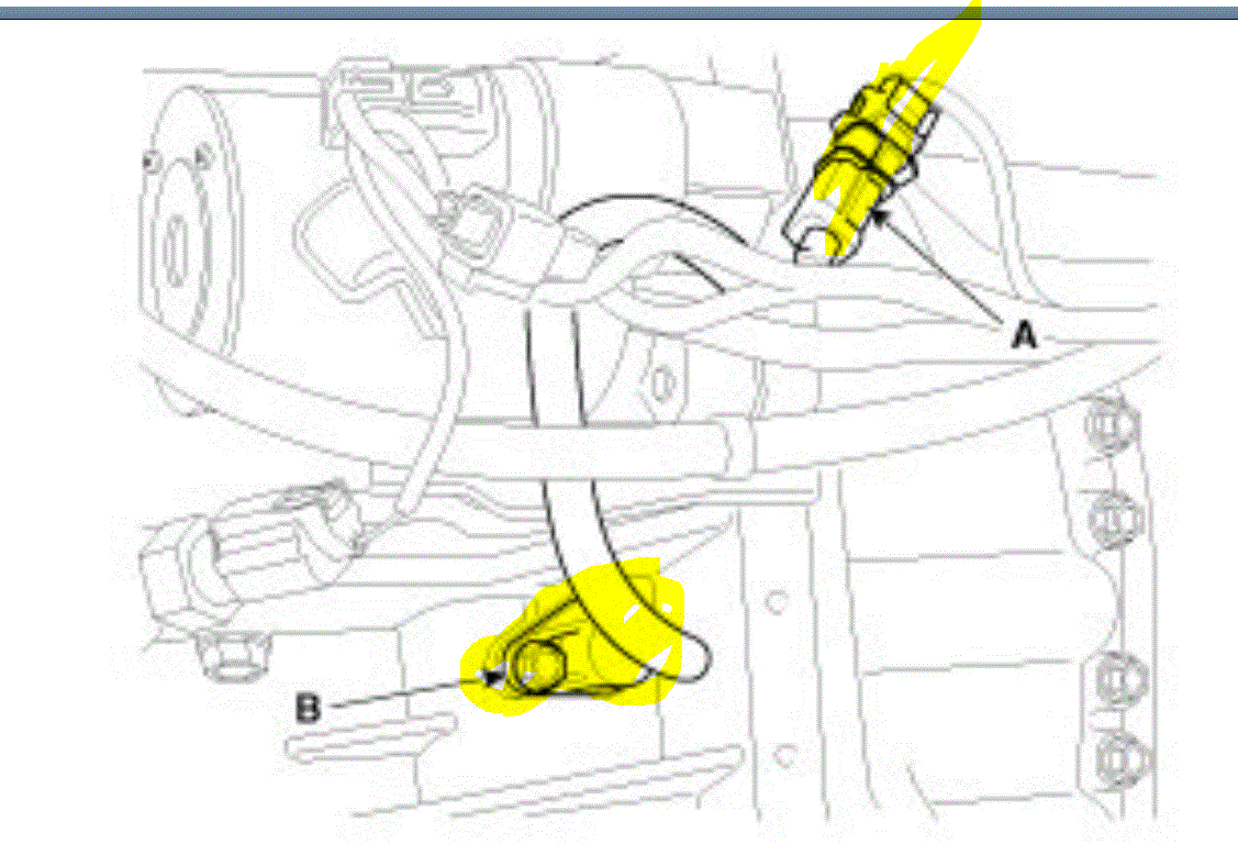

  • 110,251 POSTS
If there is no spark, do me a favor. If you have a live data scan tool, see if there is an RPM signal. If there isn't, chances are the crank sensor is bad.
I attached a pic of the sensor, make sure nothing is damaged or disconnected.

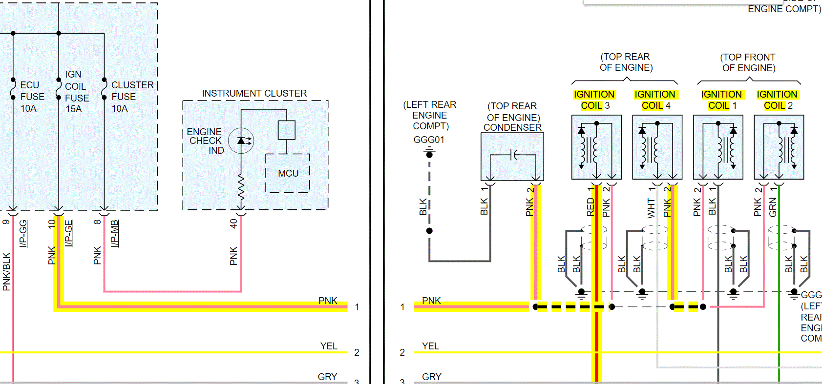

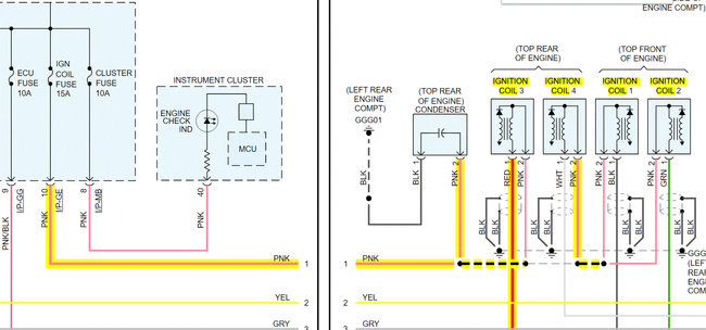

  • 110,251 POSTS
It sounds like we simply have a short. See the attached pic. It shows how the fuse you are referring to powers the coils. So, if it blows right away, disconnect the coils and see if the fuse still blows. If it does, the short is between the fuse and the coils. If it doesn't blow, plug one in at a time to see which one blows the fuse.
Let me know what you find.
