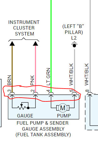

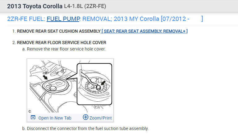

I was driving my car on the highway going 80 MPH and the car shut off and jerked a couple of times. I assume it was because it was trying to turn itself back on because it eventually did when I was pulling to the shoulder. Nothing happened while stopped at the shoulder. I got off at an exit and at the exit it also turned off. But it turned itself back on after about a second. Pulled into a parking lot and it shut off completely going inside. Tried to turn it on and it was just cranking. Tried like two more times and on the third it turned on. I drove it home for about 20 minutes and it did not shut off. I’ve seen that it could be several issues. Any idea as to where I can get started or things I could check for. Please and thank you. From what I have seen, it may be fuel related. No check engine light. Something that I noted that has never happened was the gas gauge was off. When it first turned off in the highway it read below the full line. Once at the parking lot it marked 3/4. Now that I drove it home it went back to or near the original mark.

Based on your info, it does sound like a wiring/connector issue. The fuel level float is in the fuel tank along with the fuel pump. The only thing to say at this point is you could inspect the connector and wiring. Actually, it may be a good idea.
To access the top of the fuel pump, there is a service location under the rear seat. If you remove the rear seat, you will see it. Remove the cover and you will see the top of the fuel pump assembly. Don't disconnect anything. Instead, turn the key on so the fuel gauge is working and wiggle the wiring at the connector to see if the gauge changes.
I attached a pic below showing the location.
See pic below.

Will try that out. Is the fuel gauge connector also wiring for other things? That one connector can cause the issue for the car to shut off while driving?
Jan 21, 2024 at 4:48 AM
  • 110,248 POSTS
If you lose connection, yes, the pump will stop, and the car will stall. The one connector should have 4 wires in it. Two are for the fuel level gauge and the other two are for the fuel pump. See pic below.
