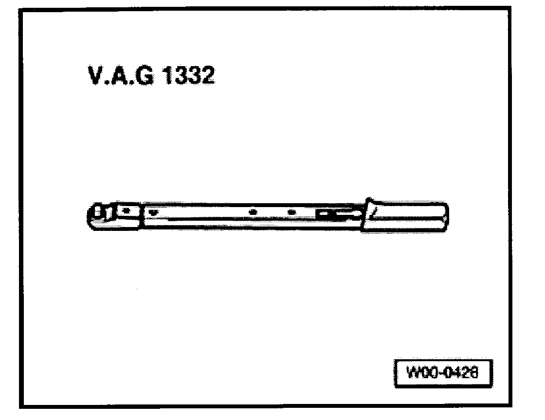

Special tools, testers, measuring instruments and auxiliary items required
pic 1

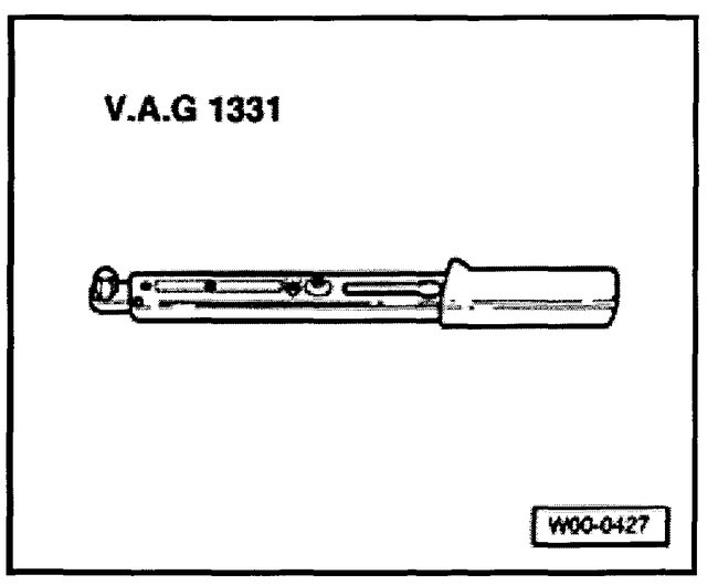

- VAG 1331 Torque wrench (or equivalent 5 - 50 N.m)
pic 2

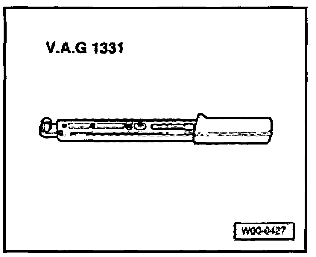

- VAG 1332 Torque wrench (or equivalent 40 - 200 Nm)

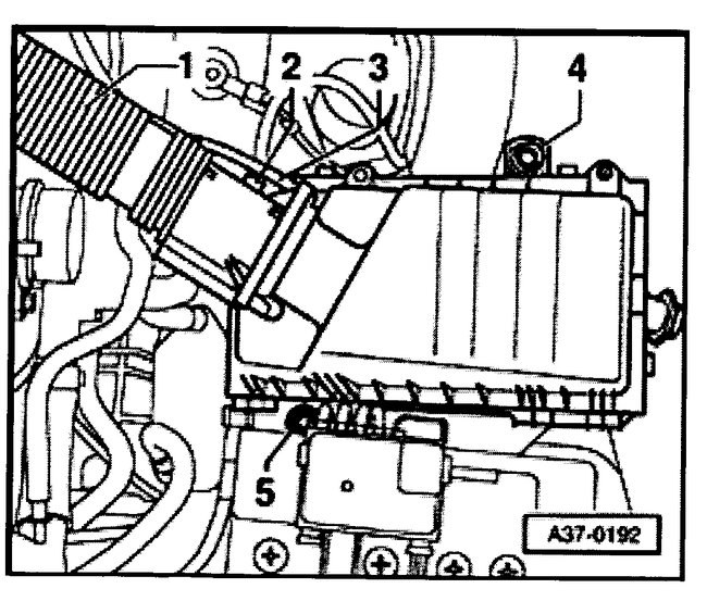

- Remove intake hose -1-, electrical connection -2- and hose -3- from Mass Air Flow (MAF) Sensor
- Remove screws -4- and -5- and remove complete air filter assembly.

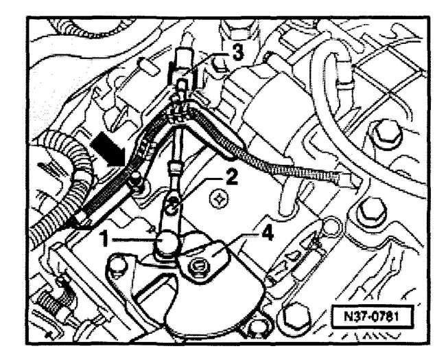

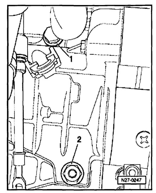

- Remove bracket -arrow- from transmission.
- Ensure transmission selector is in "Park" and lever shifter cable end -1- from shifter lever -4- using screwdriver.
- Unclip shifter cable from holder -3- lift out shifter cable and set aside.
CAUTION!
- Do not remove screw -2-.
- Do not kink shifter cable

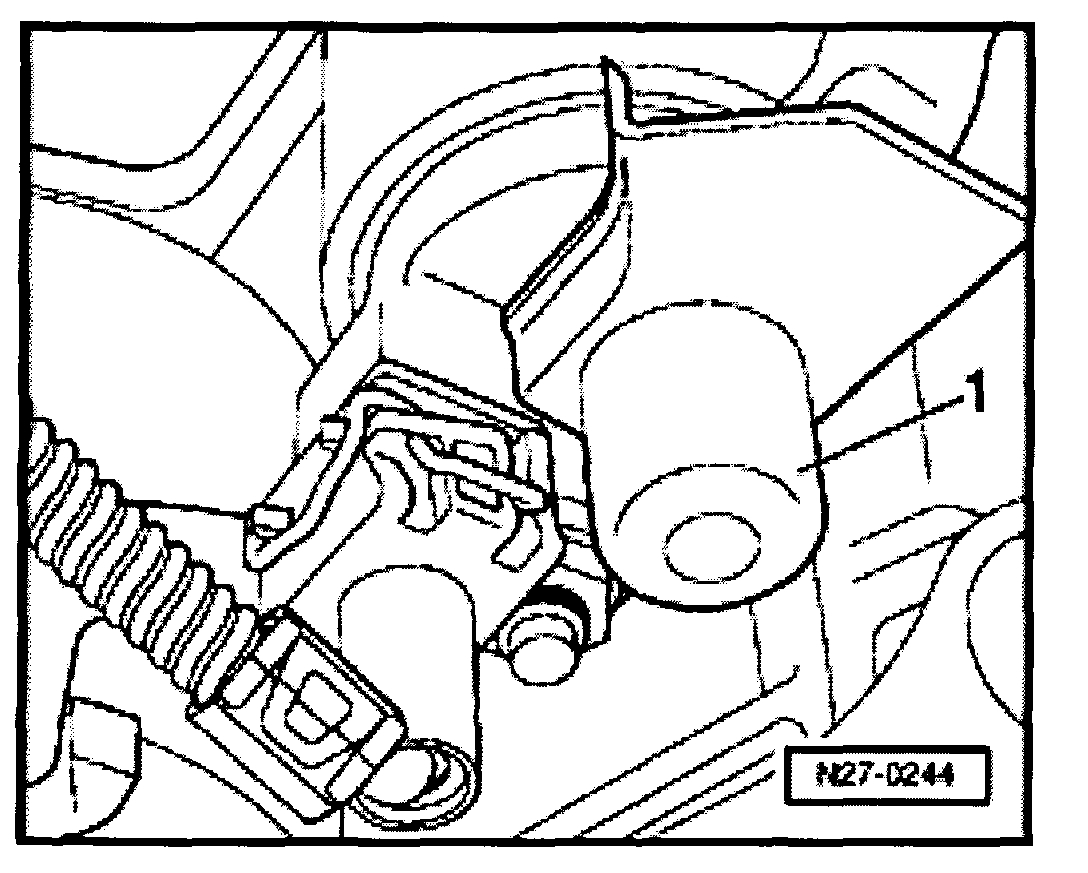

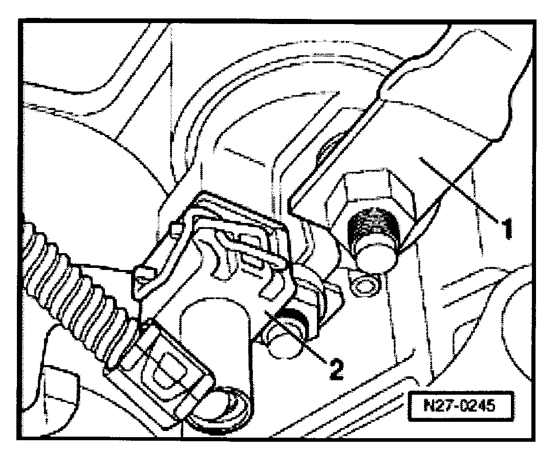

- Pull off plastic cap -1- from solenoid.
pic 6
- Remove nut (13 Nm) at solenoid terminal 30 and remove cable -1-.
- Disconnect electrical connection at starter terminal 50 -2-.
