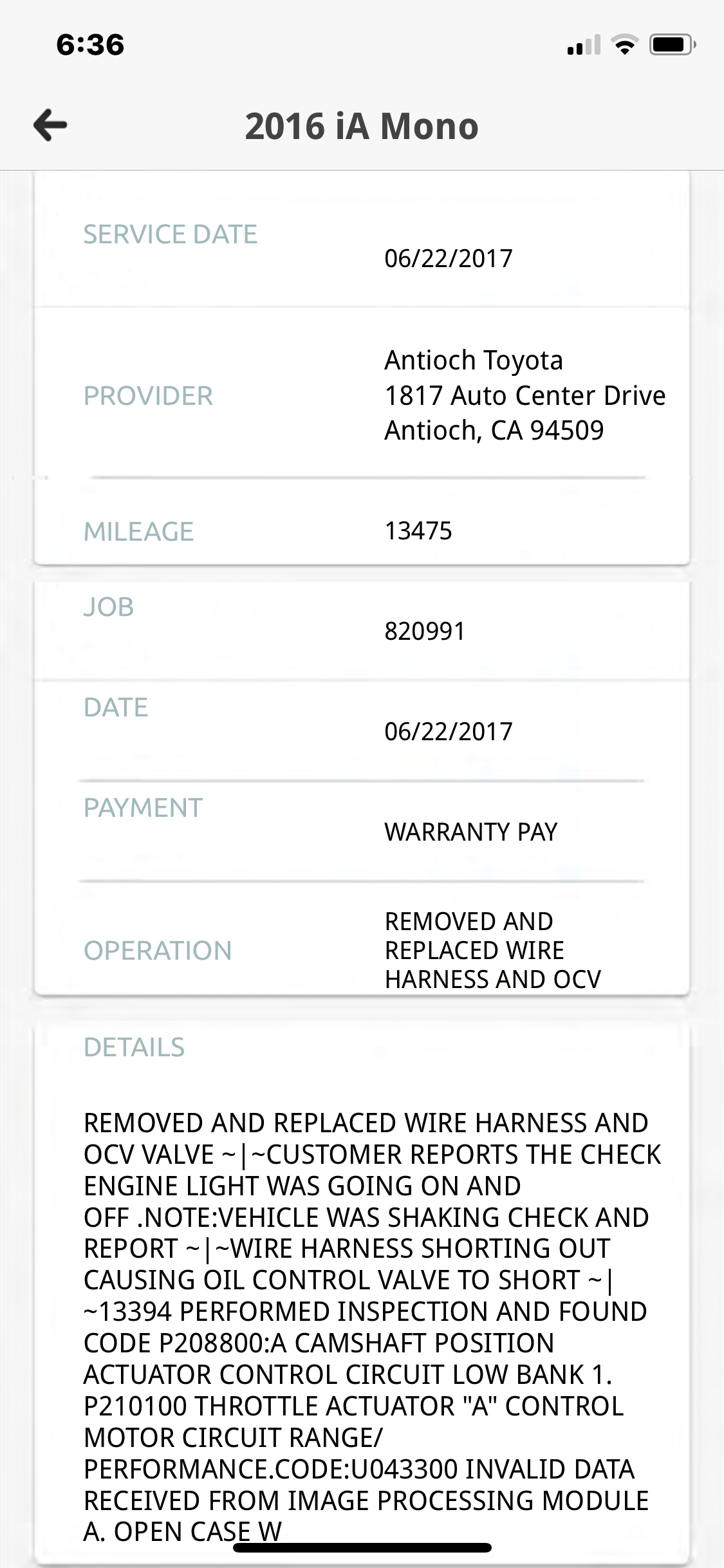

I have a 2016 scion iA. I bought it as a lemon car. It started to give me issues before I even drove it for 2,000 miles. It has been in the shop for more than four times for this issue, once for several months. When purchased I was told of the issue that the car had (yeah... shaking), but that it was fixed and was also under warranty and that all parts were replaced with original parts and the issue would not come back. Long story short, I contacted Toyota financial and took the car to the Toyota dealer, I was told that there was no problem with the car but Toyota financial wanted the mechanics to perform some tests. I was then contacted and told that there was excessive carbon build up in the engine but that this was not related to the shaking, past issue. I do want to return the vehicle because at this point I have had it with taking the car to the shop. Question here is, is it normal for a car to get excessive carbon build up? Is it related to the shaking of the car? Previous code cas p210100? Also, I purchased the car in 2017 with 11,680 miles, now it has 25,503.

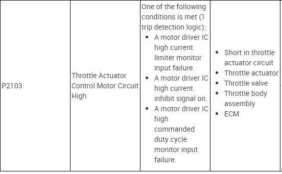

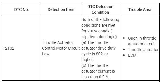

Ugh. It sounds like you have a headache to deal with. First, any engine that burns fuel, will create carbon. However, at such low mileage, it is uncommon. I need you to double check the trouble code. It will be a P followed by 4 numbers. P2101 does not exist, but P2102 and P2103 do and both deal with the electronic throttle control. I attached a two pictures that discusses each code and what it is related to. Take a look.
As far as the lemon law, I believe the dealer has three attempts to repair a problem that is potentially dangerous. In this case, the car stalling or not accelerating is dangerous.
See if you can find the code. Also, if you have the car and can drive it, take it to a parts store and have them scan the computer to see if there are any additional codes stored. Let me know the results. If you have access to a scanner, here is a quick video that shows hot to use one.

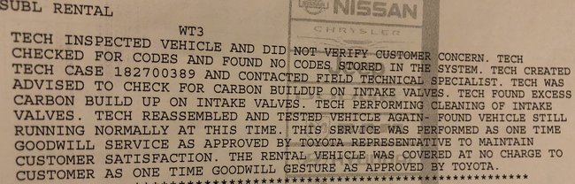

This is a picture of the notes from the techs at Toyota. This was from the first time that I took it to the dealer for service.
It is still being worked on since wed 9/26/18. The engine is being pulled apart and it is being cleaned for the build up. The Toyota tech told me that the carbon build up had nothing to do with the car shaking but I do not believe that and since I did contact Toyota Financial I do want to provide as much information about how this is related so I can have Toyota buyback the car.

Hi again. I would be liar if I told you I understood why the engine has to come apart for carbon issues. There are products that clean carbon from the fuel and intake system, including engine valves, and the tops of pistons.that don't require taking the engine apart. However, if carbon or dirt gets into a fuel injector, it will cause a misfire which will result in the check engine light flashing and the car shaking.
Did they tell you why the engine had to be taken apart other than a carbon issue?
By the way, the codes they provided are correct, but only the first 4 numbers after the P. No idea why they extended them.

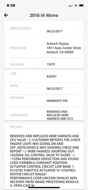

Not sure if you can read that but that is what the notes were on the most recent visit. My brother is the register owner and he talked to Toyota Financial and told them that he did not want the car since it us unreliable and it is ridiculous how many times it has gone in for service. So we are just waiting for a response. I love my car but honestly I need a car that I can actually depend on. Thanks for all your help.

He cleaned the intake valves. I am not sure why he would have taken it apart to do it or how he knew the "Intake Valves" were carboned unless he used a camera.
