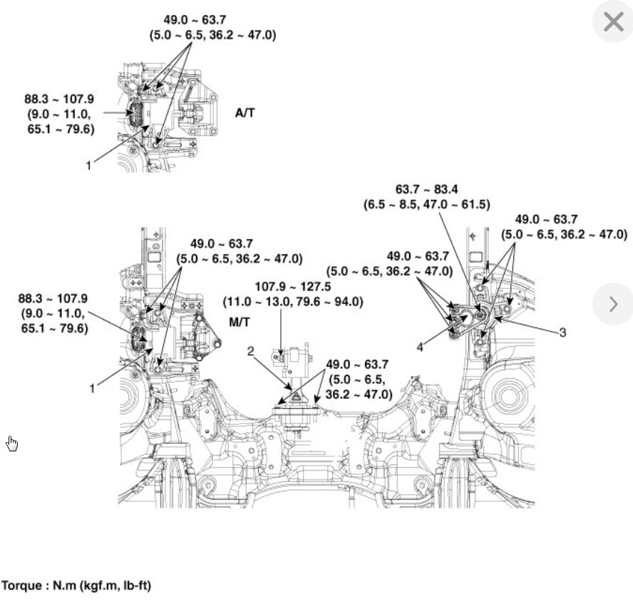

Can anyone tell me why this is? This car was bought used from car dealership about 4 years ago.
Nov 24, 2019 at 8:41 PM
Normally this type of issue is normally caused by mounts that are wearing out or worn out already. We need to inspect them and look for cracking and any that may have metal to metal.
Another way to check is lift the hood and have someone put the engine into drive and then back to park. See if the engine has a large amount of movement. If so this is a sign of worn mounts.
Nov 25, 2019 at 9:45 AM
BETTY CHAPMAN
Hello, I had some look at the engine when I put it in park and drive. When I switch gears the engine moves up and down. Is this normal? Can I still drive the car out of town for holidays? Or is that taking a risk?
Nov 25, 2019 at 9:17 PM
It is going to have some movement but if it is clunking and moving up and down just by changing the gears then I would suspect the mounts are failed.
