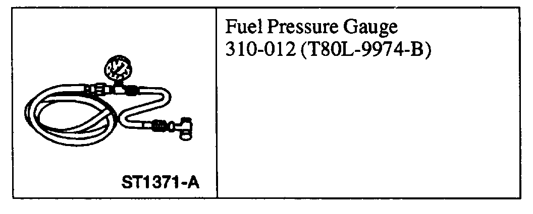

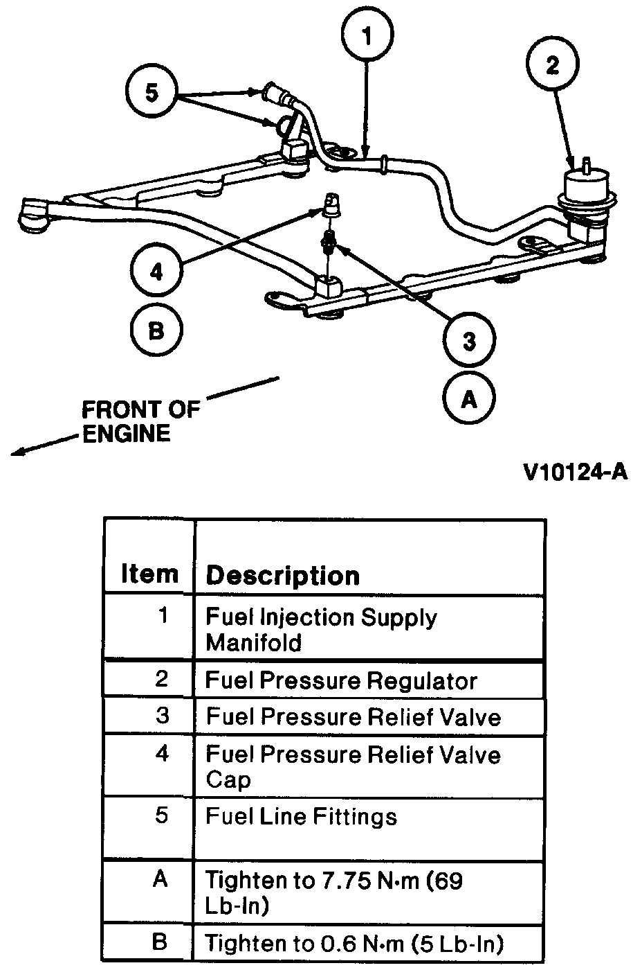

Since you have already replaced many ignition components, I would start with the fuel pressure. Here is a link that shows how to check pressure:
Here are the directions specific to your vehicle with pressure specifications. The two attached pics correlate with the directions.

Fuel Pressure Gauge
pic 1
SPECIAL TOOL(S) REQUIRED
Pic 2
REMOVAL
1. If fuel injection supply manifold is mounted to engine, remove fuel tank filler cap. Then release pressure from system at fuel pressure relief valve on fuel injection supply manifold using multiport fuel injection Fuel Pressure Gauge 310-012 (T80L-9974-B).
NOTE: Fuel pressure relief valve cap on fuel pressure relief valve must be removed.
2. Using an open-end wrench or suitable deep well socket, remove fuel pressure relief valve.
INSTALLATION
1. Install fuel pressure relief valve. Tighten fuel pressure relief valve to 7.75 Nm (68 lb-in).
2. Perform post-service procedures. See: Fuel Pressure Release > Procedures
3. Install fuel pressure relief valve cap. Tighten fuel pressure relief valve cap to 0.6 Nm (5 lb-in).

If you don't have a fuel pressure gauge, again, most parts stores will lend or rent one to you.
