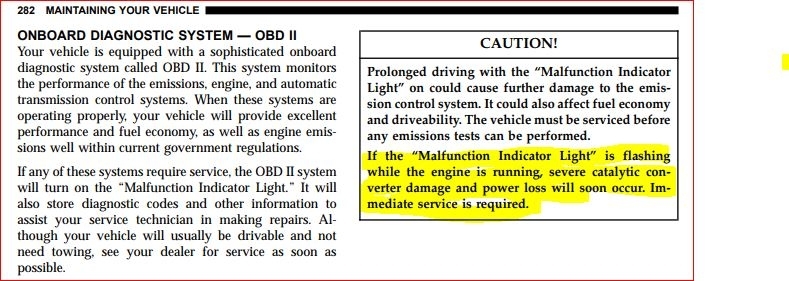

This sounds like a severe misfire or internal engine issues. If the check engine light is flashing, that means stop driving ASAP because you will do serious damage to the engine or exhaust system. If it is a misfire then you are probably not burning the fuel that is going into the engine which means it is going into the exhaust which will quickly damage it and require replacement.
If it is making noise now as well then I suspect something in the engine let go. We need to start with getting the codes out of the computer. With the light flashing, you will have some DTCs that will point us in the correct direction.
Here is the warning from the owners manual that talks about this.
Let me know if you can get the codes and then we can go from there.
