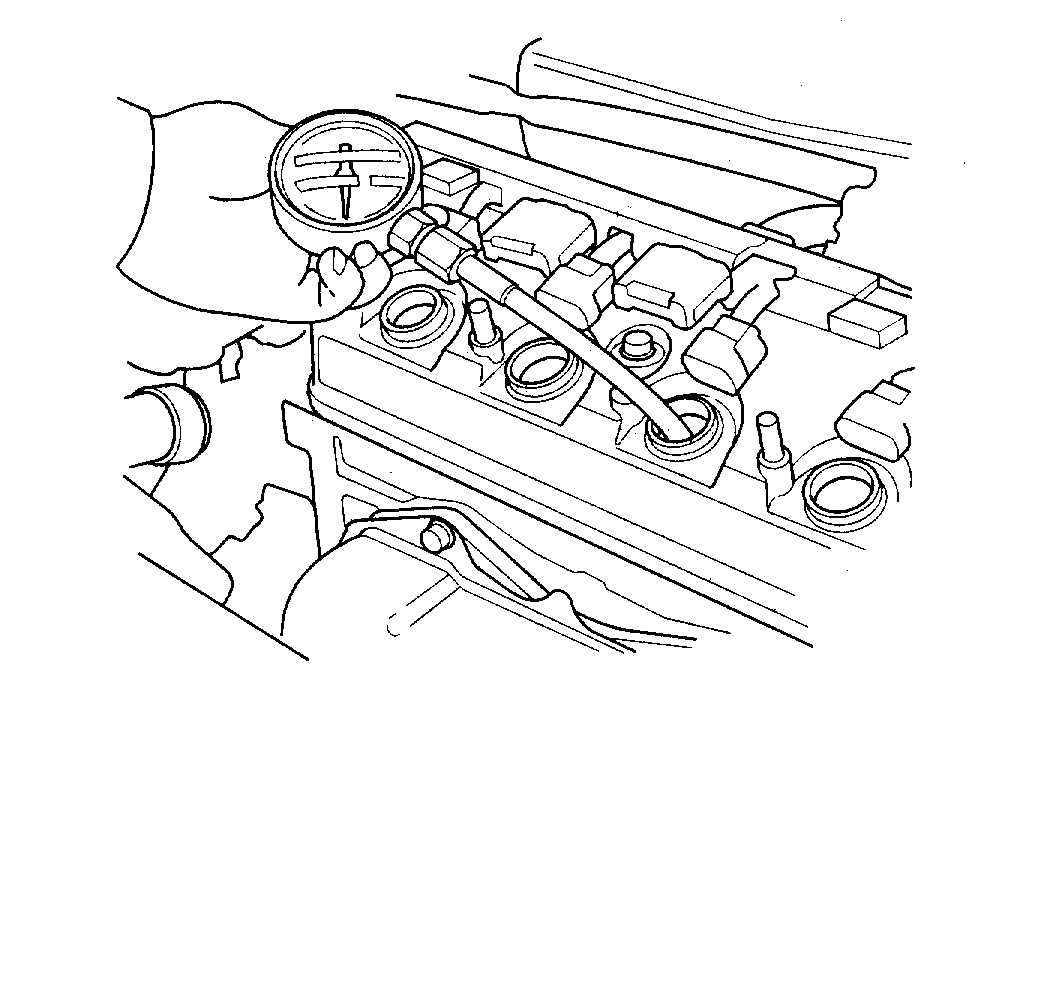

If there is a concern of a bent valve, the best thing to do would be simply perform a compression test on the engine. By doing that we can determine if there is an issue with any of the cylinders (specifically cylinder 2). However, before I would go to that extent, remove the spark plug from cylinder 2 and inspect it. Is it wet? What color is it? Is it getting spark? You could have a bad plug.
If the plug is getting spark, then do the compression test. Here is a link showing how it is done:
You will need a compression gauge, but most parts stores will lend you one.
Here are the directions specific to your vehicle including the manufacturer's specs. The attached pic correlates with these directions.

Engine Compression Inspection
1. Warm up the engine to normal operating temperature (cooling fan comes on).
2. Turn the ignition switch OFF.
3. Remove the air cleaner housing.
4. Disconnect all four injector connectors.
5. Remove the four ignition coils.
6. Remove the four spark plugs.
See Pic 1
7. Attach the compression gauge to the spark plug hole.
8. Connect a tachometer.
9. Open the throttle fully, then crank the engine with the starter motor and measure the compression.
Compression Pressure:
Above 930 kPa (9.5 kgf/cm2, 135 psi)
10. Measure the compression on the remaining cylinders.
Maximum variation:
Within 200 kPa (2.0 kgf/cm2, 28 psi)
11. If the compression is not within specifications, check the following items, then re-measure the compression.
^ Damaged or worn valves and seats
^ Damaged cylinder head gasket
^ Damaged or worn piston rings
^ Damaged or worn piston and cylinder bore
__________________________________________________________
Let me know if you decide to do it. If you have other questions, let me know.
