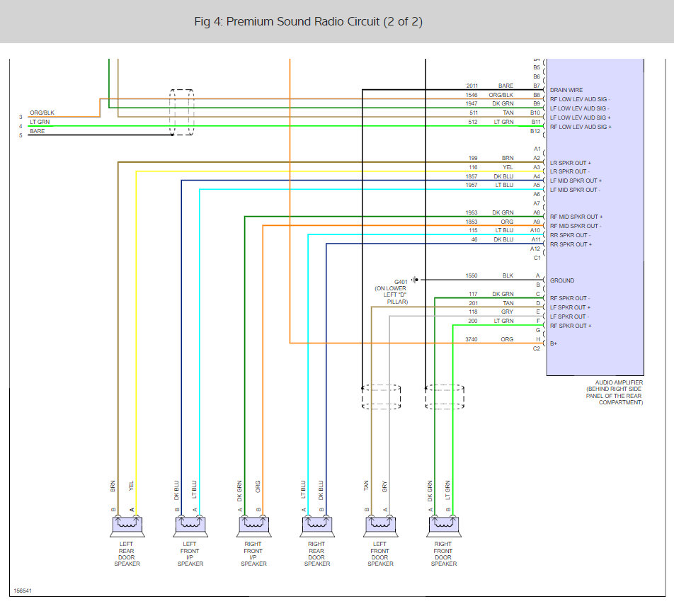

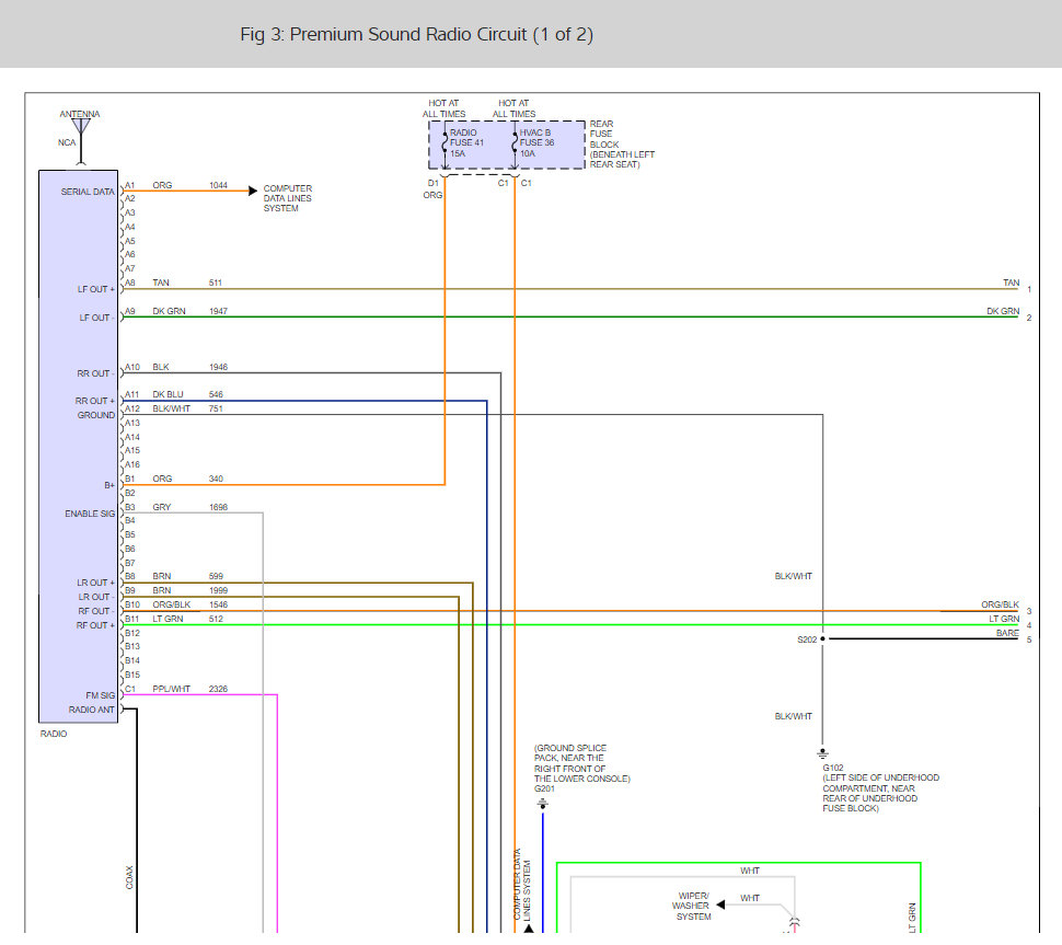

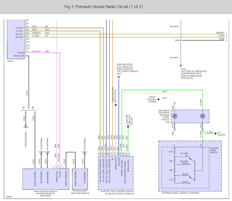

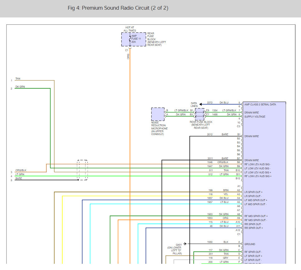

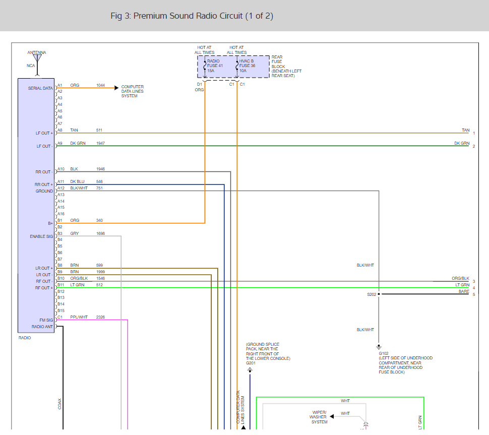

The amp needs to see the radio turn on so the amp does the same. Does the new radio have a blue wire for the antenna? This is what most people use to trigger the amp. Here is a wiring diagram so you can get it connected correctly:
