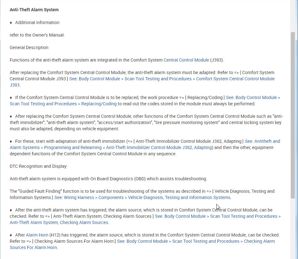

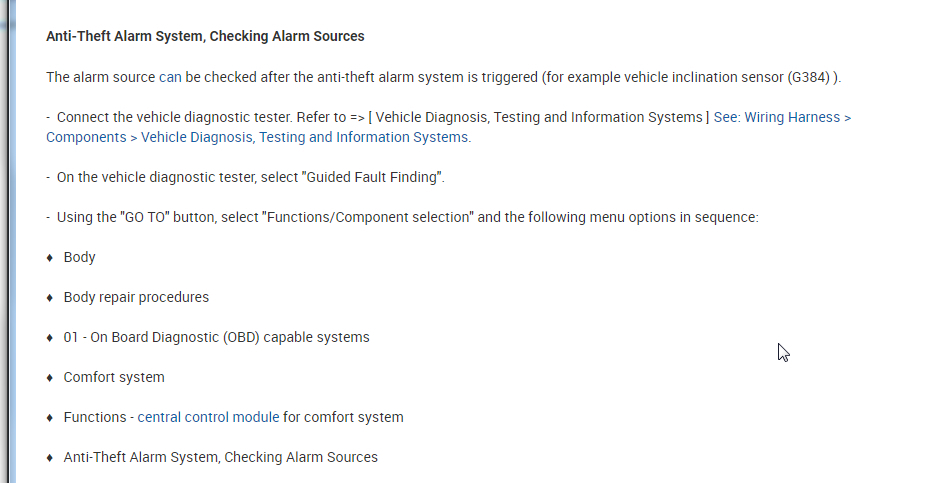

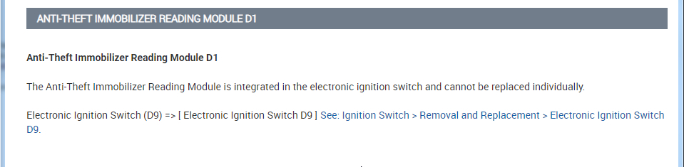

Lastly I attached below the info about this system. More then likely there is a code but either their scan tool cannot communicate with the BCM or Comfort control module where the code would be stored, or they did not select that module to check for codes.
Let us know what codes are there and about the security light and we can go from there.
