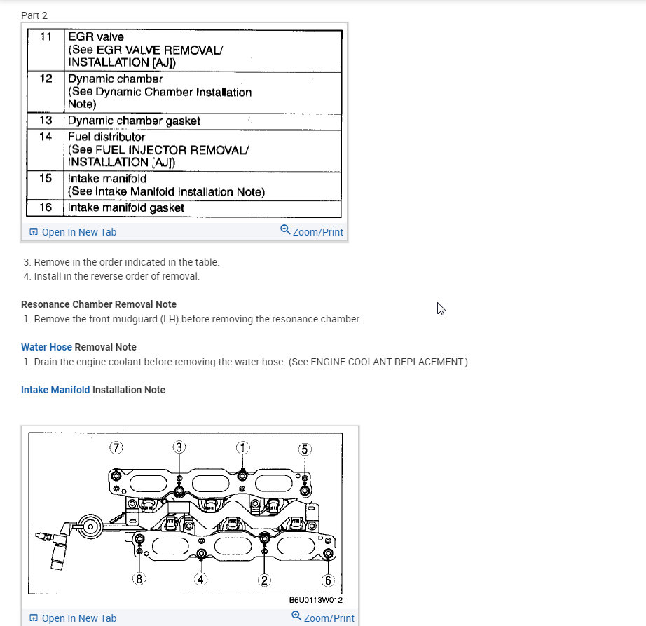

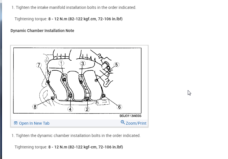

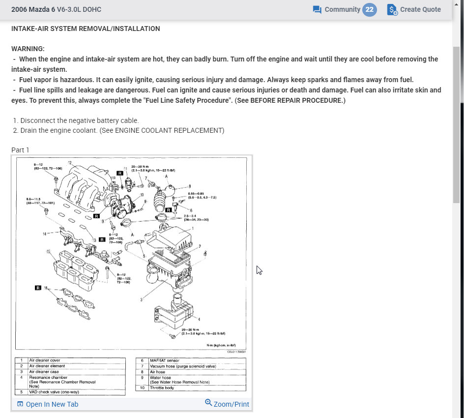

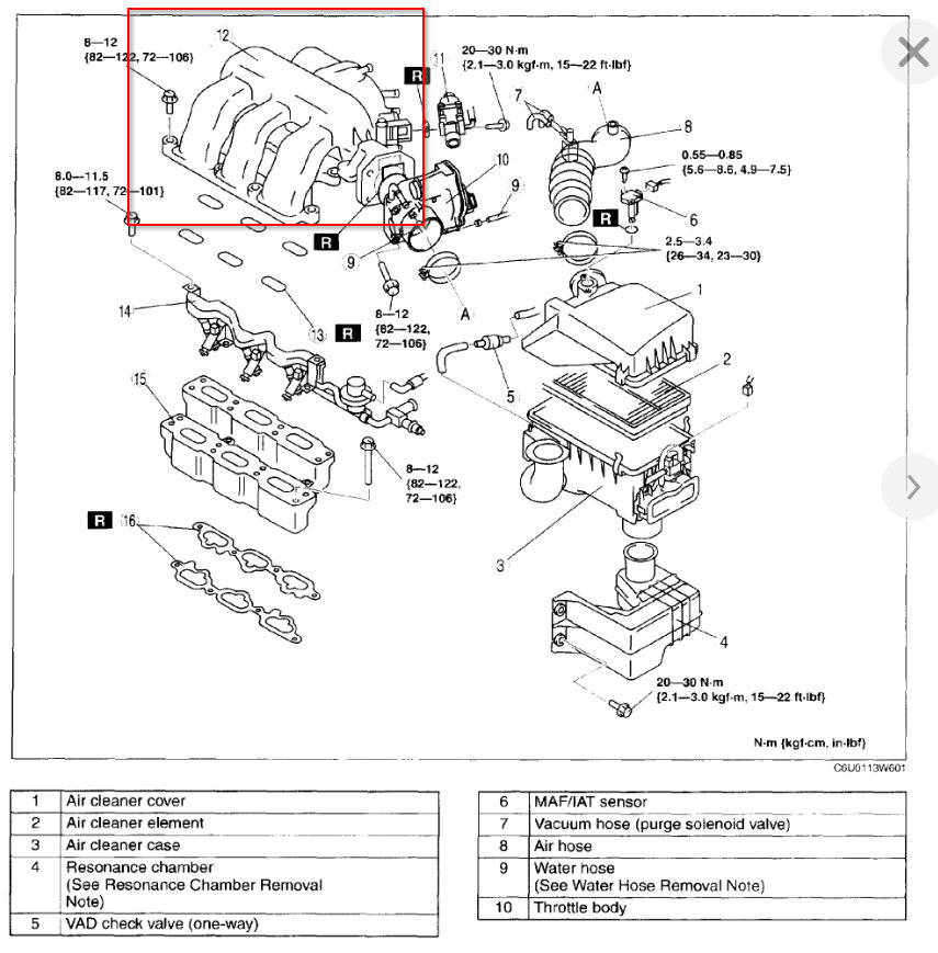

I am not sure how this would happen. I suspect we are not talking about the same part. I attached the info about the intake manifold.
Could it be the air cleaner box that you are talking about? If not, can you point out the part here or take a picture of it and that will get us on the same page. Thanks
Feb 3, 2020 at 3:19 PM
HITO
Thank you for your reply. Yes, the intake manifold as circled in red in one of your attachments.
Feb 4, 2020 at 12:41 PM
Is it possible to get a video of this running with the intake off? I think seeing what is on the vehicle and off the vehicle will help figure this out. I can't say I have ever tried to run the vehicle without that on. Clearly the intake manifold directs the air into the cylinders so we may have a restriction not allowing air into the engine. A video will help. Thanks
