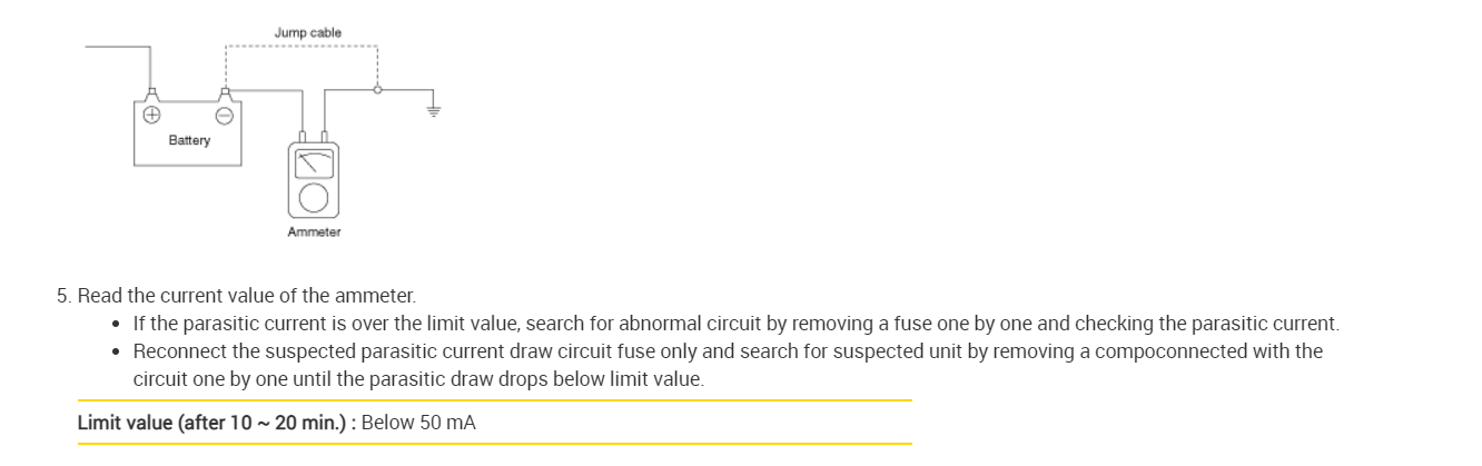

When the car was running did you have any warning lights on in the dash? I am wondering if the alternator is working correctly. Also, I would clean the connections at the battery.

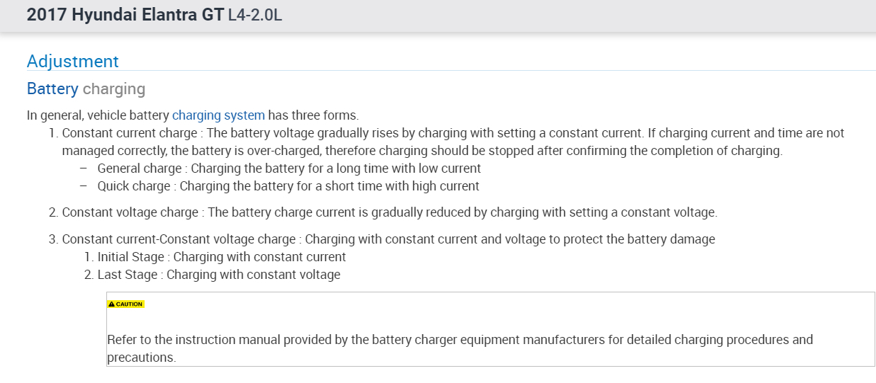

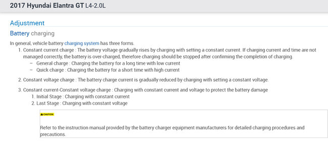

This guide can help:

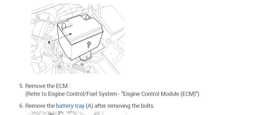

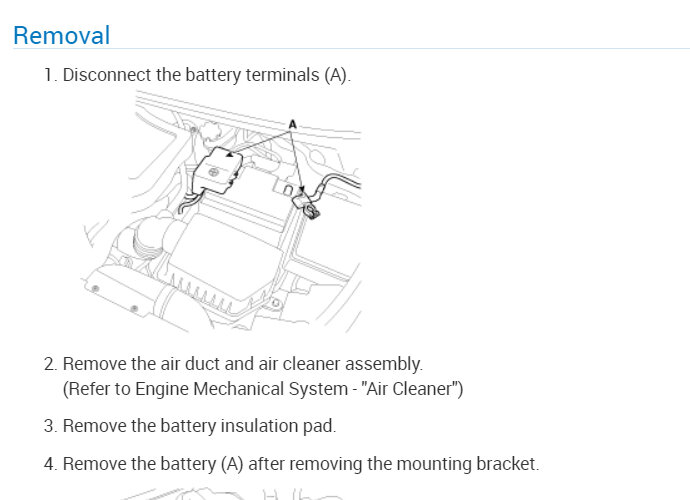

If the BCM is not shutting down, it will drain the battery as well, but I am wondering if the battery is still bad and just tested good as a false positive. Is the battery original? If so, I would replace it anyway because they don't last longer than 5 years. Here is a guide to help and instructions below for your car. On a side note, the radio and display will only work if there is at least 12 volts in the system. You can check this by using a voltmeter at the battery which should read around 12.4 volts.

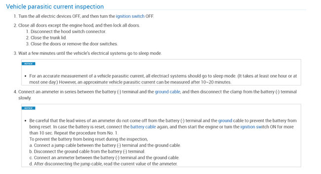

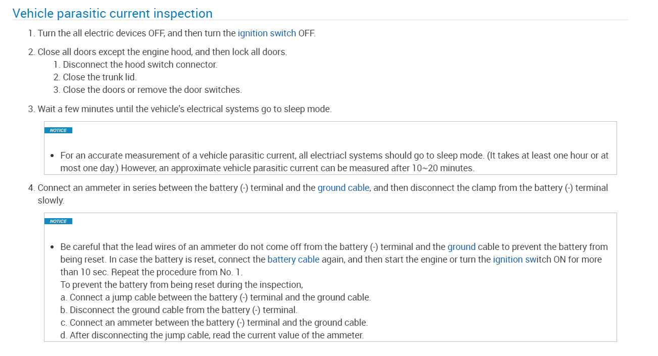

Here is a guide to help with that as well:
Please go over these guides and get back to me. I also included how to check the electrical system for draw to help confirm the battery is the problem.
